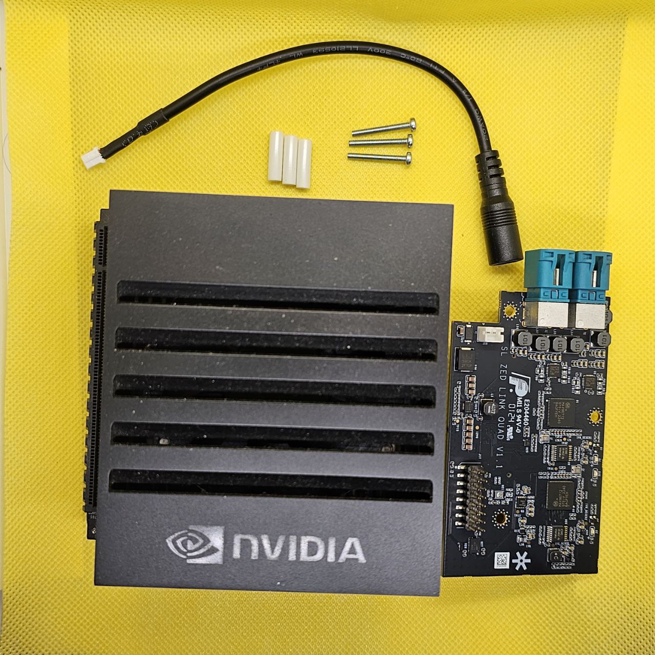

  • 1x NVIDIA® Jetson™ Xavier AGX Developer Kit.
  • 1x ZED Link Quad GMSL2 capture card
  • 2x 1-to-4 GMSL2 Fakra Male to Female cables (included in the box)

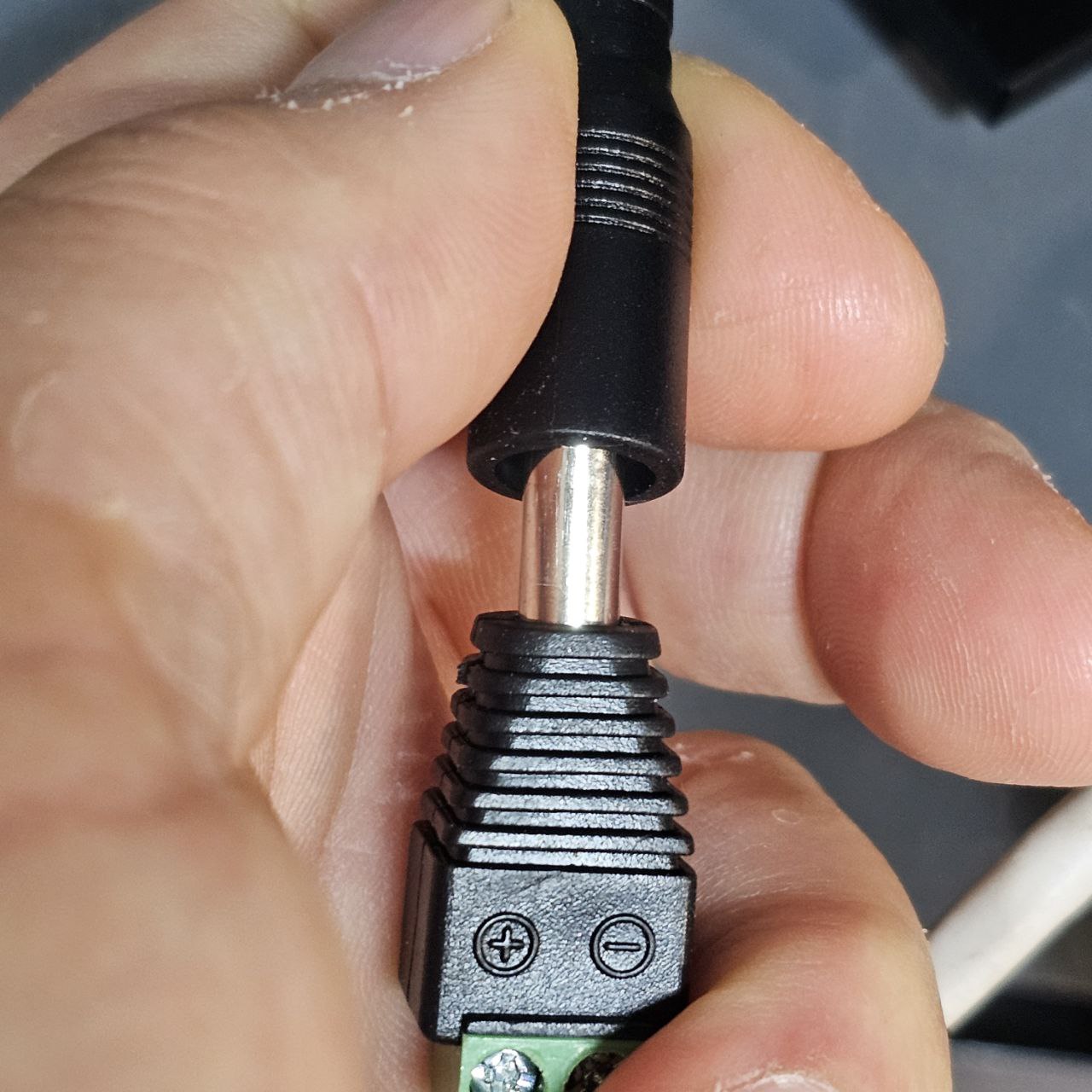

  • 9V-19V (min 6W) power input (Barrel Jack 5.5 mm outer diameter, 2.5 mm inner diameter) to power the GMSL2 capture card (not included)

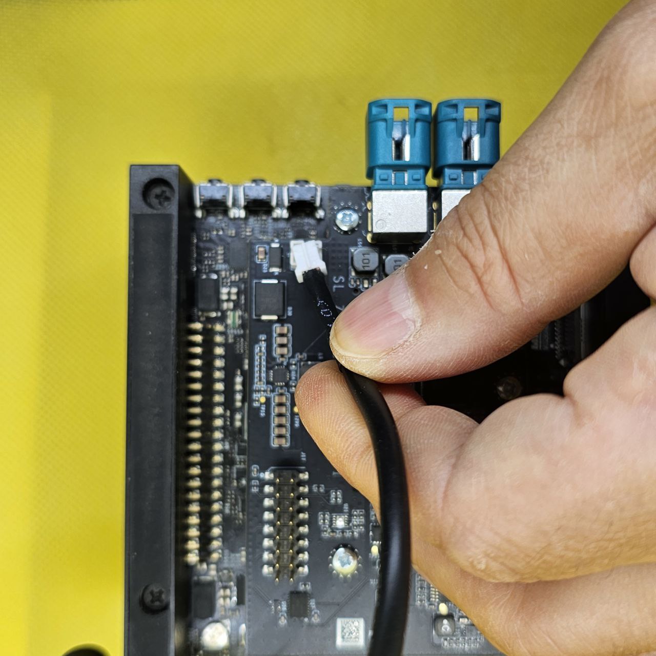

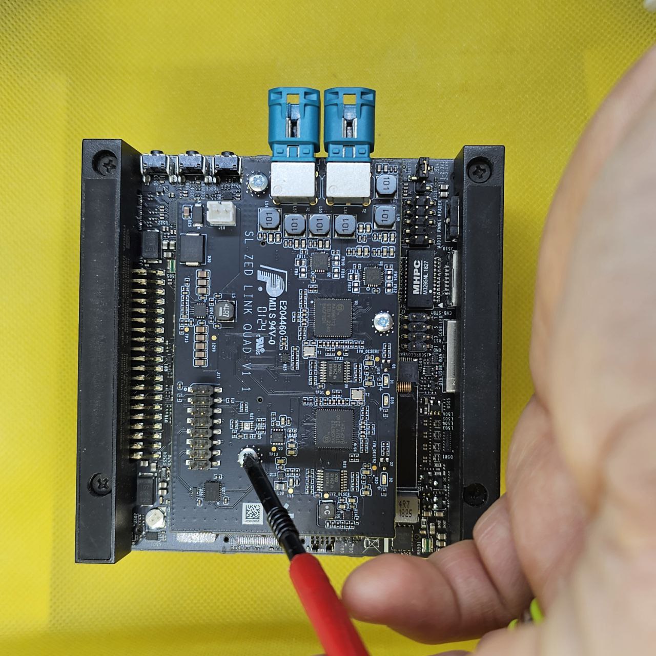

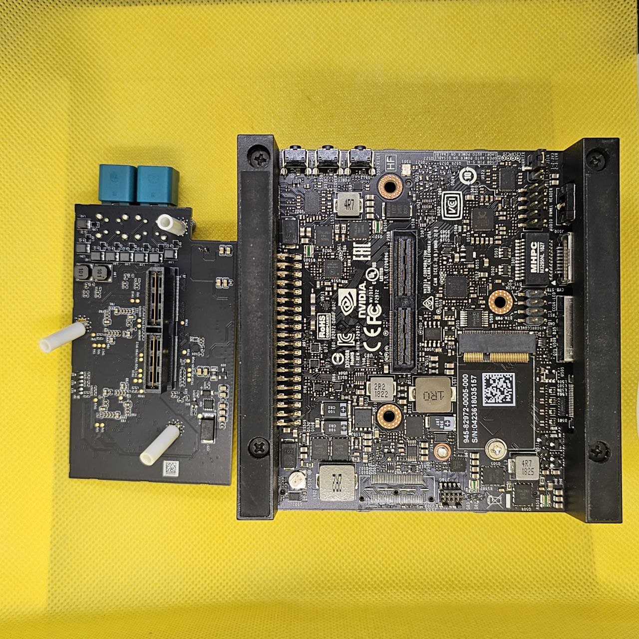

Plug the capture card into the ‘Camera connector’ slot and secure it using the three provided screws:

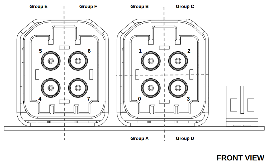

Multi-camera configurations
  • Group A: port #0
  • Group B: port #1
  • Group C: port #2
  • Group D: port #3
  • Group E: ports #4 and #5
  • Group F: ports #6 and #7
per Group
