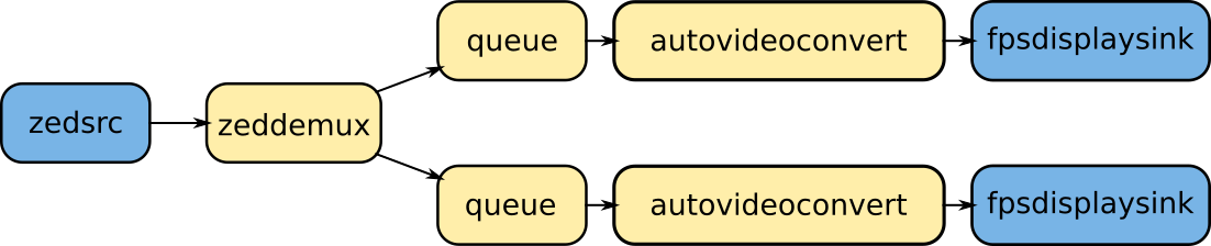

Split the stereo couple and display single streams
The following is a simple pipeline to display on the screen the Left and Right color streams in two different windows:
gst-launch-1.0 zedsrc stream-type=2 ! zeddemux is-depth=false is-mono=false name=demux \
demux.src_left ! queue ! autovideoconvert ! fpsdisplaysink \
demux.src_aux ! queue ! autovideoconvert ! fpsdisplaysink
Pipeline graph: zedsrc to zeddemux, whose src_left and src_aux pads each feed a queue, autovideoconvert and fpsdisplaysink
Split the RGB/Depth synchronized stream and display single streams
The same pipeline as the previous example can be used to display the left camera stream and the Depth stream in separate windows by selecting stream-type=4 on zedsrc and is-depth=true on zeddemux.
gst-launch-1.0 zedsrc stream-type=4 ! zeddemux is-depth=true name=demux \
is-depth=true is required whenever the composite stream carries depth on its lower half, i.e. with stream-type=4. The zedsrc element packs the depth values as 32-bit distances in millimeters, and zeddemux converts them to a GRAY16_LE depth map on src_aux only when is-depth is enabled. With the default is-depth=false, the lower half is forwarded untouched as BGRA and the resulting image is not a usable depth map.
