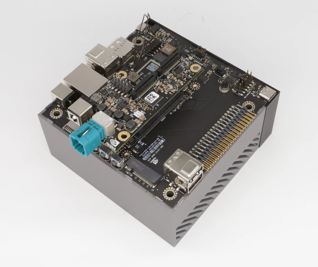

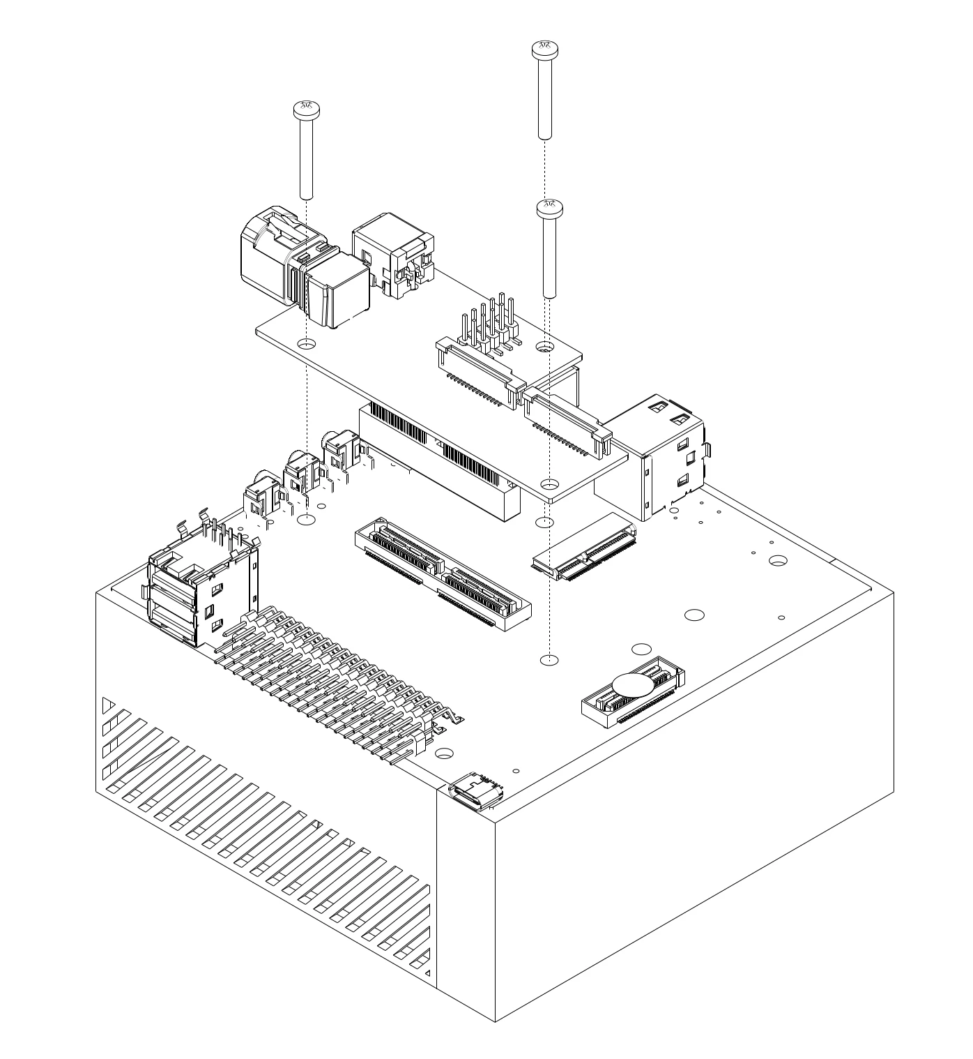

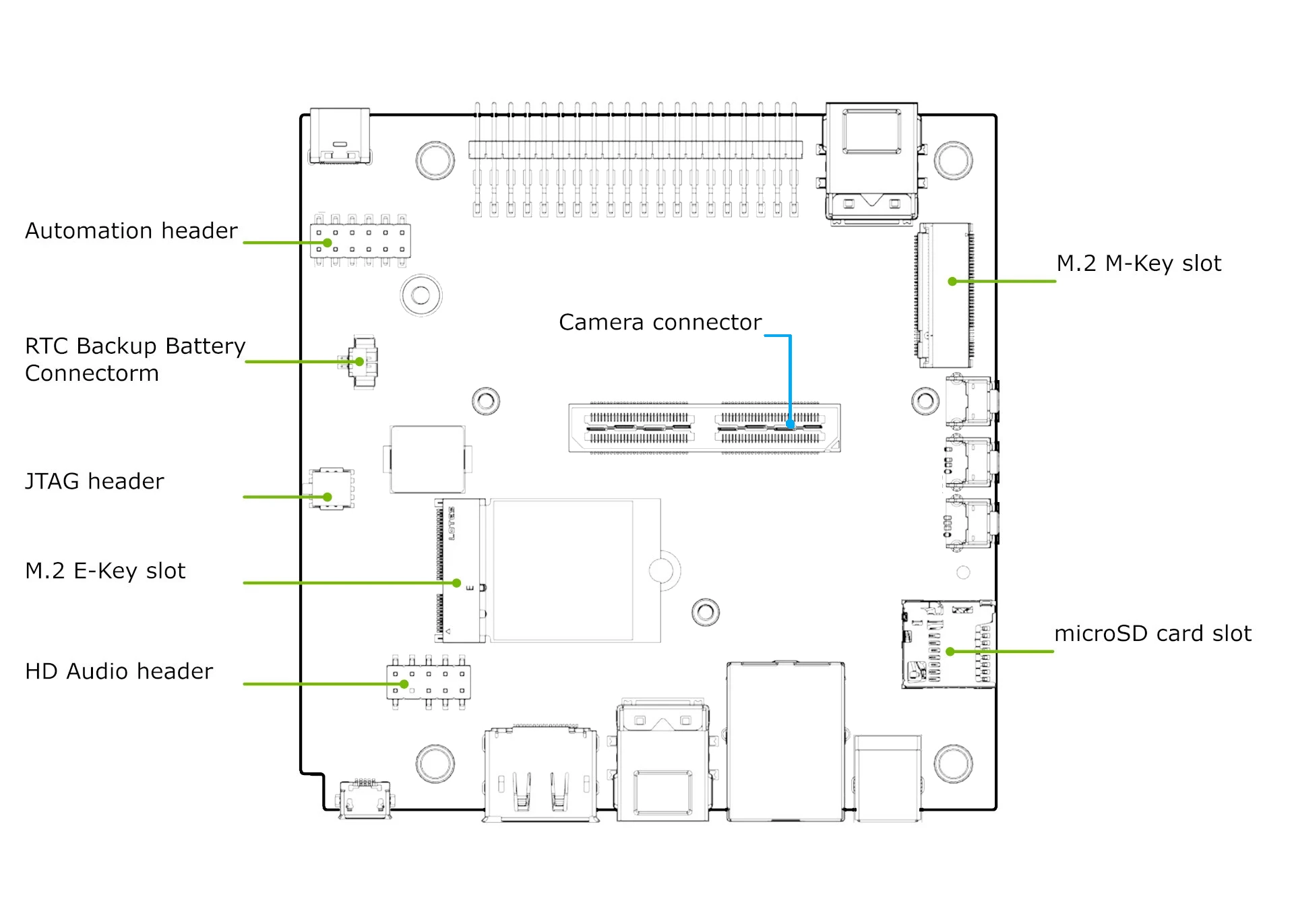

Plug the capture card into the ‘Camera connector’ slot and secure it using the three provided screws, as shown in the following diagrams:
AGX Orin bottom view
AGX Orin capture card installation
The capture card is powered by the Dev Kit, therefore you do not need to use an additional power supply for the card.
Capture card on AGX

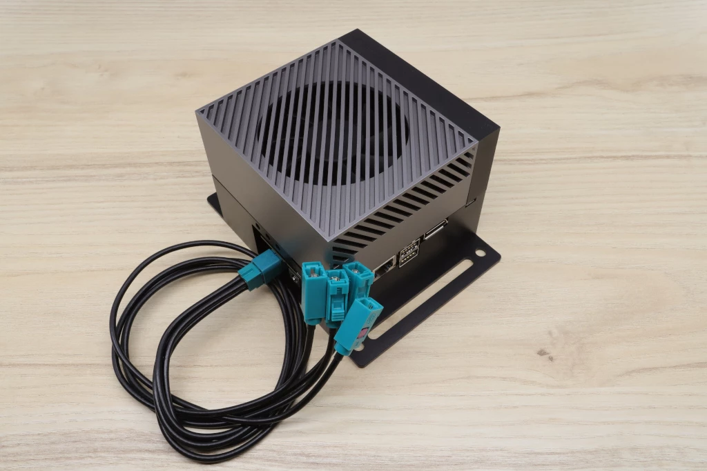

Connect the camera
ZED X with Fakra cable

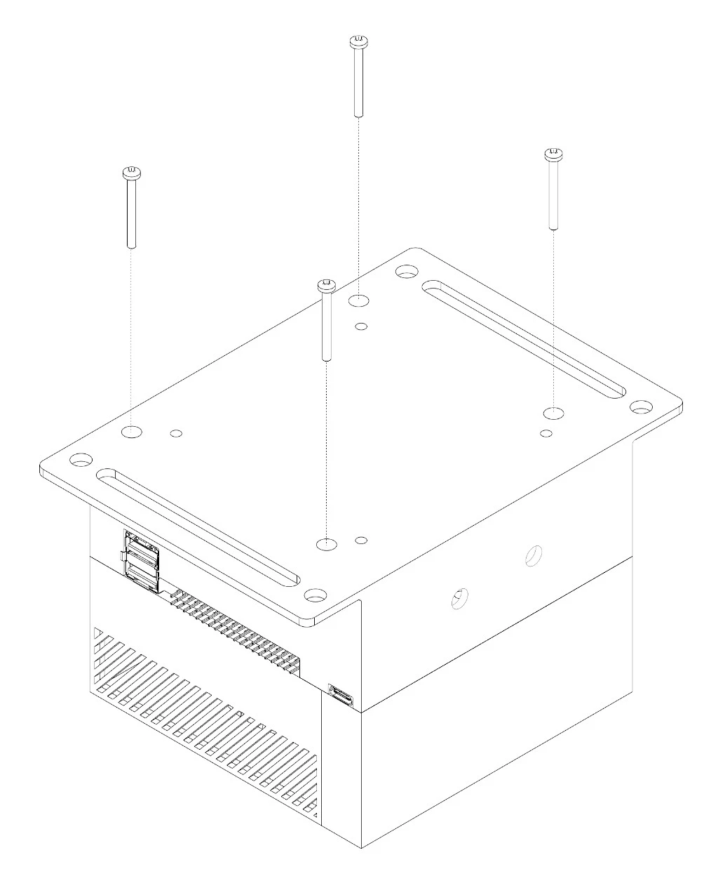

If you are using an AGX Orin Developer Kit, we recommend you use the Enclosure for the AGX Orin Developer Kit, available in the StereoLabs store, to securely integrate our GMSL2 Capture Card while keeping the electronics safe. It also allows you to mount the Dev Kit on any surface using VESA 75x75, and gives the possibility to add WiFi antennas to boost your AGX Orin wireless transmissions.
AGX Orin with enclosure
AGX Orin enclosure installation

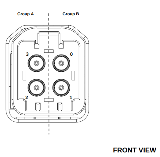

ZED Link Duo connections
Camera TypeCamera ModelMax number of cameras per GroupMax Resolution/FPS per Group
MonocularZED X One GS / ZED X One SUp to 2 camerasHD1200@60fps / HD1080@60fps / SVGA@120fps
MonocularZED X One 4K1 camera (only to port #0, #2)4K@15fps / QHDPLUS@15fps / HD1200@60fps / HD1080@60fps
StereoZED X / ZED X Mini / ZED X Nano1 CameraHD1200@60fps / HD1080@60fps / SVGA@120fps
StereoZED X / ZED X Mini / ZED X NanoUp to 2 CamerasHD1200@30fps / HD1080@30fps / SVGA@60fps
MixedZED X One GS/ZED X One S + ZED X/ZED X Mini / ZED X Nano1 ZED X One GS/S + 1 ZED X/Mini/NanoHD1200@60fps / HD1080@60fps / SVGA@120fps
