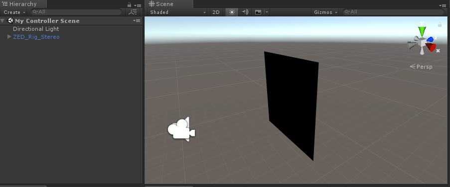

  • Start a new scene, install the ZED Unity plugin, delete the Main Camera and drag ZED_Rig_Stereo (Packages -> ZED SDK -> Prefabs) into the Hierarchy.

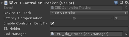

  • Add a ZEDControllerTracker component to each one.
  • Set the Device to Track field to “Left Controller” on the Left Hand object, and to “Right Controller” on the Right Hand object.
  • Drag and drop the ZED_Rig_Stereo object into the ZED Manager field. This allows the script to compensate for drift when positioning the controllers.
The ZEDControllerTracker component will move these objects to match where your controller is, with a slight delay to compensate for the ZED image’s latency.

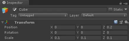

  • Right-click the Right Hand object and add a cube to it as a child by clicking 3D Object -> Cube.
  • With the new cube selected, go to the Inspector and change its Z Position to 0.2 and its Scale to X = 0.1, Y = 0.1, Z = 0.1. This will make it hover 20 centimeters in front of the controller and shrink it down to a manageable size.

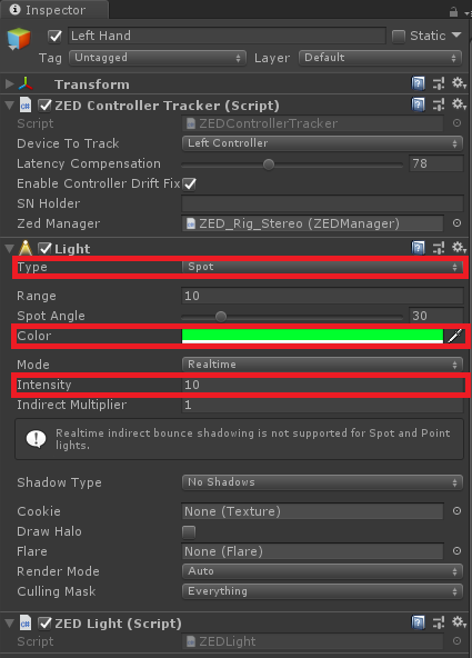

  • Select the Left Hand object
  • Add the ZEDLight script. When you add it, it will automatically add Unity’s Light component as well.
  • Change the Light component’s Type to Spot, the Color to a bright color of your choosing, and the Intensity to 10. This’ll make it a disco-style spotlight attached to your hand.
