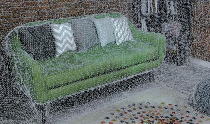

Mesh
A mesh represents the geometry of the scene by surface. It is a set of watertight triangles defined by vertices and faces. This surface can be filtered and textured after scanning.

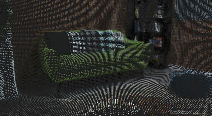

Fused Point Cloud
A point cloud represents the geometry of the scene by a set of colored 3D points.

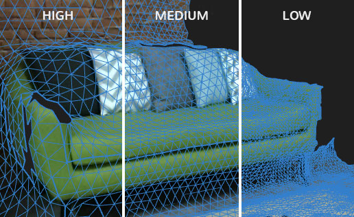

Mesh Filtering
Filtering is often desirable to reduce the number of polygons per mesh after capture to improve performance when the mesh is used. Mesh Filtering lets you decimate and optimize the 3D models to reduce polygon count while preserving desirable geometric features.
Three presets are available: HIGH, MEDIUM and LOW. The LOW filtering mode simply fills holes and cleans mesh outliers, while the two other modes perform mesh decimation. Try the different presets to select the one that best suits your application.
