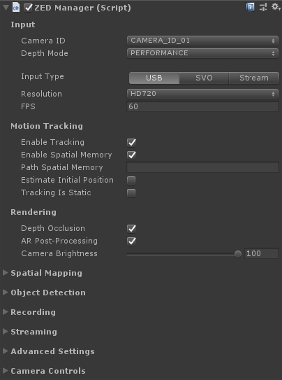

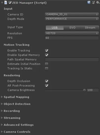

Enable Positional Tracking
  • Click on ZED_Rig_Mono in the Hierarchy to display the attached ZED Manager script in the Inspector panel.
  • Enable Positional Tracking so that the pose of the virtual camera follows the movement of the device in the real world.
  • Enable Spatial Memory. This allows the ZED to detect and correct positional tracking drift while moving and maintains the real world position of virtual objects.

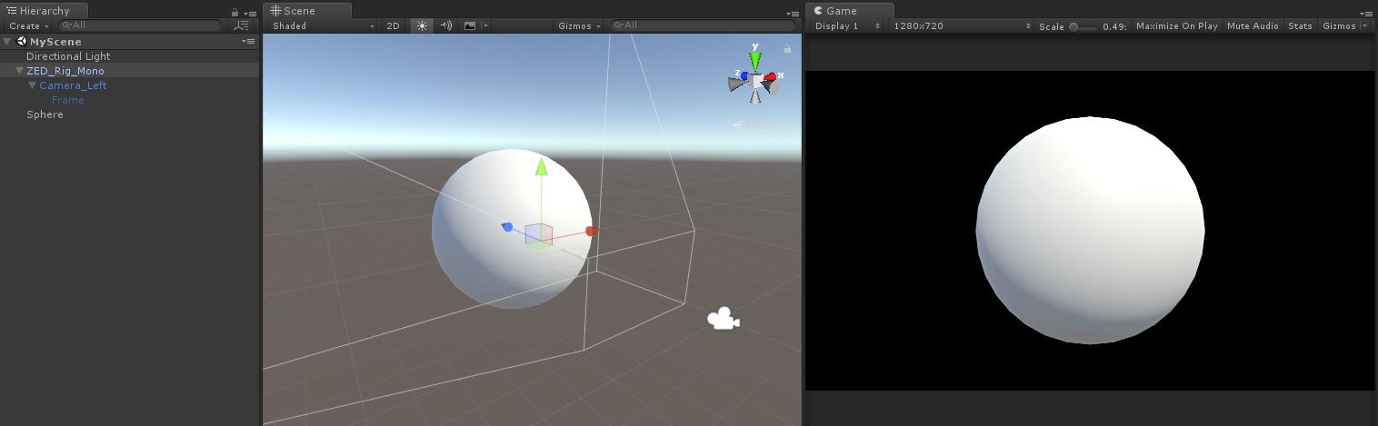

Add a Virtual Object
Let’s add a virtual sphere to the scene. When you add virtual content, make sure to move it into the field of view of the camera and leave the camera rig at its origin (0,0,0). The field of view of the rig is automatically determined by the camera calibration parameters, and rig position is updated by positional tracking.
  • To add a sphere to the scene, right-click in the Hierarchy and select 3D Object > Sphere.
  • The sphere should appear at the camera’s origin. Move the sphere 2 meters away from the camera by setting the sphere’s position to X = 0, Y = 0 and Z = 2.
  • Now you can click on Play to see the virtual sphere in the real world and move around it.
