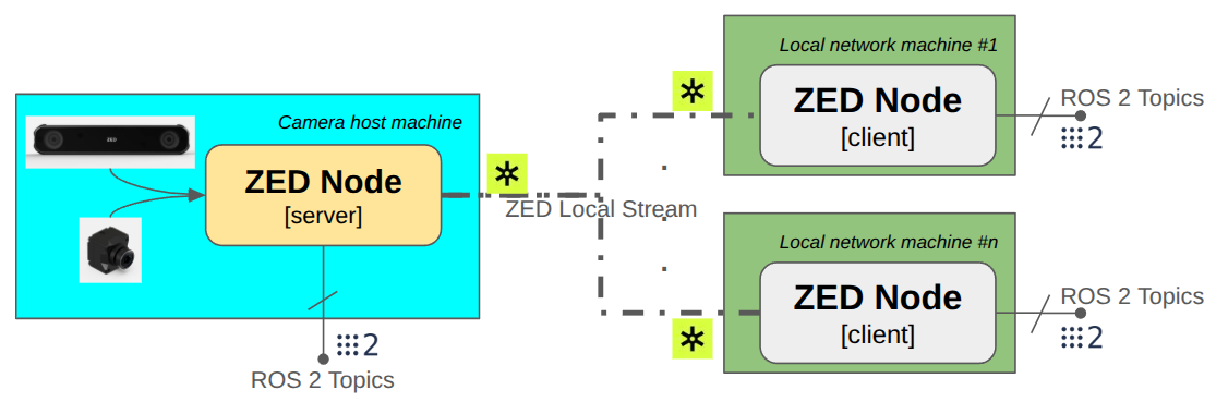

Architecture
This configuration requires a ZED Wrapper node to act as a Streaming Server and one or more ZED Wrapper nodes configured as Streaming Clients that connect to the server instead of directly to a physical ZED camera.
Client nodes operate as standard ZED Wrapper nodes with independent configurations. Instead of connecting to a physical camera, they connect to the server node’s network stream. Each client can independently enable or disable topics, activate features, and set parameters, regardless of the server node’s configuration or other client nodes.

Independent client configuration
Each client node operates independently and can be configured to enable only the features and topics needed for its specific use case. This selective processing significantly reduces network bandwidth and computational load.

This architecture allows each node to optimize resource usage based on its specific requirements while maintaining full access to ZED SDK capabilities.
