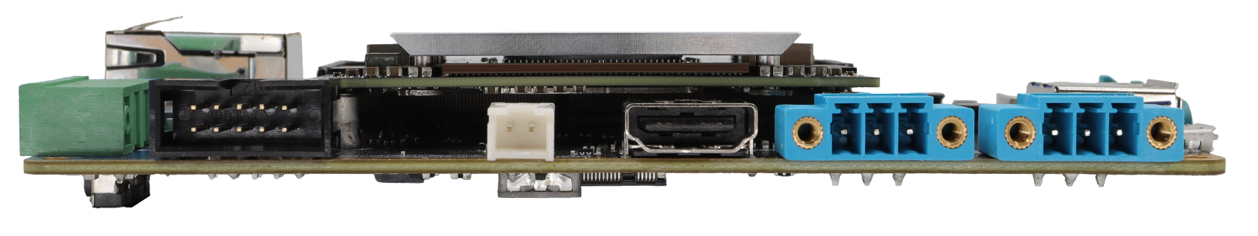

Connection Ports

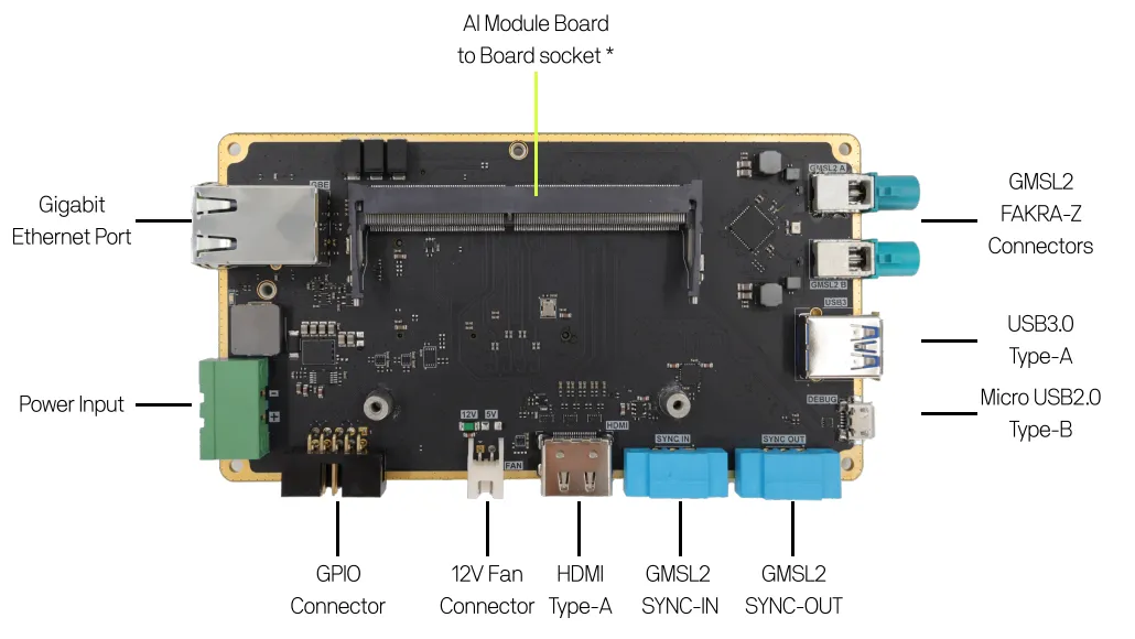

Front side
ZED Box Mini FrontMini Carrier Front

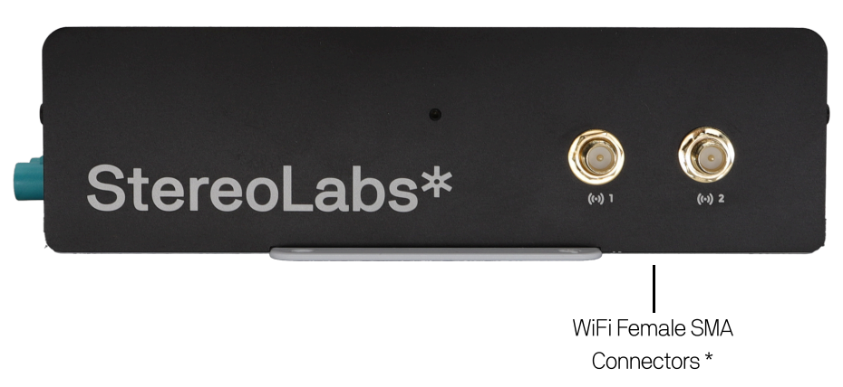

Left side
ZED Box Mini Left
  • [optional] Wi-Fi antenna connectors

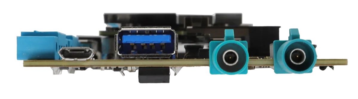

Rear side
ZED Box Mini RearMini Carrier Rear

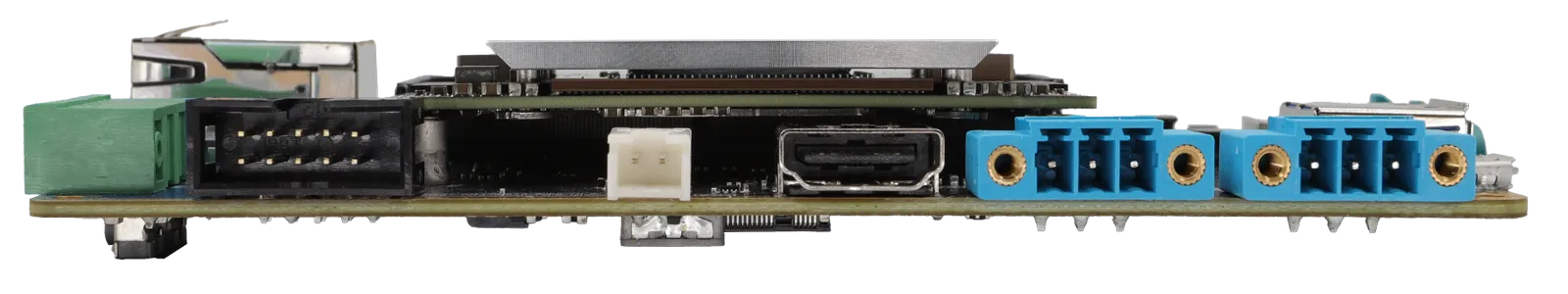

Right side
ZED Box Mini RightMini Carrier Right

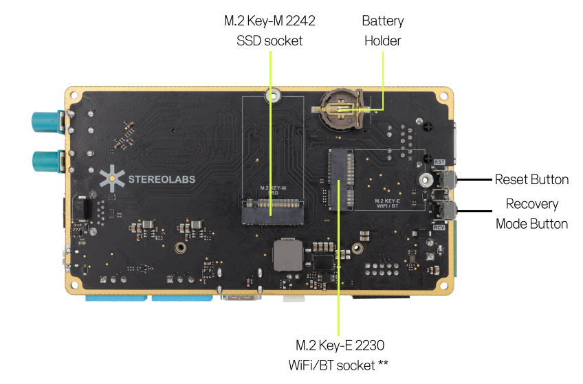

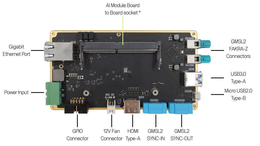

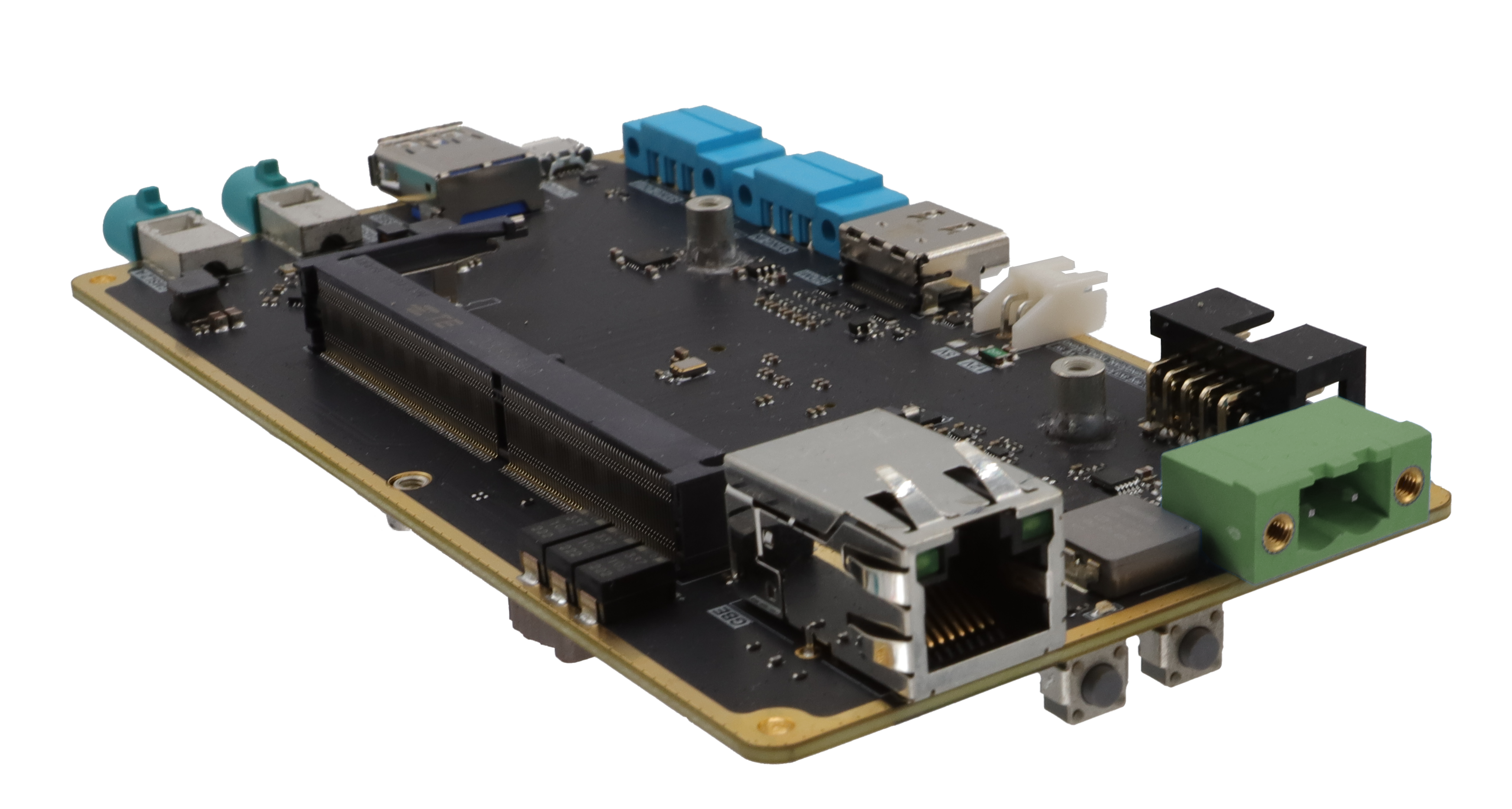

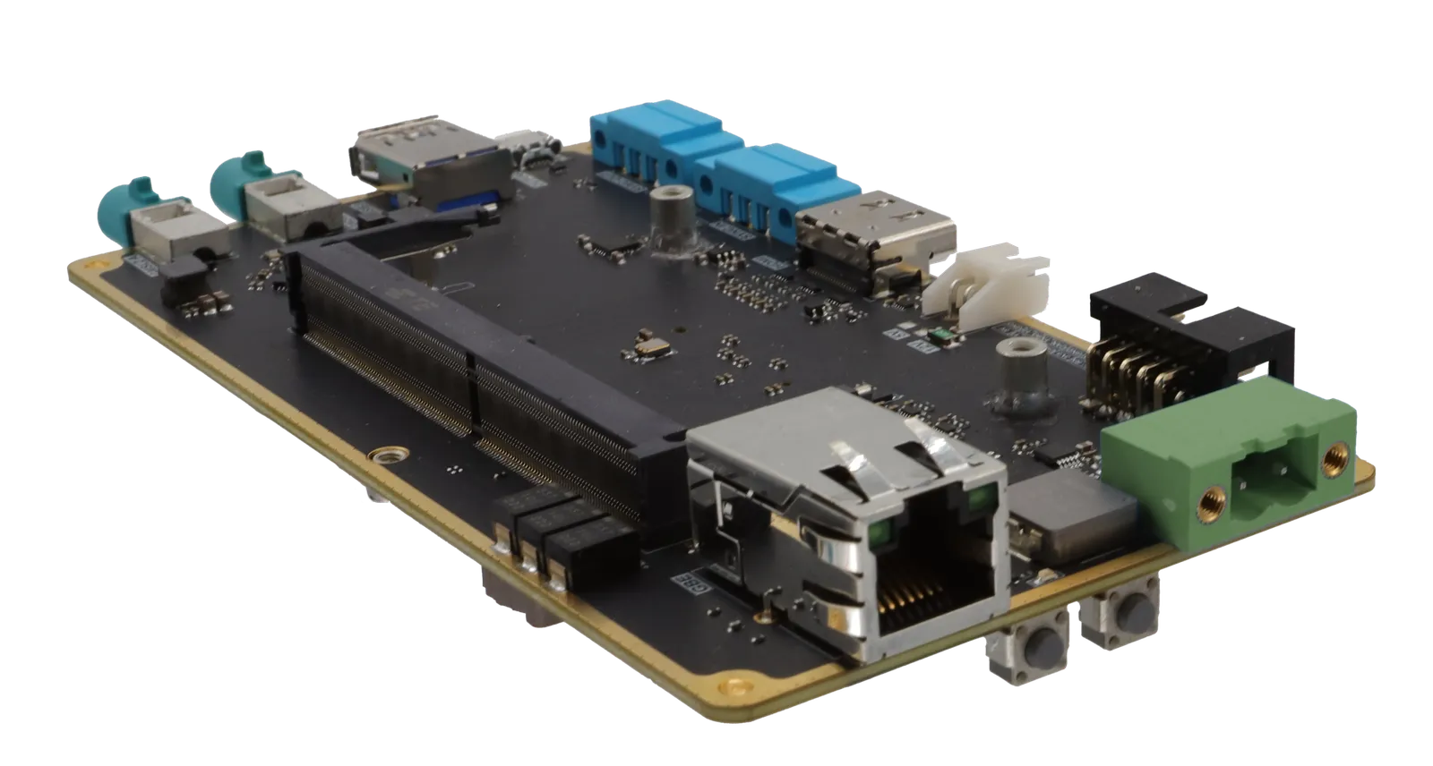

Carrier Board
Carrier TopCarrier Bottom
* [Optional] Orin NX and Orin Nano compute modules.
** [Optional] Intel AX210 Module or compatible.
Use a CR1220 coin cell battery to enable the system RTC.
If the device does not keep the date and time while powered off, the CR1220 RTC coin cell battery is discharged. Follow the battery replacement guide to replace it.

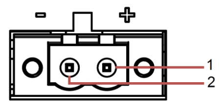

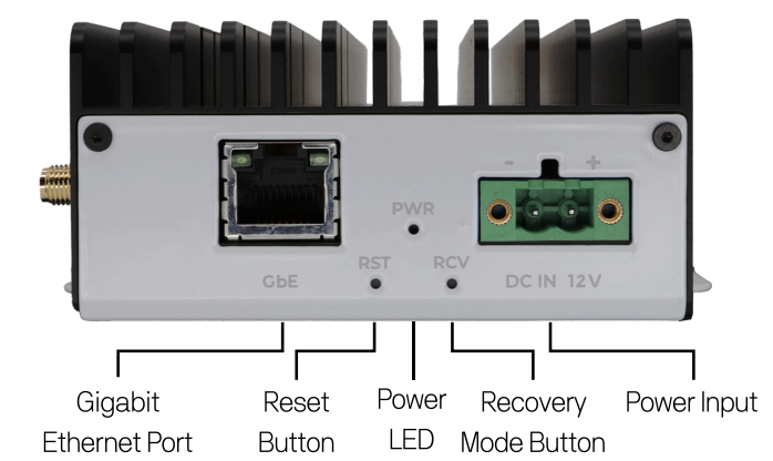

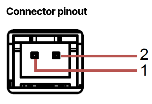

Power input
DC 10.5V to 13.5V - 60W max
Pinout Power
  • #1 - DC IN 12V
  • #2 - GND
Use the provided 12V 60W power supply or a regulated 12V input. A spare power adapter is available in the StereoLabs store.
Please ensure that the voltage of DC IN 12V is correct before connecting it to the system.
Supplying a voltage over 16V could damage the system.
Connector type: TBP01P1W-508-02GR
For battery power, we recommend using a 4S Lithium or Lithium Polymer battery with a 60W 12V DC-DC converter to guarantee a stable power voltage.

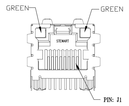

Ethernet (LAN)
The ZED Box Mini series comes with one Gigabit Ethernet LAN port supporting 10/100/1000 BASE-T with an RJ45 connector. This connector is equipped with two green LEDs indicating LAN link and activity on this port.
Pinout LAN
  • #1 - MDI0_P [TX+]
  • #2 - MDI0_N [TX-]
  • #3 - MDI1_P [RX+]
  • #4 - MDI2_P
  • #5 - MDI2_N
  • #6 - MDI1_N [RX-]
  • #7 - MDI3_P
  • #8 - MDI3_N

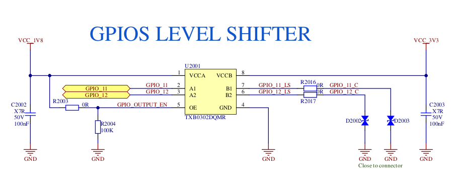

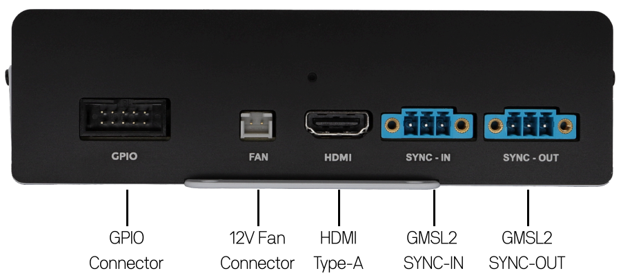

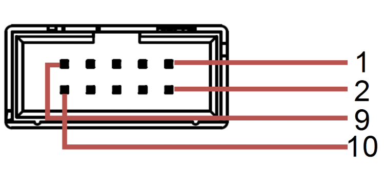

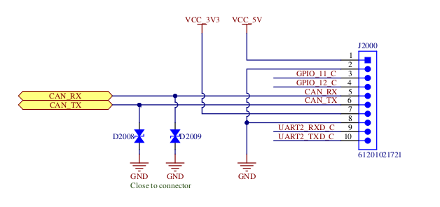

GPIO
Pinout GPIO
  • #01 - VCC_5V
  • #02 - GND
  • #03 - GPIO_11 [CMOS-3.3V]
  • #04 - GPIO_12 [CMOS-3.3V]
  • #05 - CAN_RX [CMOS-3.3V]
  • #06 - CAN_TX [CMOS-3.3V]
  • #07 - VCC_3V3
  • #08 - GND

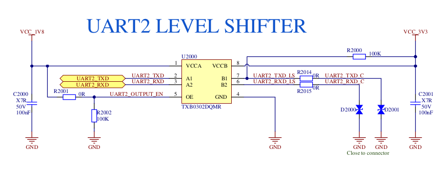

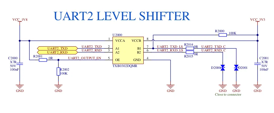

  • #09 - UART_RXD [CMOS-3.3V] (debug UART: UART2 on Rev. 1, UART1 on Rev. 2)
  • #10 - UART_TXD [CMOS-3.3V] (debug UART: UART2 on Rev. 1, UART1 on Rev. 2)

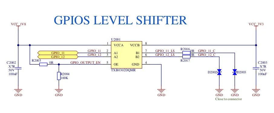

  1. The UART pins on this connector are 3.3V compliant.
  2. The GPIO pins on this connector are 3.3V compliant.
  3. The CAN pins on this connector are directly connected to the Jetson™ module and are CMOS-3.3V compliant. Please ensure to use a dedicated CAN transceiver on this end of the system before using this connection as a CAN BUS. NVIDIA® recommends using the Waveshare SN65HVD230, featuring the TI SN65HVD230 CAN transceiver.
  4. The UART pins 9 and 10 carry the debug UART of the Jetson™ module: UART2 on the Rev. 1 boards, UART1 on the Rev. 2 boards. See Debug UART on the GPIO connector. On the Rev. 2 boards, the general-purpose UART2 is on a 4-pin header (J2004) on the PCB of the carrier board. To identify your board, see Board revisions.
Using electrical signals that do not conform to the specifications may cause significant damage to the device, which is not covered by the warranty.
UART2 level shifterGPIO level shifterCAN pins
UART Level Shifter (UART2 on Rev. 1, UART1 on Rev. 2)GPIO Level ShifterCAN Pins
Using GPIO_11 and GPIO_12
Please refer to the dedicated documentation page: Using the GPIOs on your ZED Box Mini.

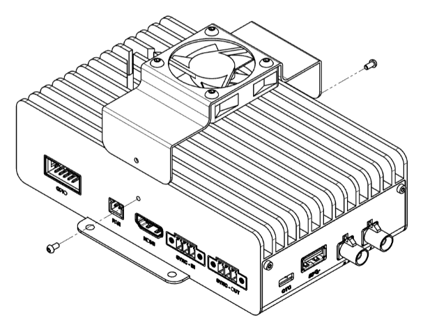

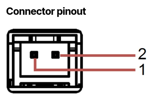

FAN
The ZED Box Mini includes a dedicated 12V-compatible fan connector to support active cooling solutions.
The fan with a mounting plate is also available for purchase on our website, recommended for high-power workloads on the selected NVIDIA® Jetson™ module. See Power Modes to tune the power consumption of the module.
The fan is mandatory in the MAXN SUPER power mode, available on the Rev. 2 boards.
Pinout FAN
  • #01 - FAN_12V
  • #02 - GND
If using a third-party fan, ensure it operates at 12V and does not exceed 500mA of current draw. Exceeding this limit will trigger the PTC (Positive Temperature Coefficient) fuse on the carrier board, interrupting power delivery and preventing fan operation.
The connector is a JST 2-pin connector (2.50 mm pitch) that mates with XHP-2.

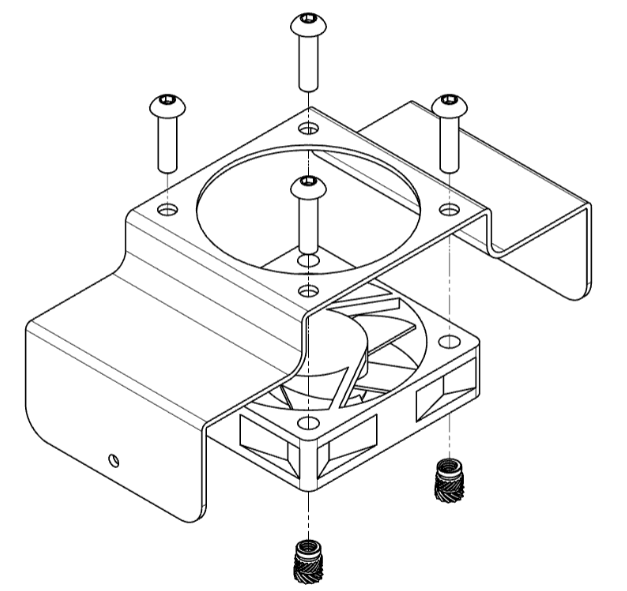

Mount the fan so that it blows air down onto the heatsink fins, with the intake facing up, away from the case.
  1. Place the fan under the fan support and fix it with the four M3 screws and the four nuts. Orient the fan so that it blows air down onto the heatsink fins: the intake side faces up, toward the support grille, and the label side faces the heatsink.
  2. Place the support on the ZED Box Mini and fix it on the sides using the two screws.
  3. Connect the fan connector to the fan port.
HDMI
The ZED Box Mini features an HDMI type-A connector, HDMI 1.4 compliant with Orin Nano modules and HDMI 2.1 compliant with Orin NX modules. With HDMI 2.1, it can display video with a maximum resolution of 3840×2160 @60Hz.
For additional information regarding the pinout, please refer to the HDMI standard.

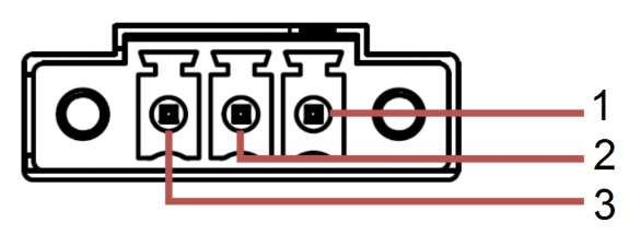

SYNC-IN
The synchronization-input connector is used as a frame-sync trigger input to synchronize image acquisition on multiple GMSL2 cameras connected to different ZED Box Minis.
The connector is a Same Sky (formerly CUI Devices) 3-pin Terminal Block connector that mates with TBP02P1W-381-03BE.
Pinout SYNC-IN
  • #01 - TRIG_INFO
  • #02 - GND
  • #03 - TRIG_IN
Set the device in slave mode
You can configure the ZED Box Mini in slave mode to synchronize GMSL2 camera image acquisition with an external trigger signal. This enables seamless integration with other ZED Box Minis or third-party sensors through the SYNC-IN connector.

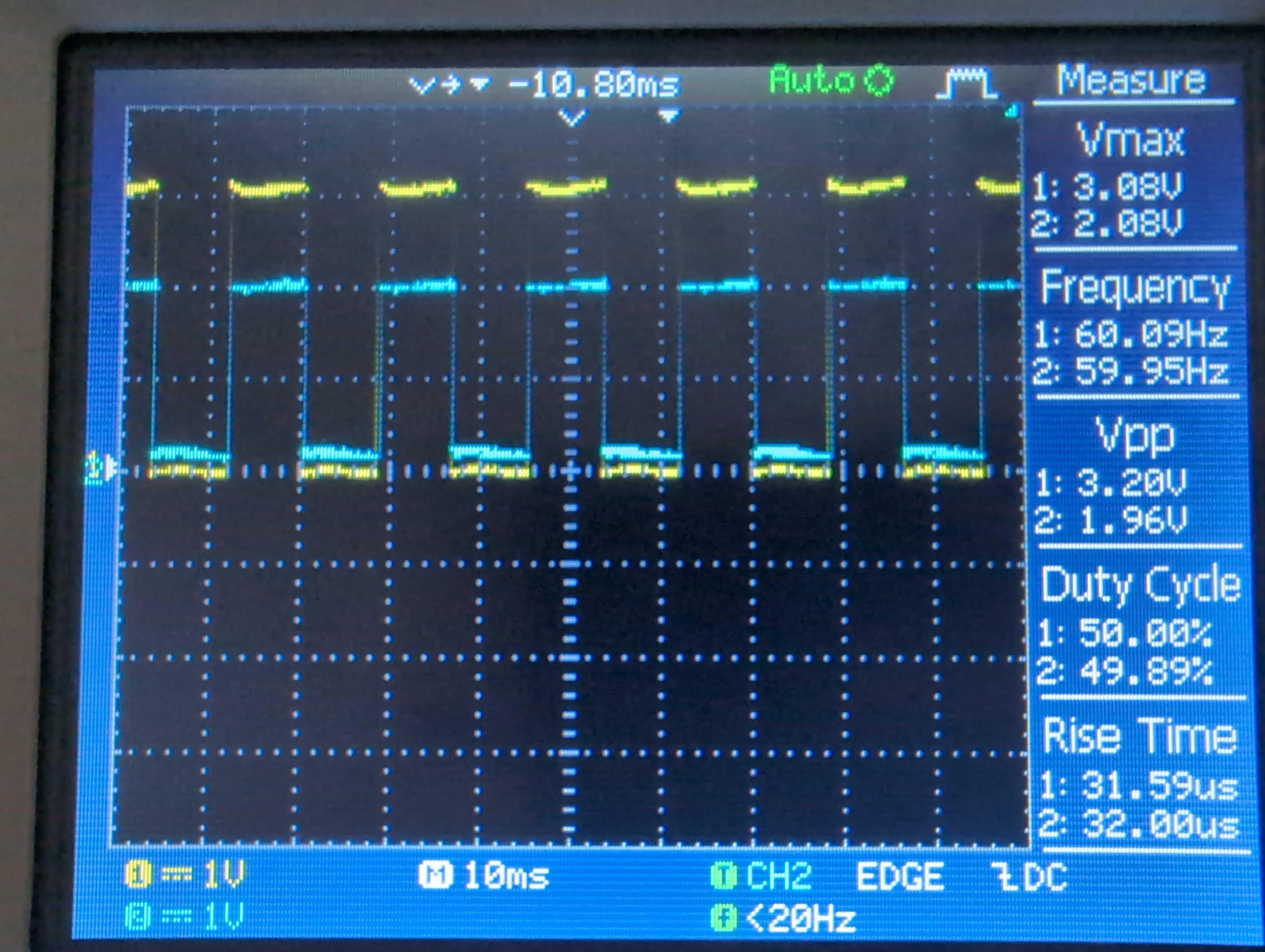

You must use an external trigger signal with the following characteristics:
  • Square wave
  • Amplitude: 3.3V +/- 10%
  • Frequency: Match the camera grab frame rate setting used with the ZED SDK - 15Hz, 30Hz, 60Hz, or 120Hz

SYNC-OUT
The synchronization-output connector is used as a frame-sync trigger output to synchronize image acquisition on multiple GMSL2 cameras connected to different ZED Box Minis.

GMSL2

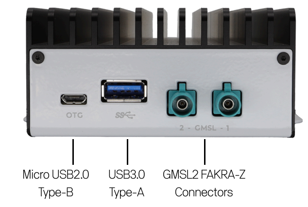

The ZED Box Mini and the Mini Carrier Board offer two separate FAKRA connectors for GMSL2. Each GMSL2 camera is connected to the box through a single coaxial cable, available in different lengths on our store. Using GMSL2 (Gigabit Multimedia Serial Link) connections, the cameras connect to a two-port deserializer, the MAX9296A, which converts the video stream to MIPI CSI-2 and transmits it to the chosen Jetson™.
Supported GMSL2 camera combinations
It is possible to connect only one camera to each single GMSL2 port.
MonocularZED X One GS
ZED X One S
HD1200@60fps
HD1080@60fps
SVGA@120fps
MonocularZED X One 4K
only available on port #0
4K@15fps
QHDPLUS@15fps
HD1200@60fps
HD1080@60fps
StereoZED X
ZED X Mini
ZED X Nano
HD1200@60fps
HD1080@60fps
SVGA@120fps
It’s not possible to connect two ZED X One 4K cameras. Only one ZED X One 4K connected to port #0 is supported.

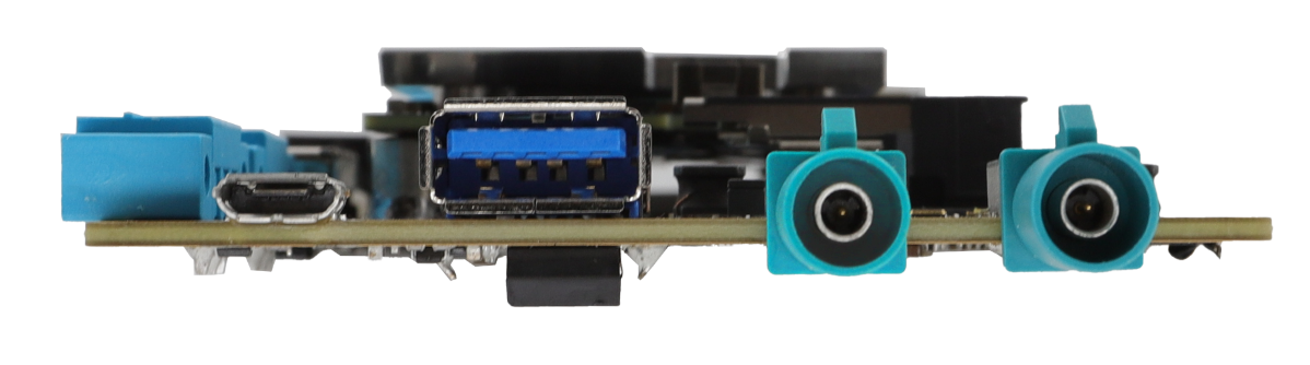

USB 3.0
A USB 3.0 Type-A connector supports up to 5Gbps data rate. It is compliant with the requirements of Super Speed (SS), High Speed (HS), Full Speed (FS), and Low Speed (LS).
For additional information regarding the pinout, please refer to the USB Type-A standard.
Micro-USB 2.0 - OTG
The ZED Box Mini features a Micro USB 2.0 Type-B that can be used for OTG functions or paired with the Recovery button to flash a new image on the device. In non-recovery mode, this OTG port provides a serial output that can be used to monitor and access the device through a serial console.
For additional information regarding the pinout, please refer to the Micro USB 2.0 Type-B standard.

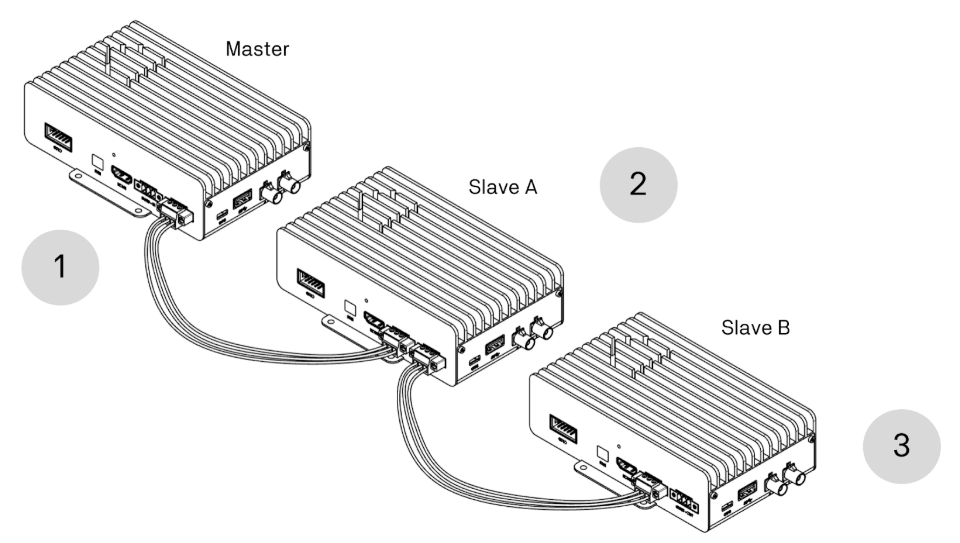

Multi-device synchronization
The ZED Box Mini enables precise camera synchronization across multiple units via GMSL interfaces, ensuring accurate data alignment for large-scale deployments. This capability is essential for intelligent systems requiring synchronized multi-camera vision, such as smart infrastructure, entertainment venues, and logistics applications.
Three-Device Synchronization Example
  1. The Master device generates and transmits a clock signal to trigger frame acquisition for its connected GMSL2 cameras.
  2. Slave A receives the Master clock signal and triggers frame acquisition for its connected GMSL2 cameras, then forwards the signal to Slave B.
  3. Slave B receives the Master clock signal through Slave A and triggers frame acquisition for its connected GMSL2 cameras.
Additional ZED Box Mini units can be daisy-chained in the same manner, propagating the Master clock signal across multiple devices in real time.
Multi-device synchronization is only available for GMSL2 cameras. USB 3 cameras do not support this feature.
Configure the devices
To enable multi-device synchronization, designate one ZED Box Mini as the Master and configure all others as Slave units.
Once properly configured, all grab function calls made through the ZED SDK on each device will be synchronized to the Master clock signal with an accuracy of approximately 15 µs.
Configure the Master device
  1. Open a terminal on the ZED Box Mini designated as Master.
  2. Enable external trigger output by setting sync_mode=0:
    sudo sed -i 's/^sync_mode=./sync_mode=0/' /etc/systemd/system/zed_x_daemon.service
    sudo systemctl daemon-reload
Configure the Slave devices
  1. Open a terminal on each ZED Box Mini designated as Slave.
  2. Enable external trigger input by setting sync_mode=2:
    sudo sed -i 's/^sync_mode=./sync_mode=2/' /etc/systemd/system/zed_x_daemon.service
  3. Verify the Slave configuration on each device:
    sudo dmesg | grep Sync
    Expected output:
    [ XX.XXXXXX] sl_max9296 2-0048: Sync mode configured
