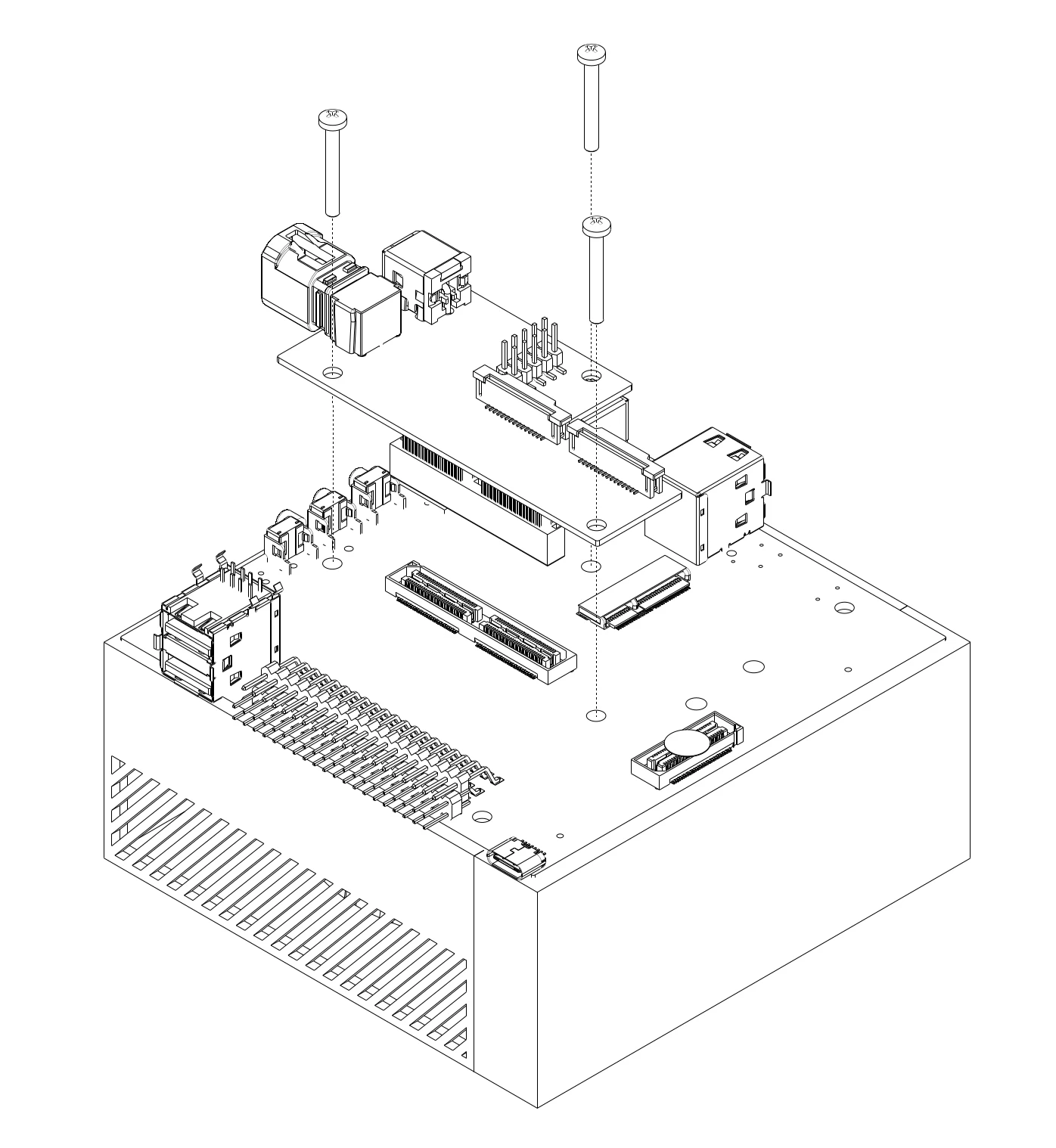

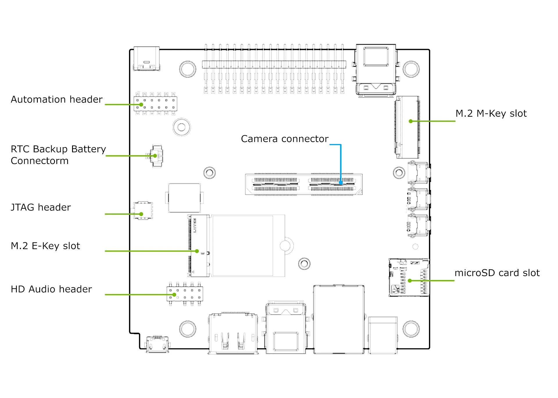

Plug the capture card into the ‘Camera connector’ slot and secure it using the three provided screws, as shown in the following diagrams:
ZED Link Duo installation on Xavier AGX

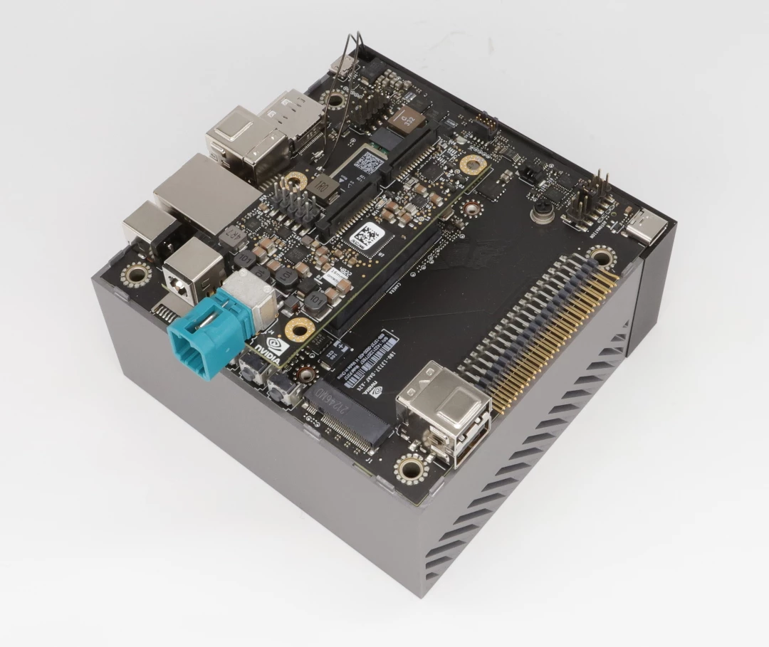

The capture card is powered by the Dev Kit, therefore you do not need to use an additional power supply for the card.
ZED Link Duo final setup on Xavier AGX
Connect the camera
ZED X with Fakra cable

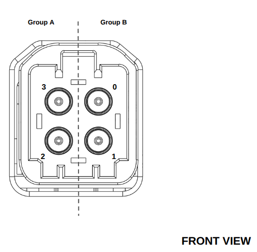

Multi-camera configurations
ZED Link Duo connections
per Group
Max Resolution/FPS
per Group
MonocularZED X One GS
ZED X One S
Up to 2 camerasHD1200@60fps
HD1080@60fps
SVGA@120fps
MonocularZED X One 4K1 camera
only to port #0, #2
4K@15fps
QHDPLUS@15fps
HD1200@60fps
HD1080@60fps
StereoZED X
ZED X Mini
ZED X Nano
1 CameraHD1200@60fps
HD1080@60fps
SVGA@120fps
StereoZED X
ZED X Mini
ZED X Nano
Up to 2 CamerasHD1200@30fps
HD1080@30fps
SVGA@60fps
