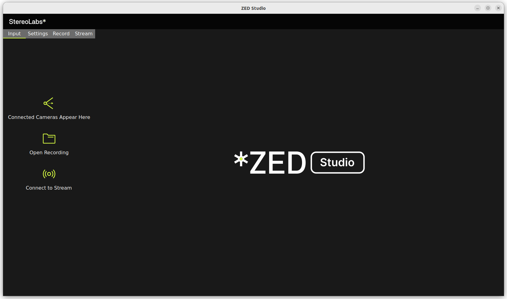

When you launch ZED Studio, it automatically detects all connected ZED cameras and opens their live streams in a grid view.
All the connected ZED cameras are listed in the left panel. You can select which cameras to visualize by opening or closing the eye icon below each camera serial number.

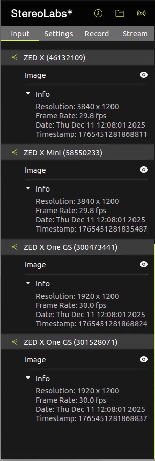

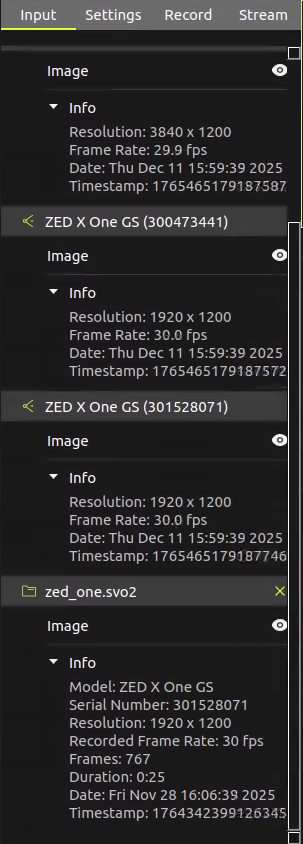

The Input tab in the left panel allows you to see all the connected cameras and their status, including:
  • Camera Model and Serial Number
  • Resolution
  • Real Frame Rate
  • Current Date and Time
  • Timestamp of the last received frame

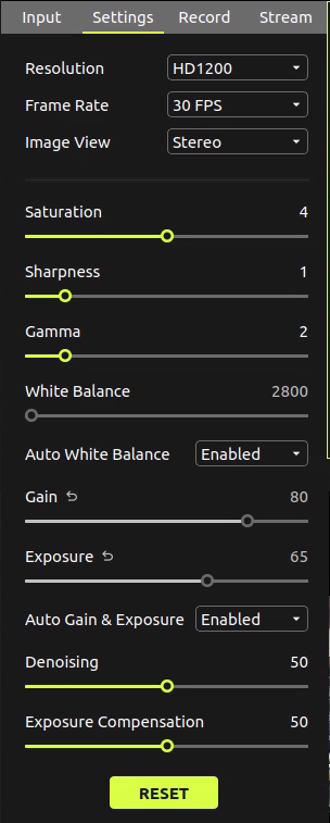

Select one of the live streams in the grid view on the right side of the GUI and click on the Settings tab to change the video resolution, frame rate, image view, and control the image settings.
General Settings
You can change the following general settings:
  • Resolution: Select the desired video resolution from the dropdown menu.
  • Frame Rate: Select the desired video frame rate from the dropdown menu.
  • Image View: Choose between different image views, such as Left, Right, or Stereo. When visualizing a monocular camera, only the Mono view is available. Unrectified views are also available (since ZED SDK 5.3).
When the selection mixes ZED X, ZED X Mini and ZED X Nano cameras, the camera controls are shown, and the resolution and frame rate offer the values that every selected camera supports (ZED SDK 5.6 and later).
Depth Settings
ZED Studio can display 2D depth map views for cameras, SVOs and streams, with depth parameter controls. The 2D depth map can only be toggled for stereo cameras. You can enable or disable the depth view directly from the Depth Panel by changing the Depth mode. Depth settings are also applied to SVO and stream inputs. Available since ZED SDK 5.2.
A Depth Precision setting (FP16 or INT8) sits next to the depth mode, for each input source with a depth view (ZED SDK 5.6 and later). See Depth Precision.
Camera Settings
You can control the image parameters, including:
  • Brightness: Adjust the brightness of the video feed.
  • Contrast: Adjust the contrast of the video feed.
  • Saturation: Adjust the saturation of the video feed.
  • Hue: Adjust the hue of the video feed.
  • Gain: Adjust the gain of the video feed.
  • White Balance: Adjust the white balance of the video feed.
  • Exposure: Adjust the exposure of the video feed.
  • Sharpness: Adjust the sharpness of the video feed.
  • Gamma: Adjust the gamma of the video feed.
  • Auto Gain & Exposure: Enable or disable automatic gain and exposure adjustment.
  • Auto White Balance: Enable or disable automatic white balance adjustment.
  • Denoising: Adjust the denoising filter strength.
  • Exposure Compensation: Adjust the exposure compensation for the video feed.
These settings allow you to fine-tune the camera parameters to achieve the desired video quality and performance. You can adjust these parameters in real-time while the camera is streaming live or receiving network streams.
Some of these parameters may not be available for all camera models or video modes. The available parameters depend on the camera model and its capabilities.
Click the RESET button to reset the camera parameters to their default values.

The Input tab in the left panel allows you to see the features of the opened SVO files, including:
  • Camera Model
  • Camera Serial Number
  • Resolution
  • Recorded Frame Rate
  • Frame Count
  • Duration
  • Frame Date and Time (at recording time)
  • Timestamp of the last received frame (at recording time)

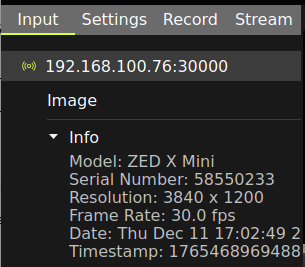

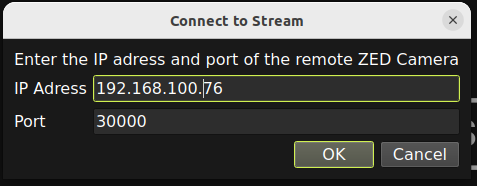

Local Network Stream Playback
You can connect to a ZED streaming server by clicking on the network icon in the top icon bar.
You can connect to a ZED Local Network Stream by entering the server IP address and port number in the dialog window.
As with live streams, you can enable or disable the network stream visualization by clicking on the eye icon below each stream name in the left panel and visualize the stream information in the Input tab.

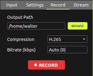

When you are receiving live streams from multiple cameras (or network streams), you can record each of them in SVO2 format by clicking on the RECORD button in the Record tab after selecting the desired stream in the grid view.
You can simultaneously record multiple streams from different cameras (or network streams). Each recording will be saved in a separate SVO file. To select the stream to record, hold the Shift key and click all the desired streams in the grid view before clicking the RECORD button.
You can configure the following recording options:
  • Output Path: The folder where the SVO file will be saved.
  • Compression: The compression mode for SVO files.
    • Lossless: No loss of quality, but larger file size.
    • H.264: Good balance between quality and file size.
    • H.264 Lossless: No loss of quality, with hardware-accelerated compression (requires an NVIDIA GPU).
    • H.265: Better compression than H.264, resulting in smaller file sizes.
    • H.265 Lossless: No loss of quality, with better compression than H.264 Lossless (requires an NVIDIA GPU).
  • Bitrate: The target bitrate for the video stream. Higher bitrates result in better quality but larger file sizes. You can leave this value at Auto (0) to let the application choose the optimal bitrate based on the selected resolution and frame rate.

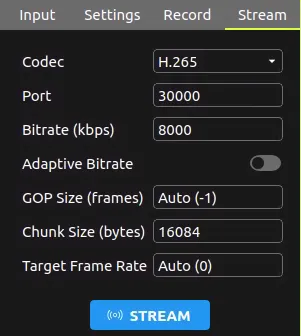

Local Network Streaming Server

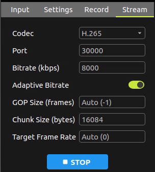

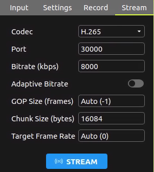

You can start a Local Streaming Server for each of the connected cameras by clicking on the Stream tab after selecting the desired live stream in the grid view and clicking the STREAM button.
You can configure the following streaming options:
  • Codec: The video codec used for streaming. You can choose between H.264 and H.265.
  • Port: The network port used for streaming. Make sure to use different ports for each camera stream.
  • Bitrate (kbps): The target bitrate for the video stream. Higher bitrates result in better quality but require more network bandwidth.
  • Adaptive Bitrate: Enable or disable adaptive bitrate streaming. When enabled, the application will automatically adjust the bitrate based on network conditions to ensure smooth streaming.
  • GOP Size (frames): The Group of Pictures (GOP) size in frames. A larger GOP size can improve compression efficiency but may increase latency.
  • Chunk Size (bytes): The size of each data chunk sent over the network. Larger chunk sizes can improve streaming performance but may increase latency.
  • Target Frame Rate: The desired frame rate for the streamed video. You can set this to match the camera’s frame rate or choose a lower value to reduce bandwidth usage. Set to Auto (0) to use the camera’s frame rate.
When the streaming server is running for a camera stream, you can find the information on the left side of the top bar of the image view window, showing the server IP address and port number:
You can stop the streaming server by clicking on the STOP button in the Stream tab.
