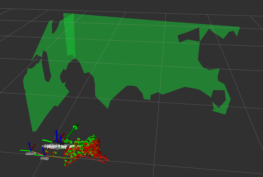

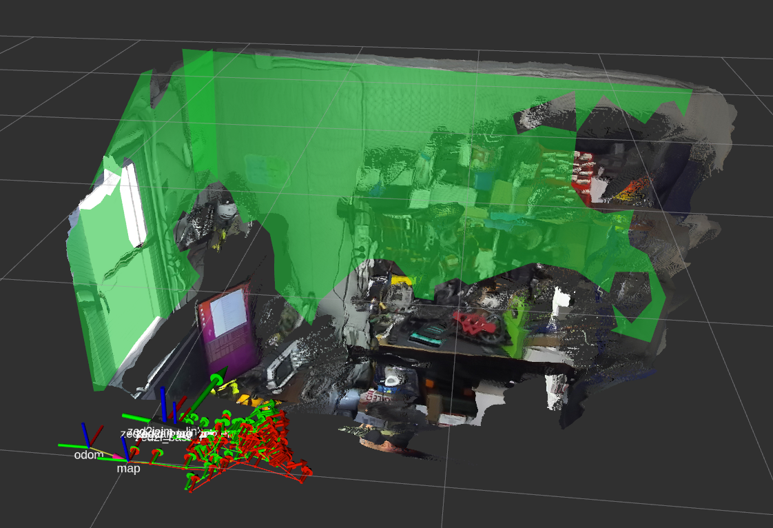

[zed_wrapper-2] 1651505097.592107647 [zed2i.zed_node] [INFO] Found plane at point [2.046,-0.016,0.322] -> Center: [1.909,-0.760,-0.007], Dims: 1.681x2.519

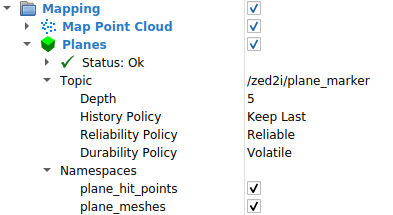

The Marker plugin allows you to visualize the information of the detected planes.
Marker
Key parameters:
  • Topic: The topic that contains the information relative to the detected planes: e.g. /zed/zed_node/plane_marker
  • Depth: The size of the message queue. Use at least a value of 2 to not lose messages.
  • History policy: Set the QoS history policy. Keep Last is suggested for performance and compatibility.
  • Reliability Policy: Set the QoS reliability policy. Best Effort is suggested for performance and compatibility.
  • Durability Policy: Set the QoS durability policy. Volatile is suggested for compatibility.
  • Namespaces: The list of available information:
    • plane_hit_points: Select to display a sphere where the click has been received.
    • plane_meshes: Select to display all the meshes of the detected planes.
