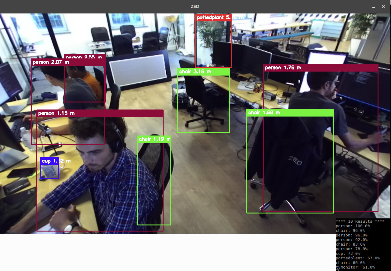

This package lets you use YOLO models, a family of deep learning models for object detection, with the ZED stereo camera in Python or C++.
It enables the use of ZED 3D cameras with YOLO object detection, adding 3D localization and tracking to the most recent YOLO models.
These samples are designed to run state-of-the-art object detection models using the highly optimized TensorRT framework. Images are captured with the ZED SDK, and the 2D box detections are then used by the ZED SDK to extract 3D information (localization, 3D bounding boxes) and perform tracking.
