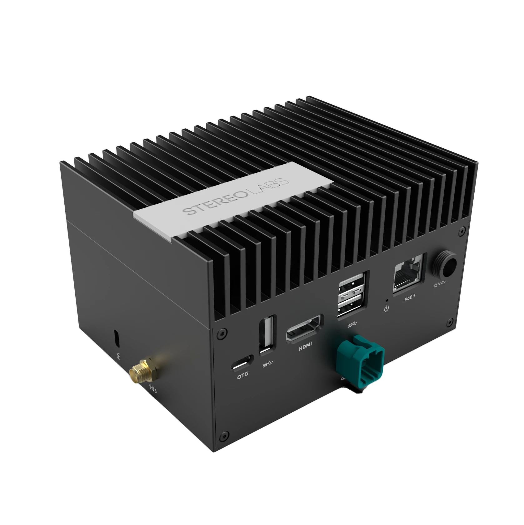

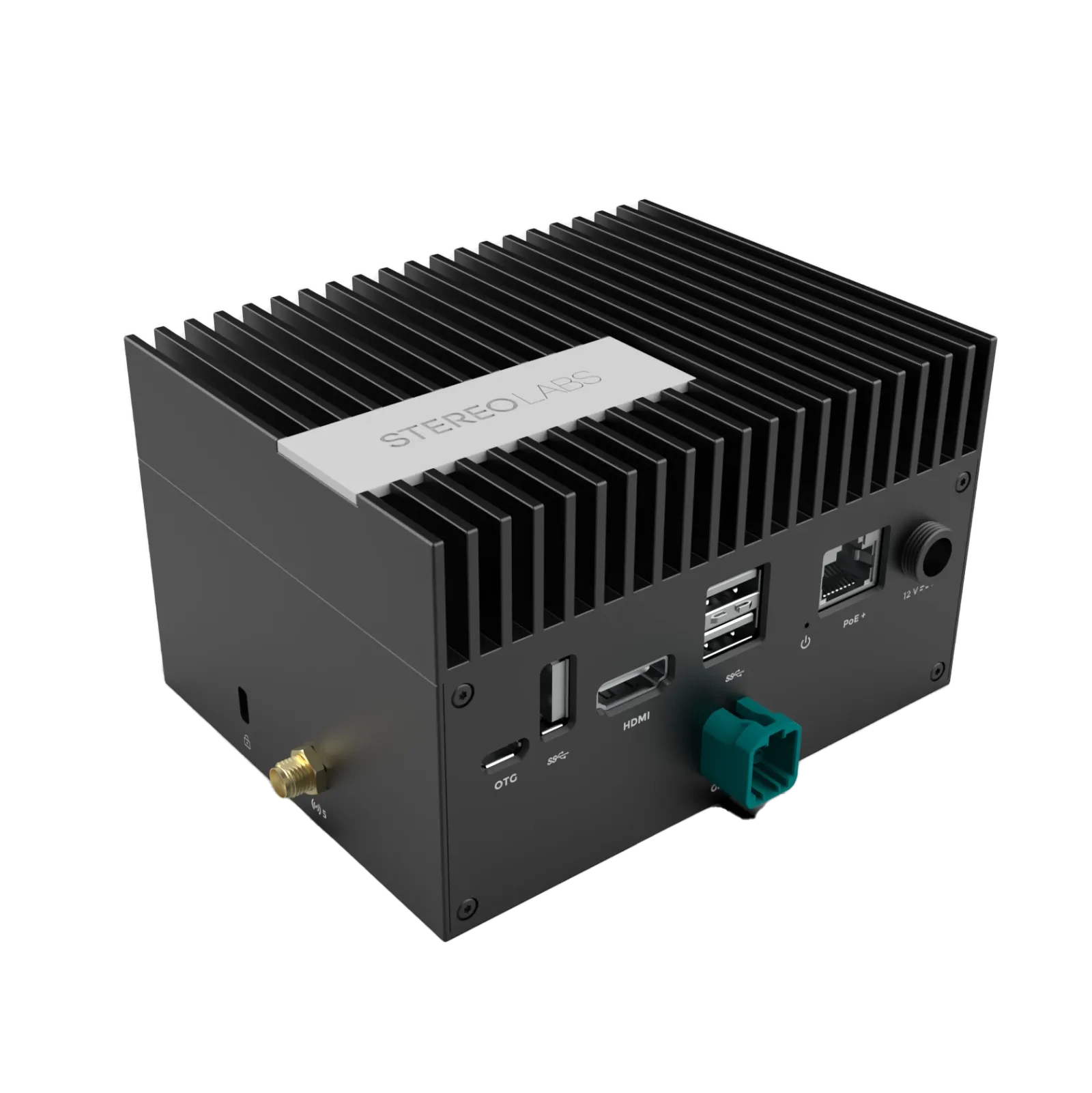

The ZED Box Orin is a ready-to-use edge AI system: an NVIDIA® Jetson™ compute module, native GMSL2 camera connectivity, and industrial-grade I/O in a compact, fanless enclosure with passive heat dissipation.
Compute module
The ZED Box Orin is available with different NVIDIA® Jetson™ compute modules, so you can match the computing power to the requirements of your application:
  • NVIDIA® Jetson™ Orin Nano 8 GB - 40 TOPS
  • NVIDIA® Jetson™ Orin NX 8 GB - 70 TOPS
  • NVIDIA® Jetson™ Orin NX 16 GB - 100 TOPS
GMSL2 connectivity is a standard feature of the ZED Box Orin. It enables high-speed, low-latency data transfer between the processing unit and your ZED GMSL2 cameras, making it an ideal choice for industrial grade applications.
  • 4 GMSL2 ports on a single 4-wire FAKRA connector, organized in 2 groups: A (ports #0 and #1) and B (ports #2 and #3).
  • Compatible with ZED X, ZED X Mini, ZED X Nano, ZED X One GS, ZED X One S, and ZED X One 4K cameras.
  • The GMSL2 driver is pre-installed. Connect the cameras before powering on the device; GMSL2 cameras are not hot-pluggable, so any change requires a reboot or a restart of the ZED X daemon.
The GMSL2 guide provides detailed information on how to use GMSL with the ZED Box Orin, including instructions on how to install the GMSL driver and configure multi-camera setups.
Connectivity
All the connection ports are available on the front panel, described in the installation guide:
  • 1x GMSL2 4-wire FAKRA camera connector
  • 1x 10/100/1000 Base-T Ethernet RJ45 with PoE+ support
  • 3x USB 3.0 Type-A
  • 1x HDMI
  • 1x Micro USB2.0 Type-B for system flashing, OTG, and serial console access
  • WiFi module with external antenna
  • 1x external antenna connector for the GNSS option
