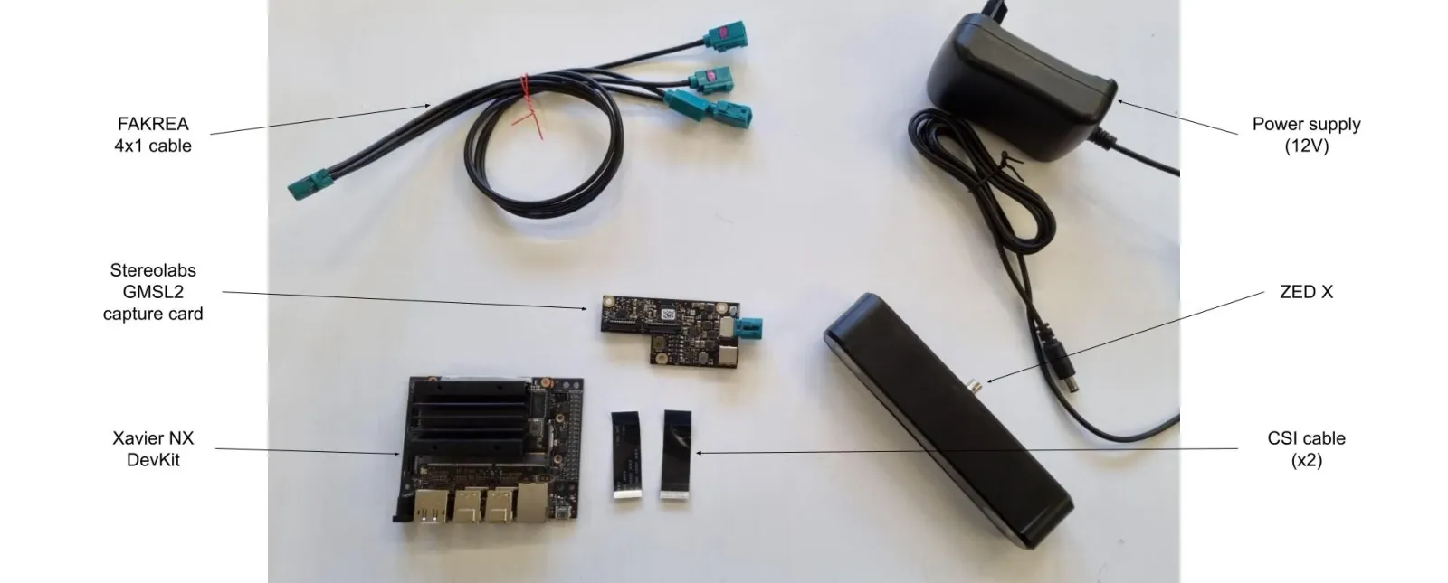

  • 1x NVIDIA® Jetson™ Xavier NX Developer Kit.
  • 1x ZED Link Duo GMSL2 capture card
  • 1x 1-to-4 GMSL2 Fakra Male to Female cable (included in the box)
  • 2x FPC Camera Cable 15-pin 1.0mm (not included)
  • 9V-19V (min 2W) power input (Barrel Jack 6.5 mm outer diameter, 2.5 mm inner diameter) to power the GMSL2 capture card (not included)
The 15-pin CSI cable must not be mistaken for a DSI cable, where the active pin connection is on the same side. On CSI, the 15 pins are on the opposite side when looking at the flat cable. The cable can be purchased at UCTRONICS.
MIPI cables carry high-speed video signals, and longer cables can introduce noise or signal degradation. For optimal performance, use cables no longer than 12 cm.

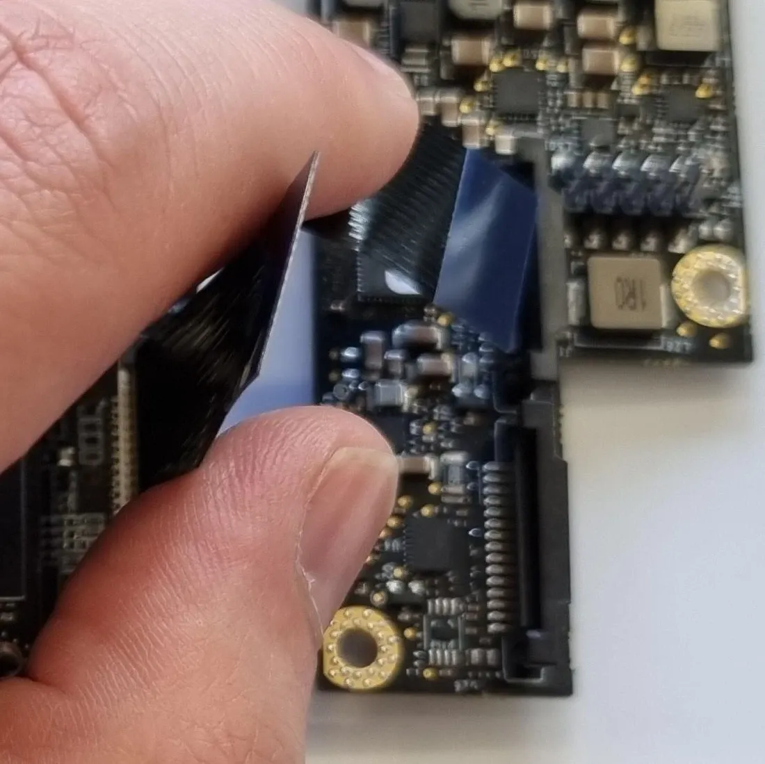

Connect the CSI cables to the MIPI 15-pin ports of the capture card. Make sure the correct side is plugged in for each port.
Xavier NX capture card cabling
Both MIPI cables must be connected to have access to 2x ZED GMSL2 cameras on the capture card.

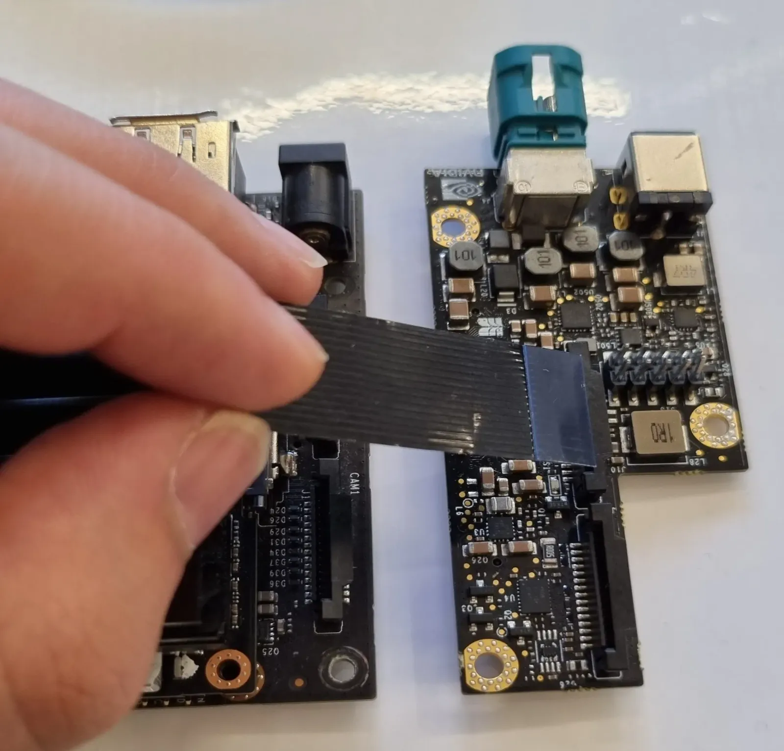

Cabling the Carrier Board
Connect the CSI cables to the carrier board 15-pin connectors.
Make sure that J9/CAM0 is connected to the centered MIPI port of the GMSL2 capture card.
J1/CAM1 must be connected to the MIPI port close to the edge.
Xavier NX capture card cabling orientation

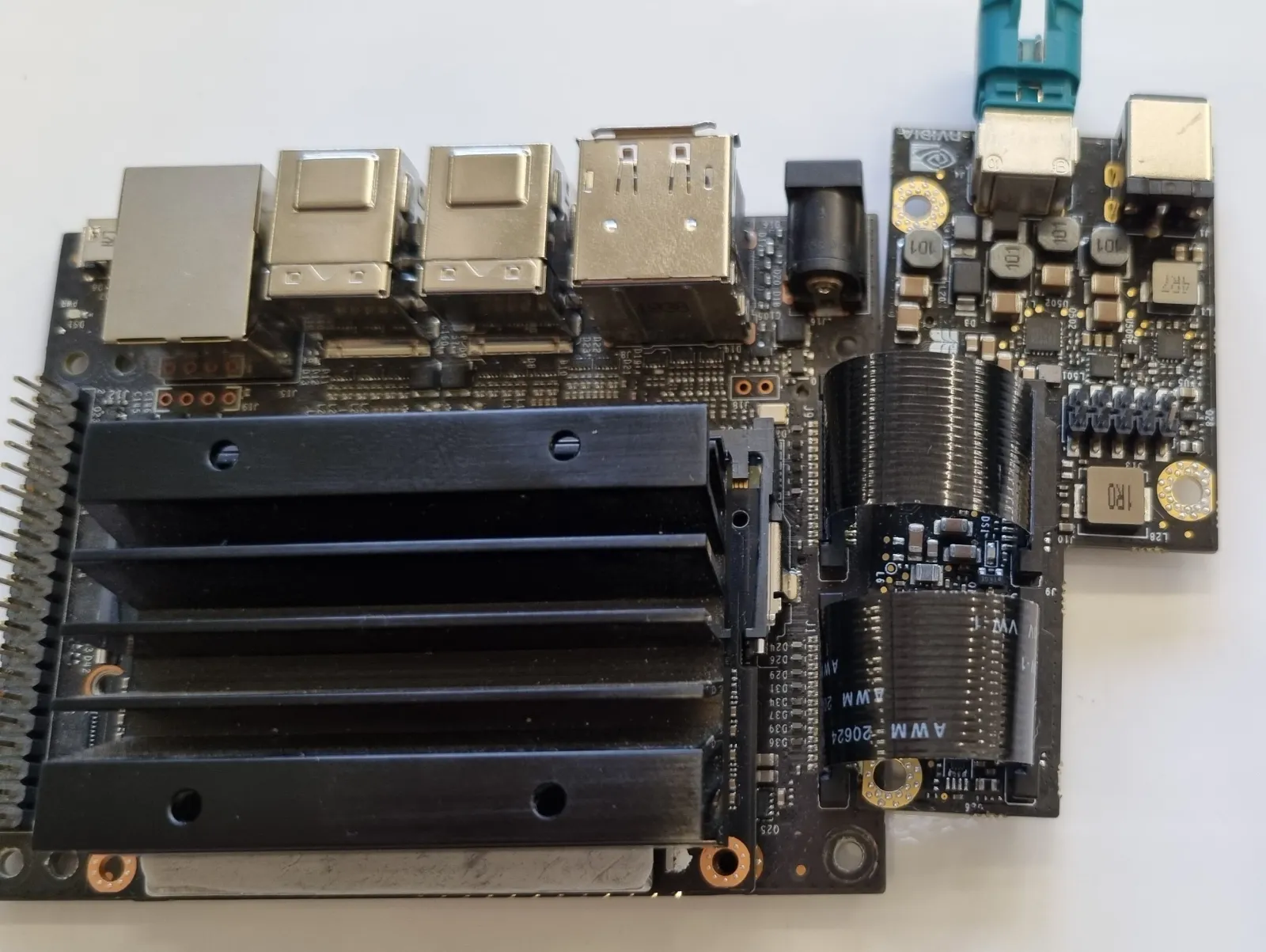

Once connected, the setup should look like the following picture:
Xavier NX cabled

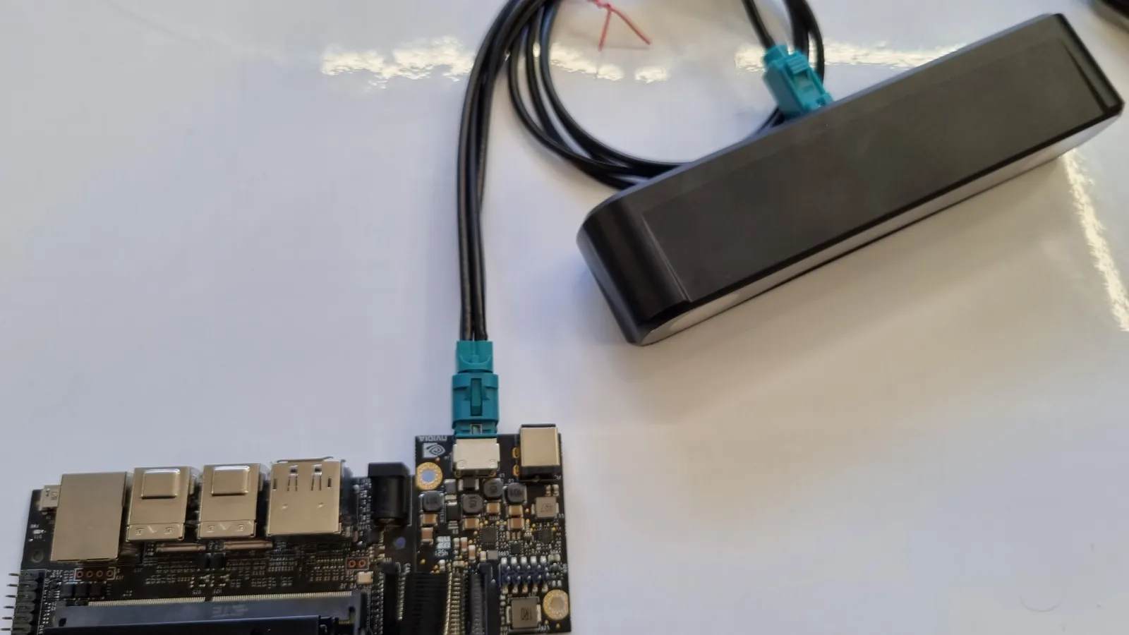

Connect the camera
Connect the GMSL2 Fakra cable female end to your ZED X. When you hear a click, the cable is securely connected to the camera.
ZED X with Fakra cable
Xavier NX plug camera
