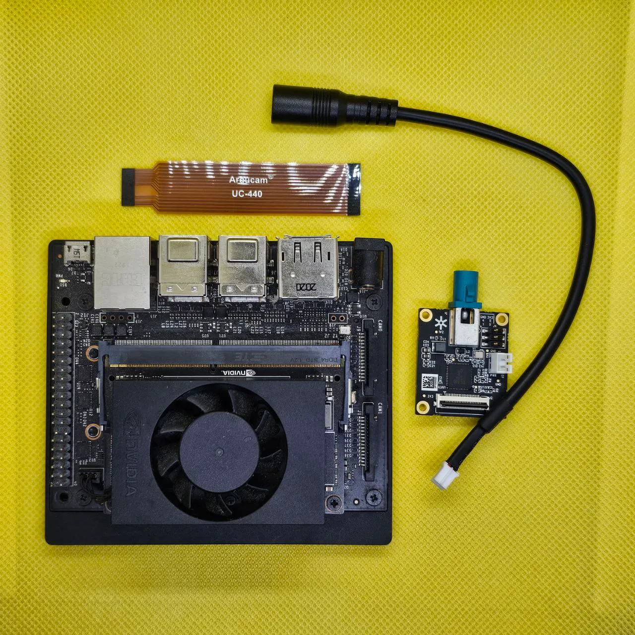

  • 1x NVIDIA® Jetson™ Xavier NX Developer Kit.
  • 1x ZED Link Mono GMSL2 capture card
  • 1x FPC Camera Cable 22-pin 0.5mm Pitch to 15-pin 1.0mm Pitch (not included)*

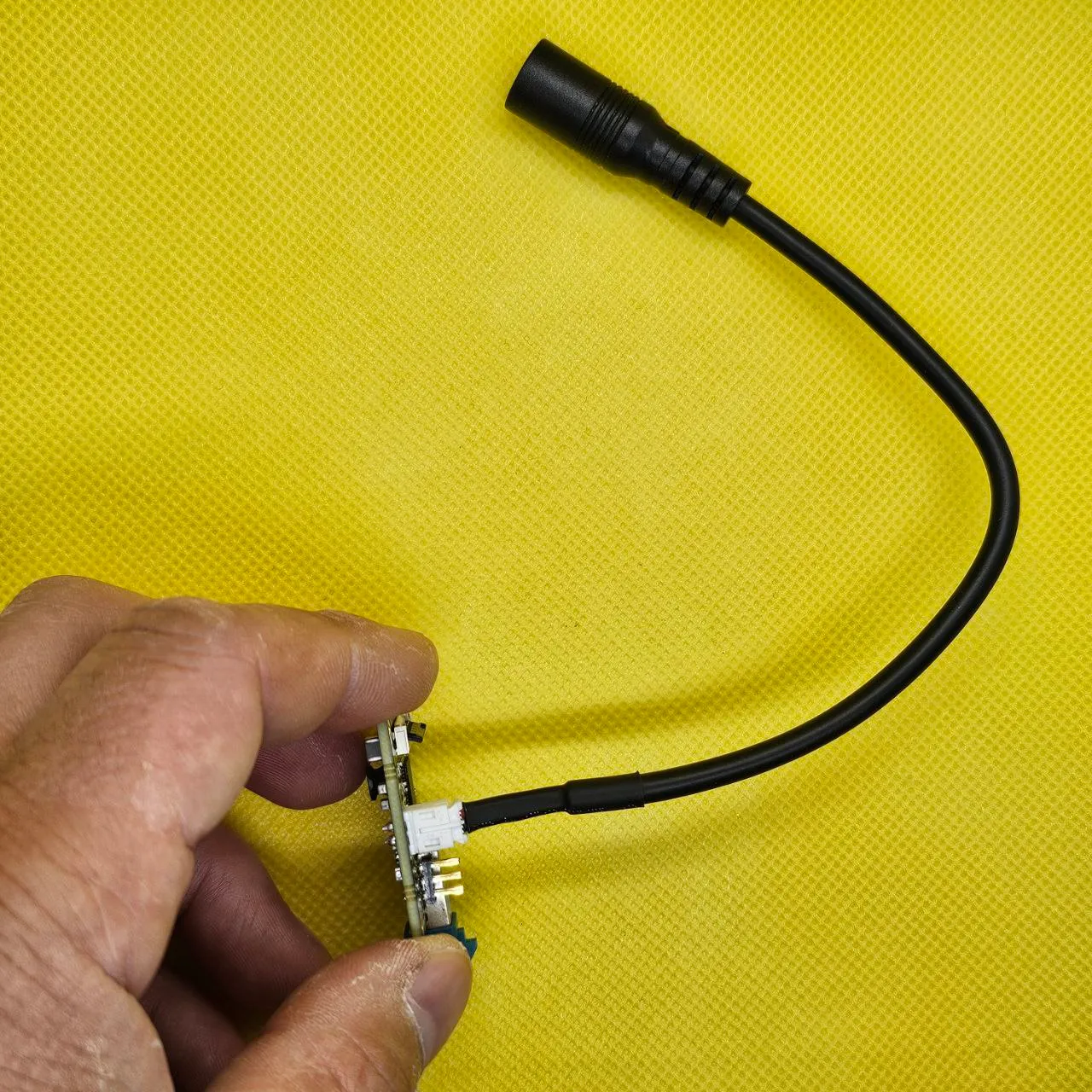

  • 9V-14V (min 2W) power input (Barrel Jack 5.5 mm outer diameter, 2.5 mm inner diameter) to power the GMSL2 capture card (not included)
* You can find the FPC Camera Cable 22 pin 0.5 pitch to 15-pin 1mm pitch at UCTRONICS.

ZED Link Mono power connection

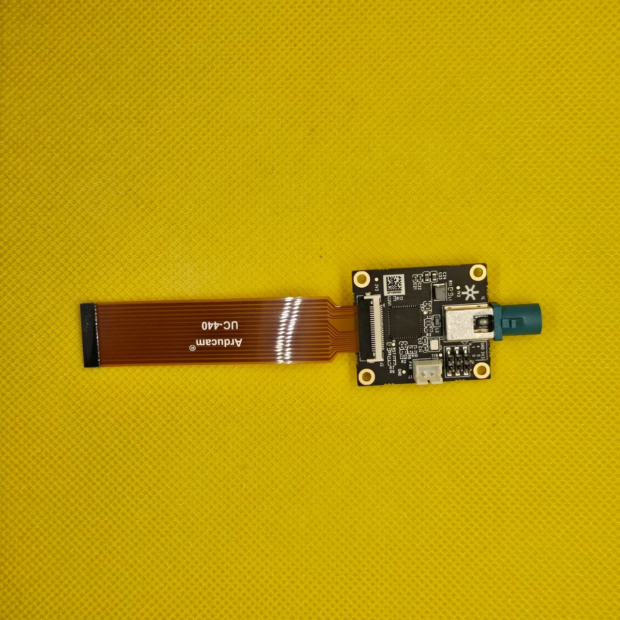

Connect the CSI cable to the MIPI 22-pin port of the capture card. Make sure the correct side is plugged in.
ZED Link Mono Xavier NX MIPI connection

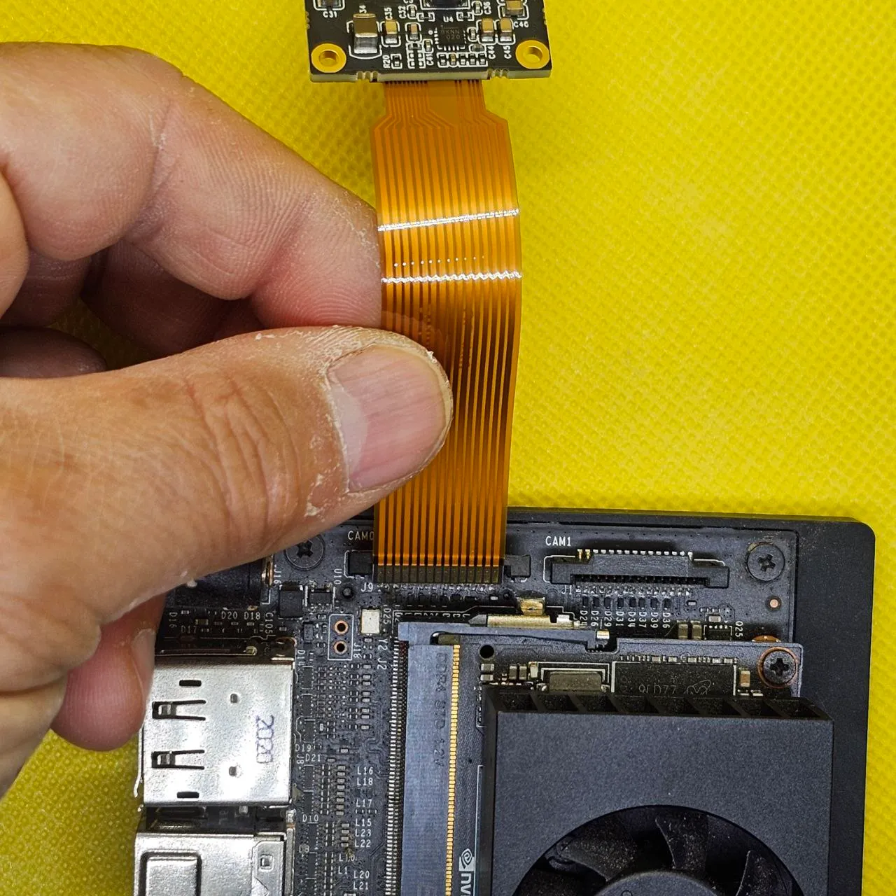

Cabling the Carrier Board

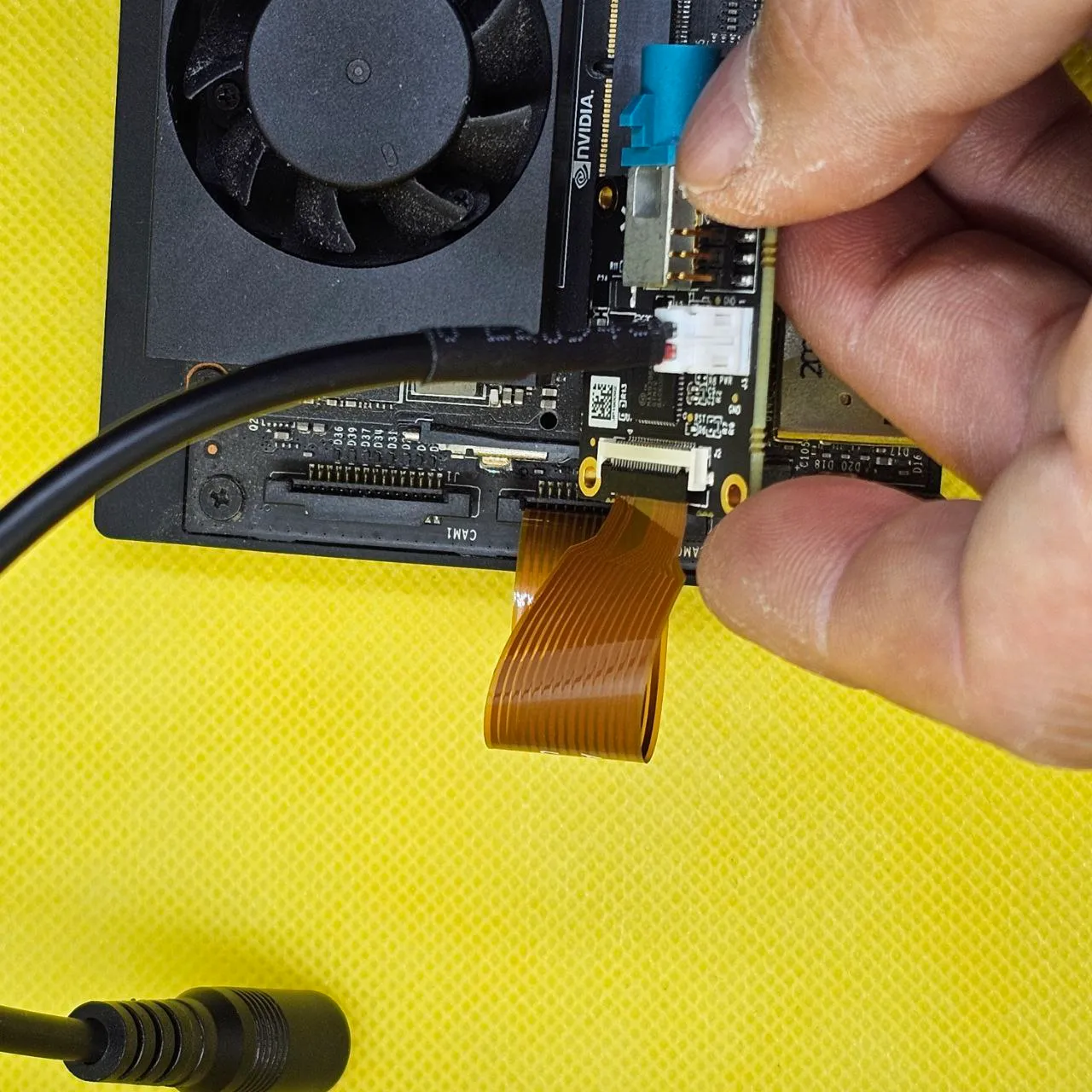

Connect the CSI cable to the carrier board 15-pin connector.
ZED Link Mono Xavier NX MIPI carrier connection ZED Link Mono Xavier NX MIPI carrier both connections

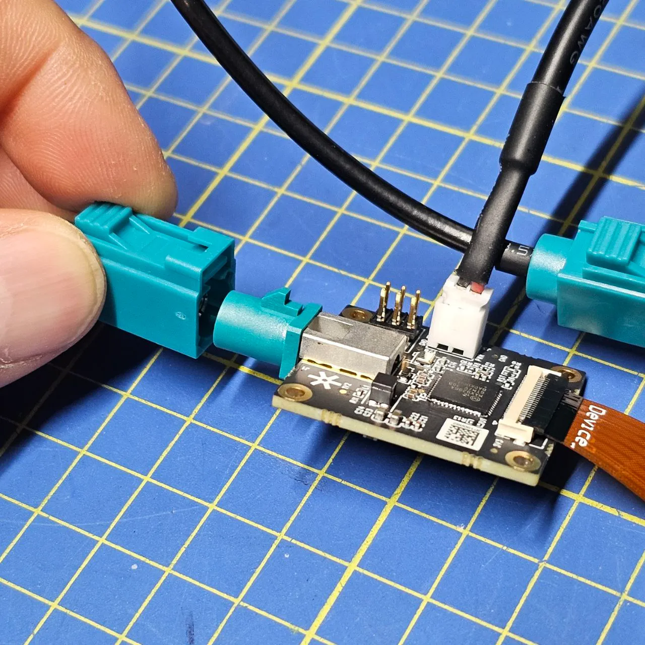

Connect the camera
ZED X with FAKRA cable
ZED Link Mono FAKRA connection
Once the cables are connected, plug the power for the GMSL2 capture card (9V-14V) so that cameras will be powered through the FAKRA cable (PoC).
