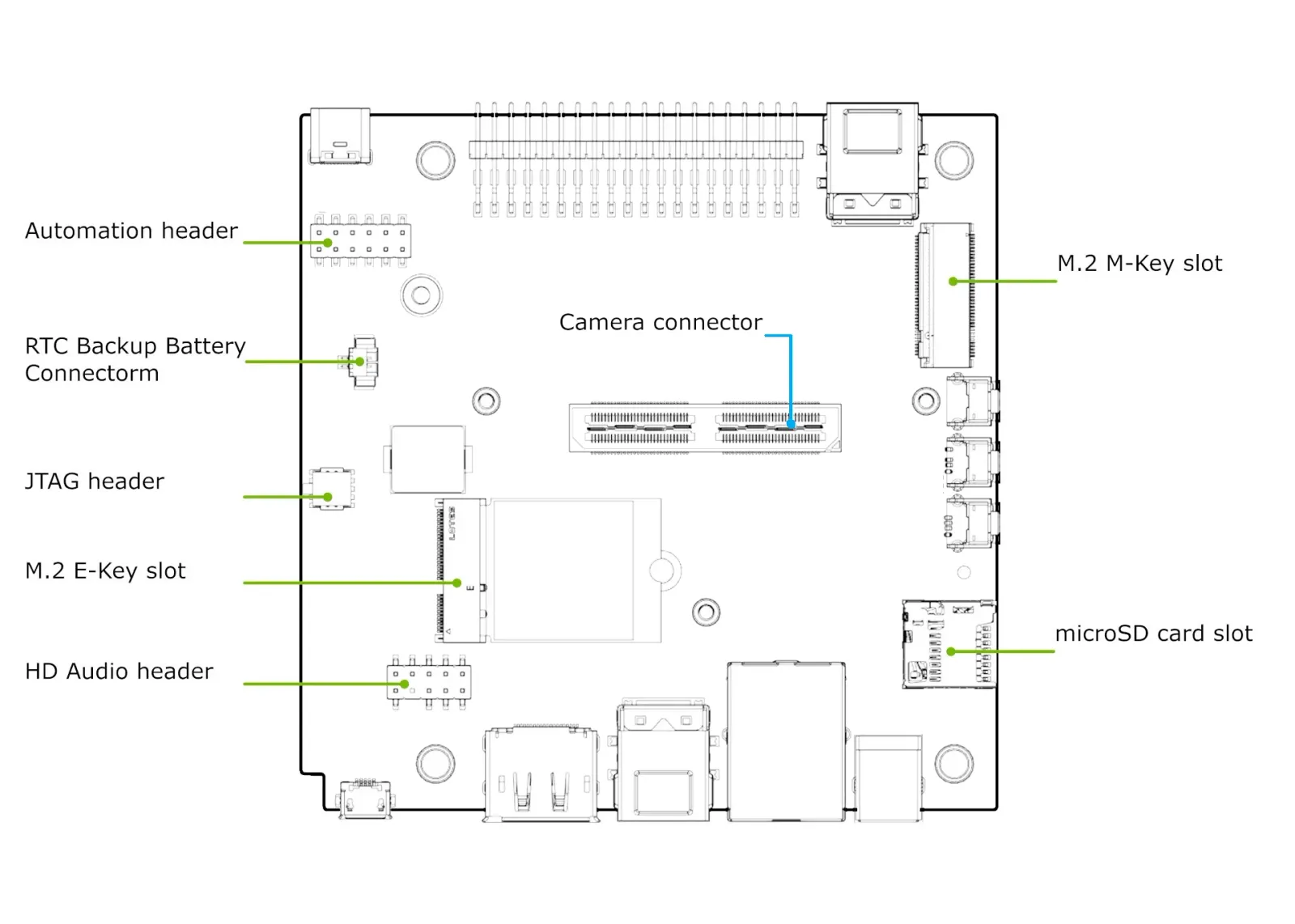

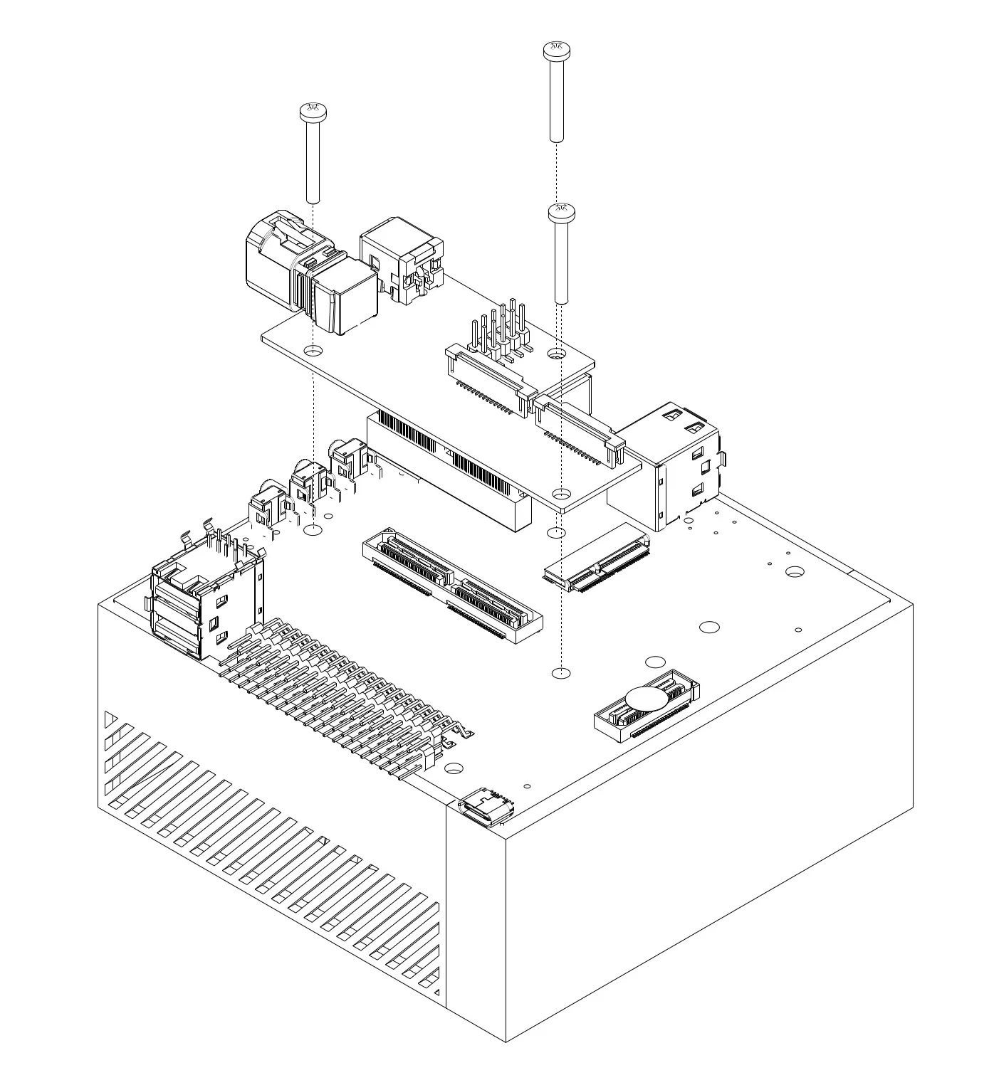

Plug the capture card into the ‘Camera connector’ slot and secure it using the three provided screws, as shown in the following diagrams:
ZED Link Duo installation on Xavier AGX

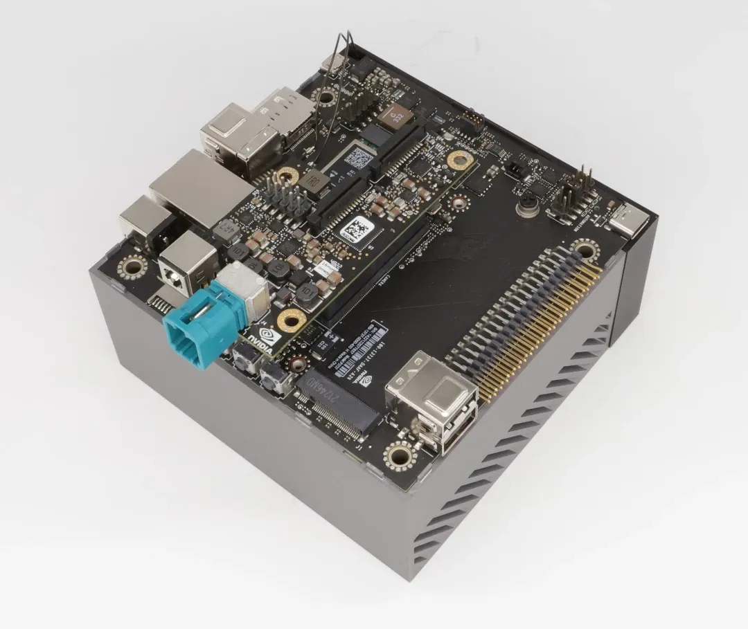

The capture card is powered by the Dev Kit, therefore you do not need to use an additional power supply for the card.
ZED Link Duo final setup on Xavier AGX
Connect the camera
ZED X with Fakra cable
