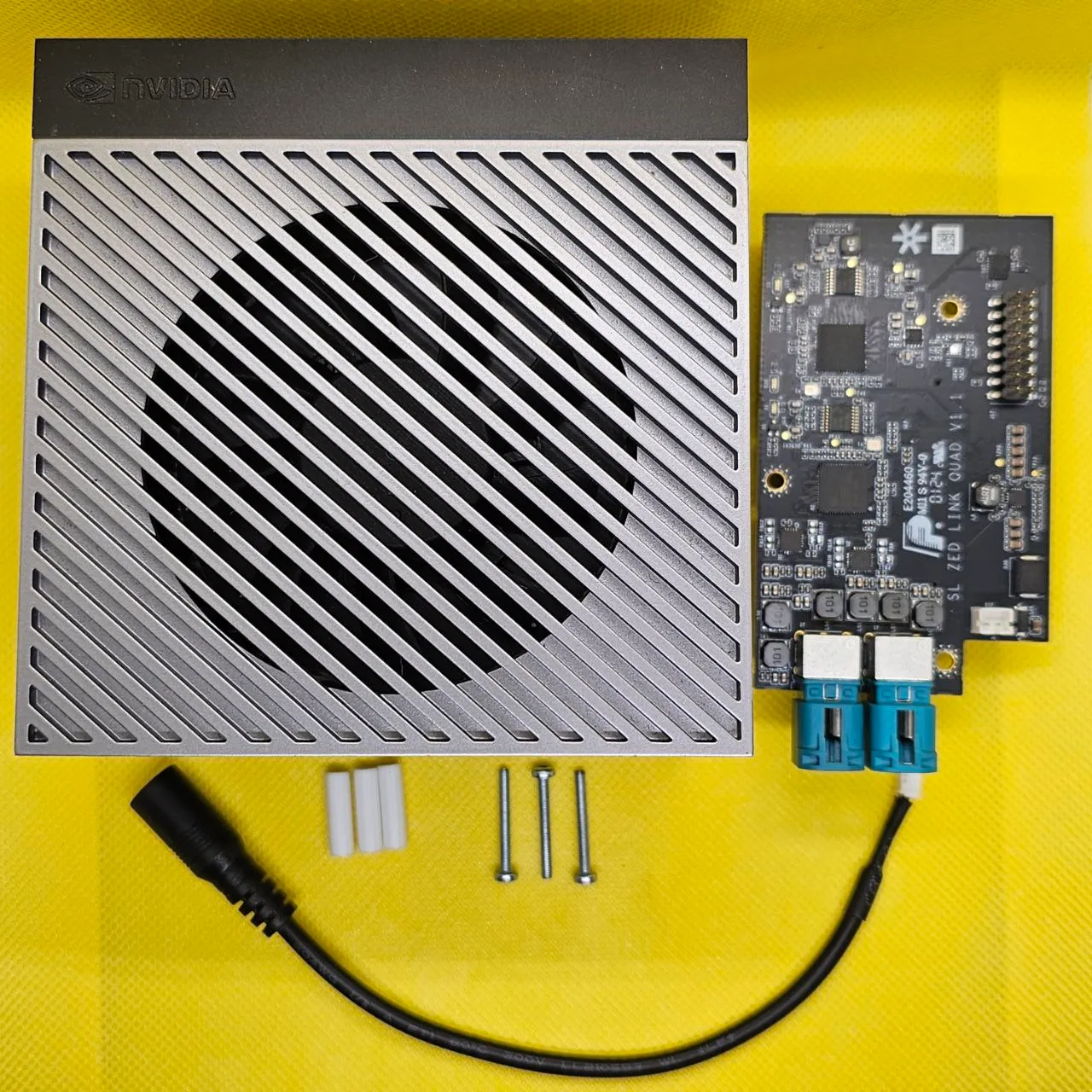

This tutorial will help you set up the ZED Link Quad GMSL2 capture card, and use the StereoLabs GMSL2 cameras with the NVIDIA® Jetson™ AGX Orin Developer Kit.
  • 1x NVIDIA® Jetson™ AGX Orin Developer Kit.
  • 1x ZED Link Quad GMSL2 capture card
  • 2x 1-to-4 GMSL2 Fakra Male to Female cables (included in the box)
  • 9V-19V (min 6W) power input (Barrel Jack 5.5 mm outer diameter, 2.5 mm inner diameter) to power the GMSL2 capture card (not included)
  • [Optional] Enclosure for AGX Orin Developer Kit
ZED Link Quad on AGX Orin materials

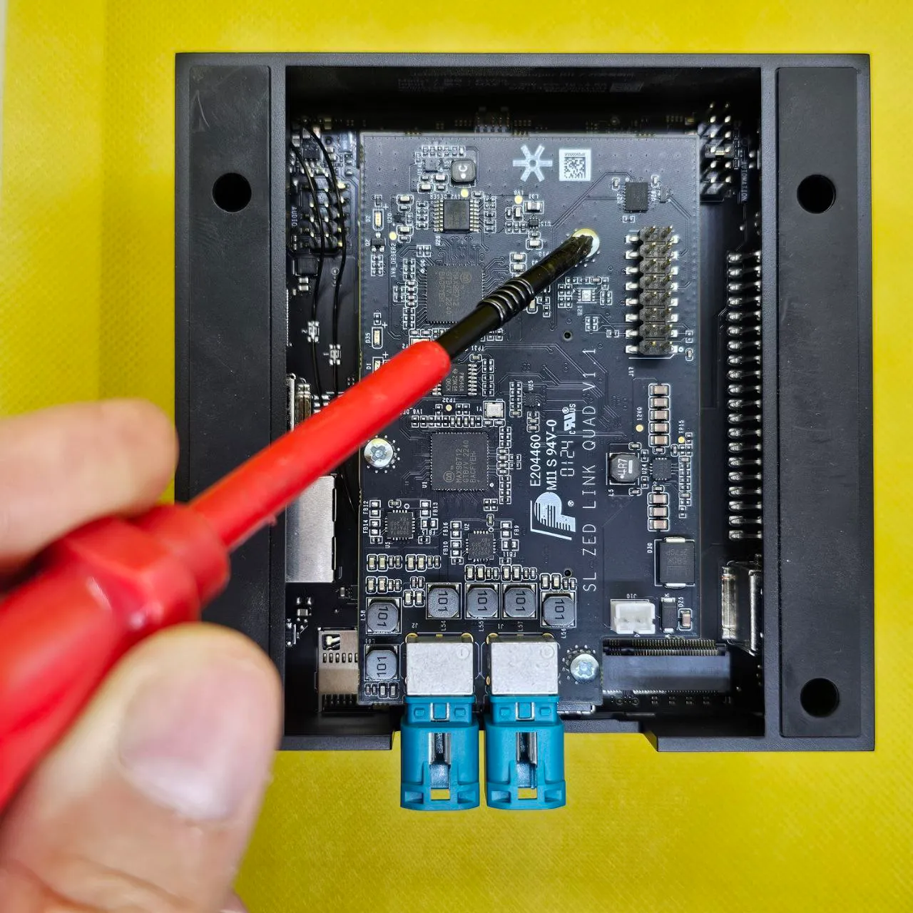

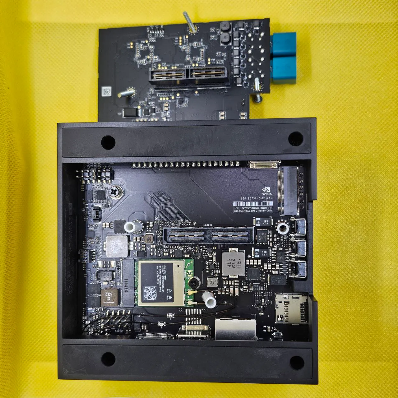

Plug the capture card into the ‘Camera connector’ slot and secure it using the three provided screws:
ZED Link Quad camera connector
ZED Link Quad screws installation

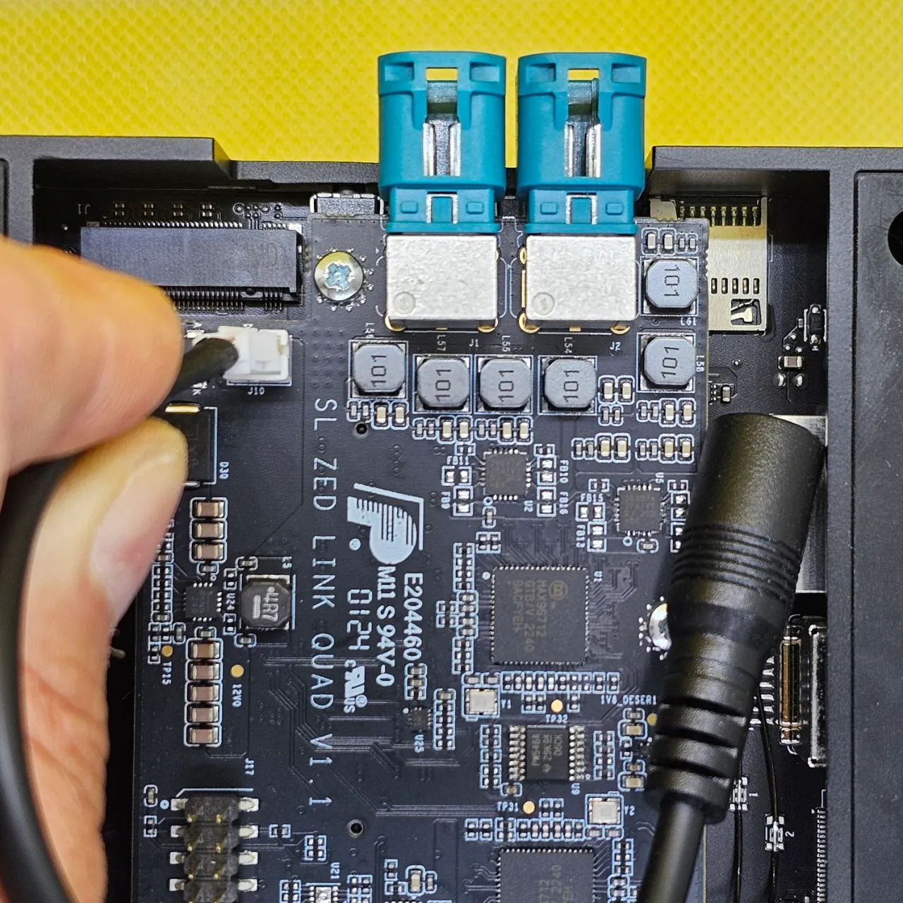

ZED Link Quad power connection

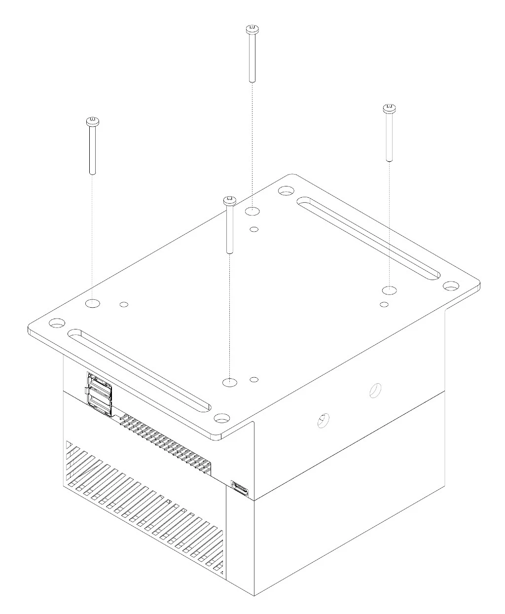

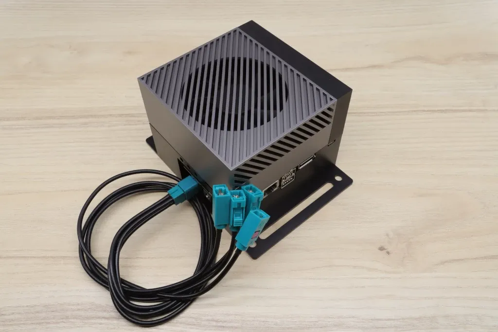

[Optional] AGX Orin Developer Kit Enclosure
If you are using an AGX Orin Developer Kit, we recommend you use the Enclosure for the AGX Orin Developer Kit, available in the StereoLabs store, to securely integrate our GMSL2 Capture Card while keeping the electronics safe. It also allows you to mount the Dev Kit on any surface using VESA 75x75, and gives the possibility to add WiFi antennas to boost your AGX Orin wireless transmissions.
AGX Orin with enclosure
AGX Orin enclosure installation

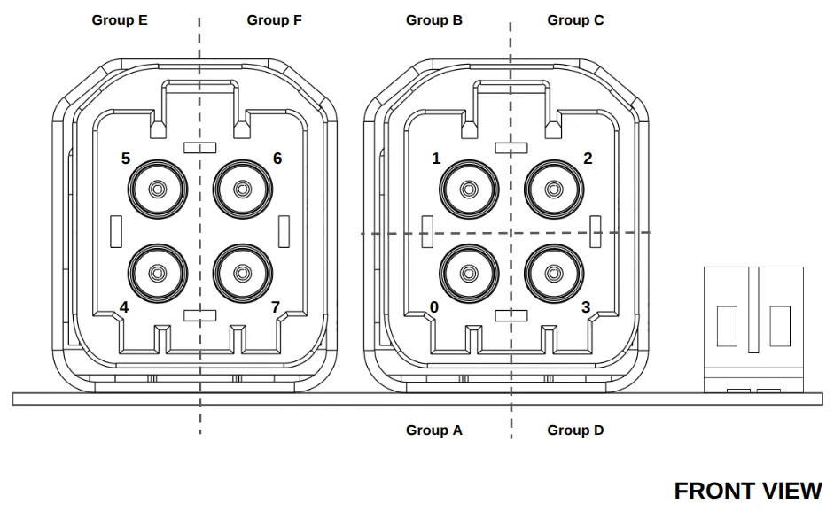

Multi-camera configurations
  • Group A: port #0
  • Group B: port #1
  • Group C: port #2
  • Group D: port #3
  • Group E: ports #4 and #5
  • Group F: ports #6 and #7
ZED Link Quad connections
per Group
Max Resolution/FPS
per Group
MonocularZED X One GS
ZED X One S
Up to 2 camerasHD1200@60fps
HD1080@60fps
SVGA@120fps
MonocularZED X One 4K1 camera
only to port #0, #2, #4, #6
4K@15fps
QHDPLUS@15fps
HD1200@60fps
HD1080@60fps
StereoZED X
ZED X Mini
ZED X Nano
1 CameraHD1200@60fps
HD1080@60fps
SVGA@120fps
StereoZED X
ZED X Mini
ZED X Nano
Up to 2 CamerasHD1200@30fps
HD1080@30fps
SVGA@60fps
MixedZED X One GS/ZED X One S
ZED X/ZED X Mini/ZED X Nano
1 ZED X One GS/S + 1 ZED X/Mini/NanoHD1200@60fps
HD1080@60fps
SVGA@120fps

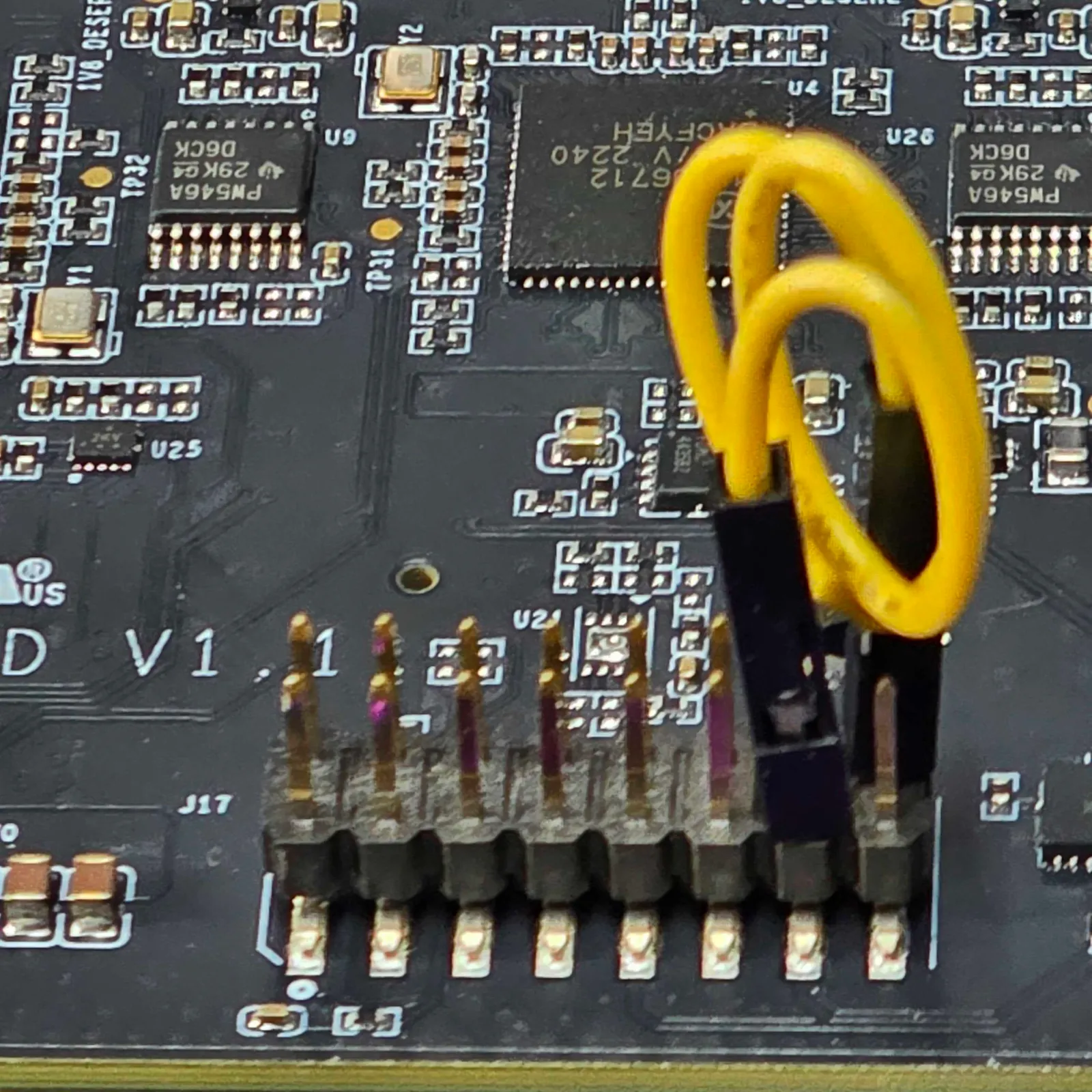

Enable full onboard synchronization
The ZED Link Quad card is essentially a composition of two ZED Link Duo cards. By default, the two GMSL2 deserializers on the card are not synchronized together, causing the cameras connected to one 4-wire GMSL2 Fakra connector to have different capture timestamps from the cameras connected to the second 4-wire GMSL2 Fakra connector. To enable full synchronization, you must follow this procedure:
  • Open a terminal (Ctrl+Alt+T)
  • Edit the zed_x_daemon service file:
    sudo nano /etc/systemd/system/zed_x_daemon.service
    • Search for sync_mode=<x> and change it to sync_mode=1
    • Save the file and exit (Ctrl+X, Y, Enter)
  • Instruct systemd to reload all service files and update its internal configuration
    sudo systemctl daemon-reload
  • Connect the pin #13 to the pin #16 of the synchronization connector.
    ZED Link Quad J17 sync connector
    It’s not required to connect the GND pins together as they are already connected internally on the board.
  • Restart the zed_x_daemon service
Although frames are hardware-synchronized with 15µs precision, software timestamps are assigned upon driver receipt and may exhibit slight millisecond-level jitter. Frames are considered synchronized if the timestamp difference is less than one frame period (1000/FPS ms).
