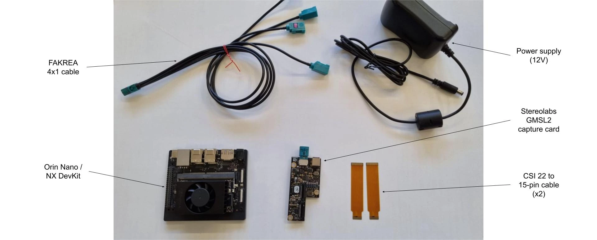

  • 1x NVIDIA® Jetson™ Orin Nano Developer Kit or NVIDIA® Jetson™ Orin Nano Developer Kit mounting an Orin NX module.
  • 1x ZED Link Duo GMSL2 capture card
  • 1x 1-to-4 GMSL2 Fakra Male to Female cable (included in the box)
  • 2x FPC Camera Cable 22-pin 0.5mm Pitch to 15-pin 1.0mm Pitch (not included)
  • 9V-19V (min 2W) power input (Barrel Jack 5.5 mm outer diameter, 2.5 mm inner diameter) to power the GMSL2 capture card (not included)

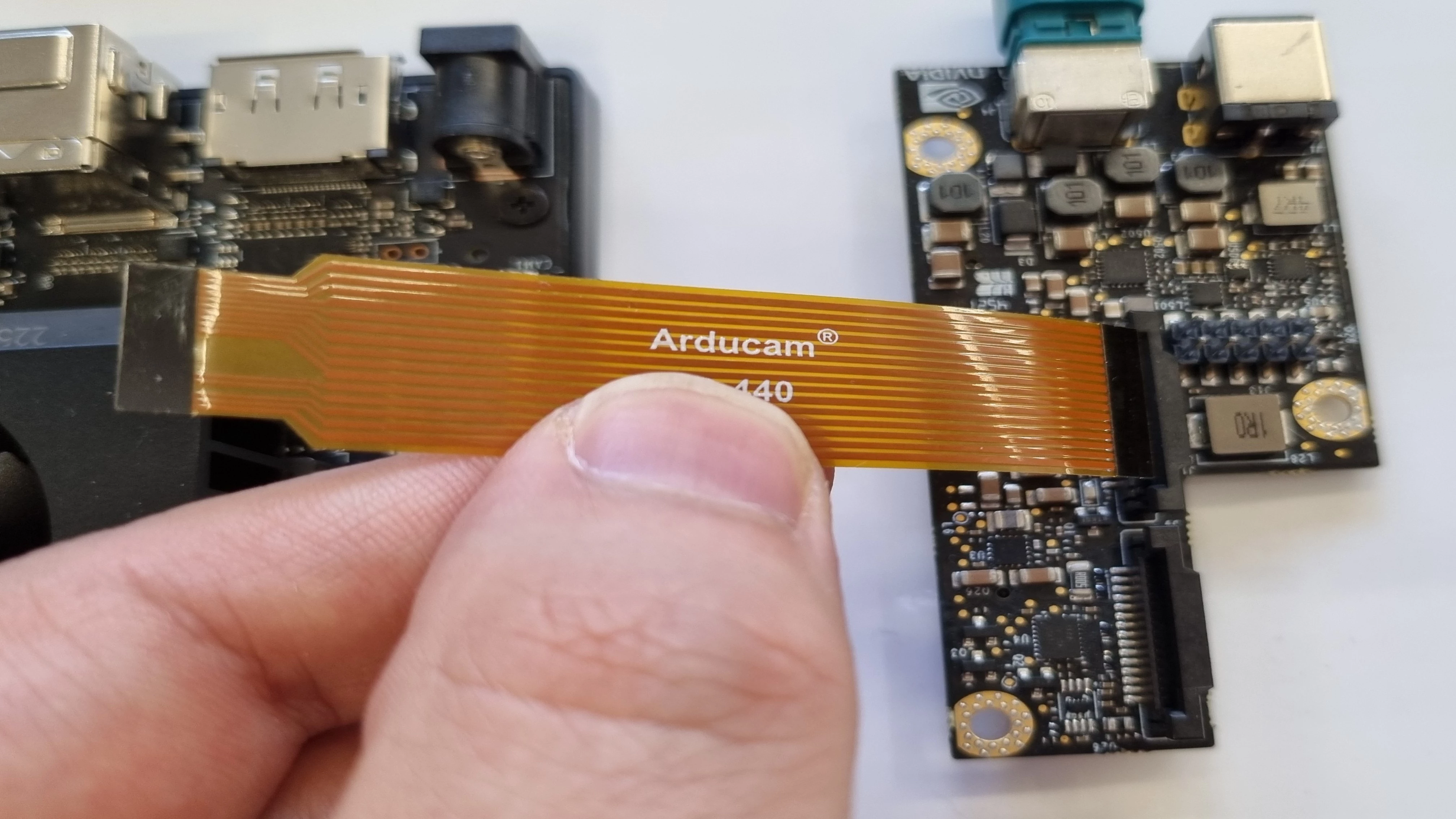

Connect both CSI cables to the MIPI 15-pin ports of the capture card. Make sure the correct side is plugged in for each port.
Orin Devkit Capture Card Cabling
Both MIPI cables must be connected to have access to 2x ZED X on the capture card.

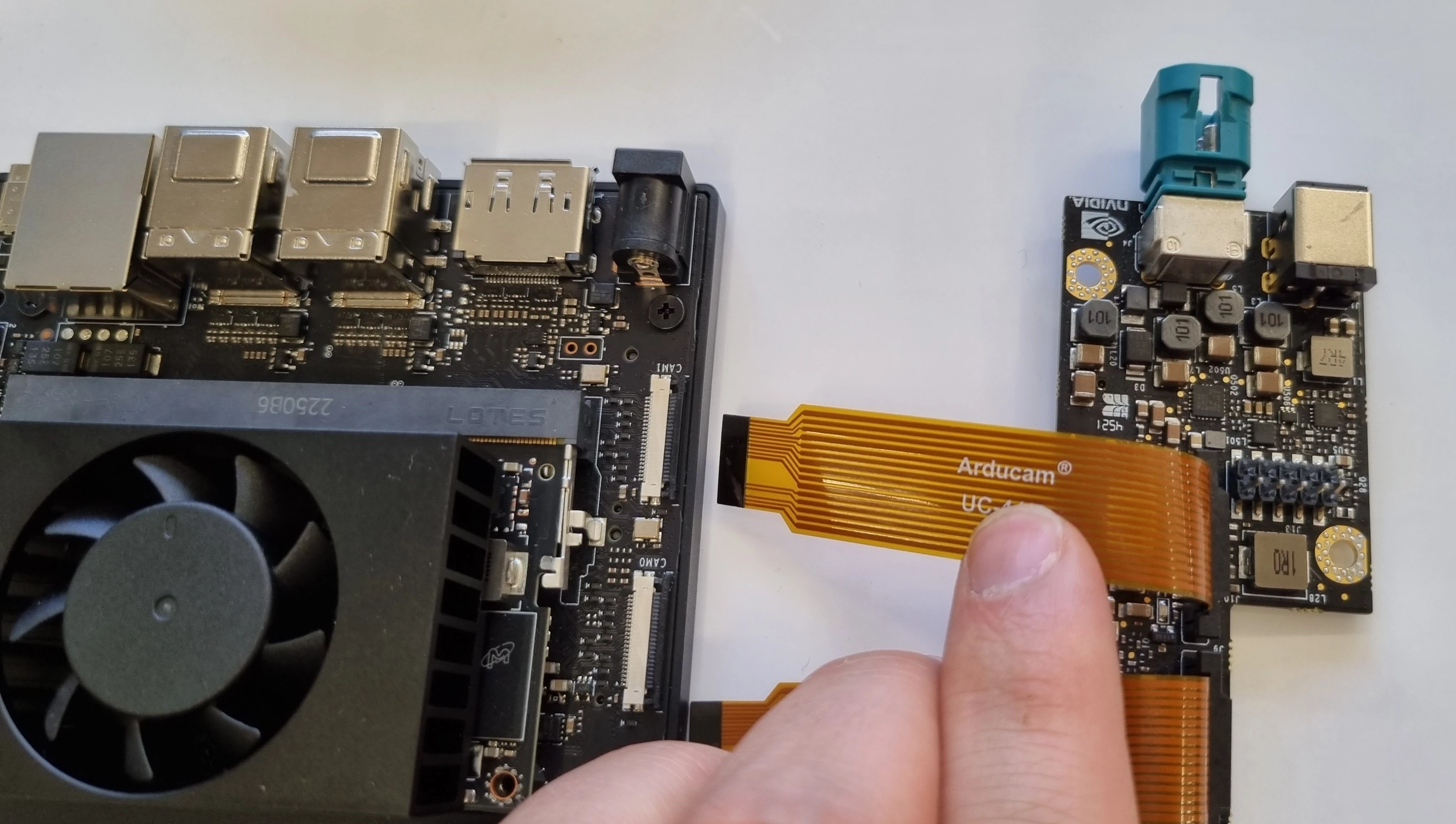

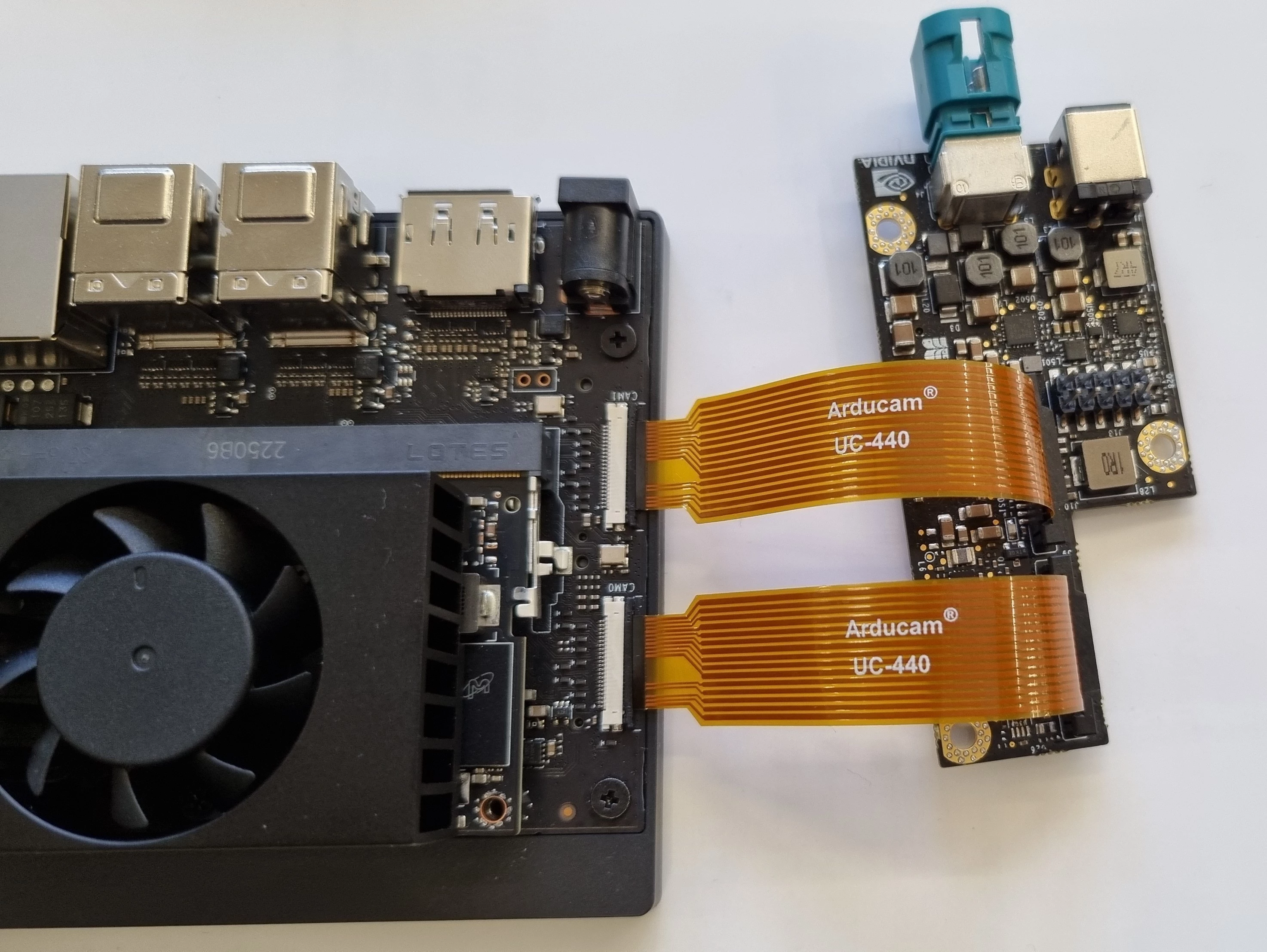

Cabling the Carrier Board
Make sure that CAM1 is connected to the centered MIPI port of the GMSL2 capture card.
CAM0 must be connected to the MIPI port close to the edge.
Orin Devkit Carrier Board Cabling
Once connected, the setup should look like the following picture:
Orin Devkit Cabled

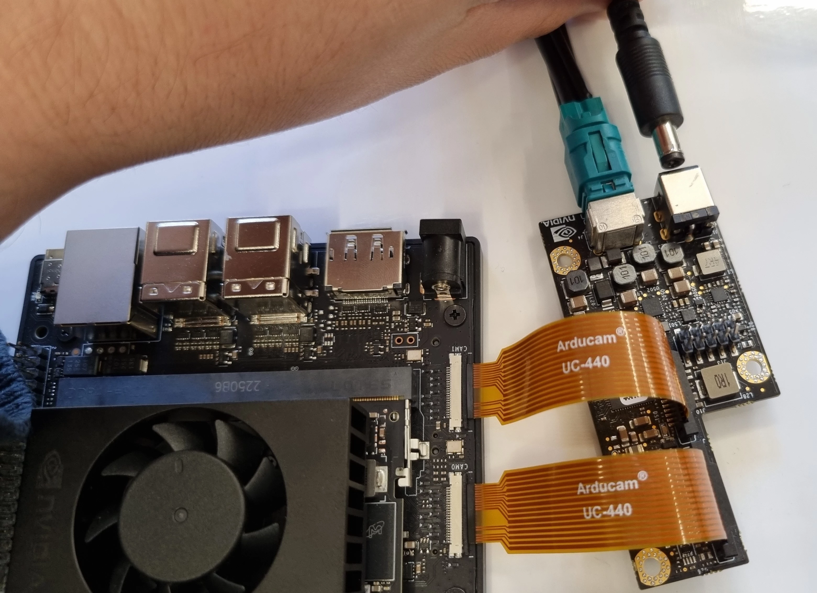

Connect the camera
Connect the GMSL2 Fakra cable female end to your ZED X. When you hear a click, the cable is securely connected to the camera.
ZED X with Fakra Cable
Orin Devkit Plug Camera

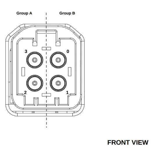

Multi-camera configurations
ZED Link Duo Connections
per Group
Max Resolution/FPS
per Group
