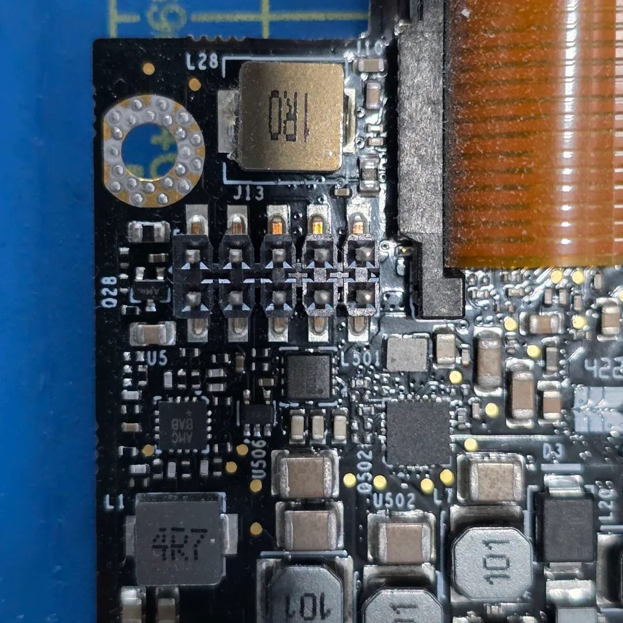

The ZED Link Duo GMSL2 capture card allows you to synchronize external sensors by using triggering signals on the 10-pin 2mm pitch GPIO connector J13.

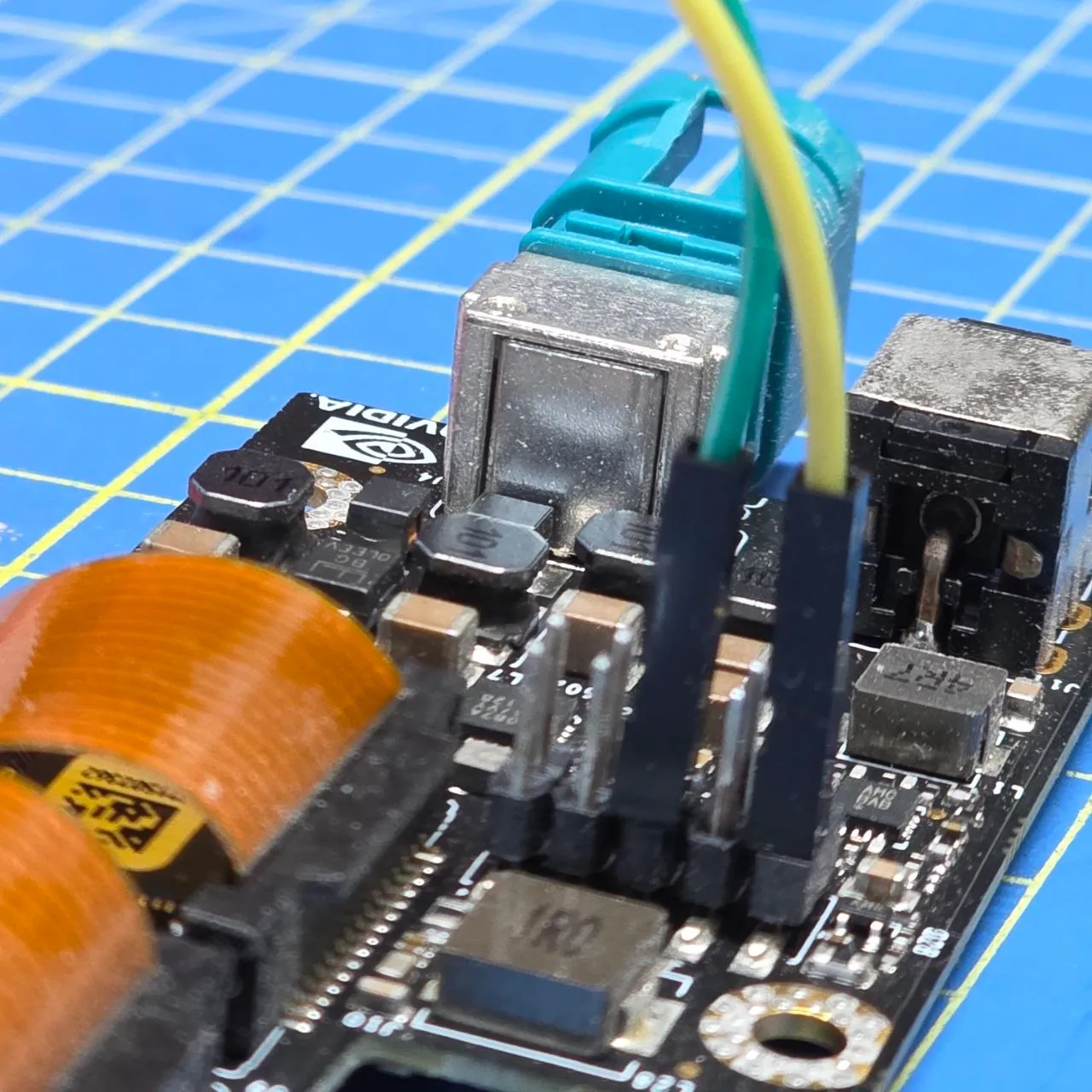

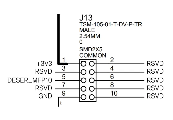

The output synchronization signal is available on pin #5 of the GPIO connector J13 as soon as the Jetson™ device boots and the ZED Link GMSL2 driver is installed.
  • Connect the ground signal (Yellow - GND) to pin #9.
  • Connect the trigger out signal (Green - MFP0) to pin #5.

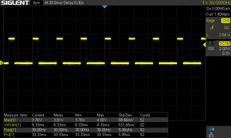

Triggering signal
The output trigger signal is a square wave, with its rising edge synchronized with the end of the exposure phase of the CMOS sensor.
The signal has a fixed Amplitude of 3.75V +/- 12%, while Width and Frequency change according to the frame rate setting of the camera.
Frame rate: 120 FPS - ZED X / ZED X Mini / ZED X Nano / ZED X One GS / ZED X One S
  • Amplitude: 3.75V +/- 12%
  • Width: 2.08 msec
  • Frequency: 120 Hz
  • Period: 8.33 msec

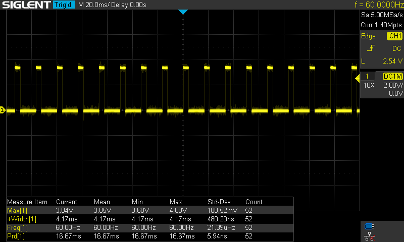

Frame rate: 60 FPS - ZED X / ZED X Mini / ZED X Nano / ZED X One GS / ZED X One S / ZED X One 4K
  • Width: 4.17 msec
  • Frequency: 60 Hz
  • Period: 16.67 msec
Frame rate: 30 FPS - ZED X / ZED X Mini / ZED X Nano / ZED X One GS / ZED X One S / ZED X One 4K
  • Width: 8.33 msec
  • Frequency: 30 Hz
  • Period: 33.33 msec

  3. Connect PIN #9 (GND) to the ground signal of the trigger source.
  4. Connect PIN #5 (DESER - MFP10) to the trigger input signal, i.e., a 3.3V square wave signal.

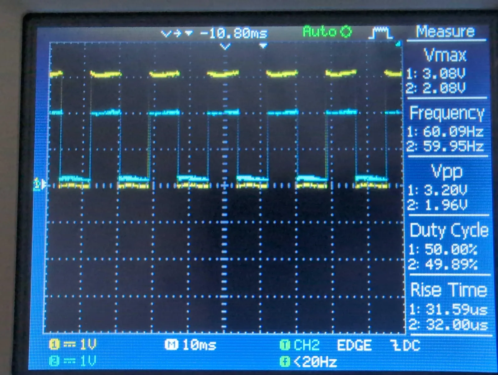

You must use an external trigger signal with the following characteristics:
  • Square wave
  • Amplitude: 3.3V +/- 10%
  • Frequency: Match the camera grab frame rate setting used with the ZED SDK - 15Hz, 30Hz, 60Hz, or 120Hz
