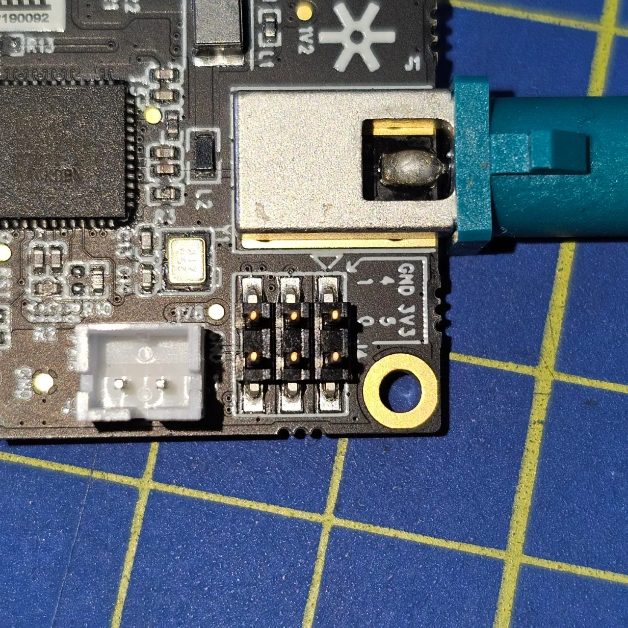

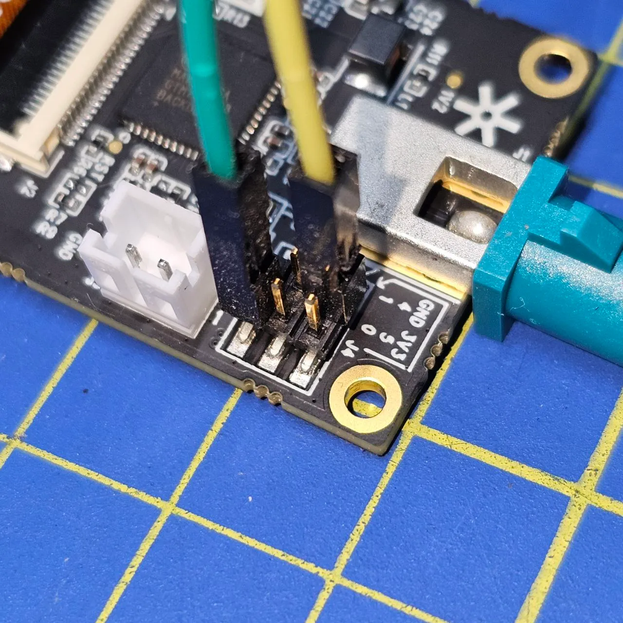

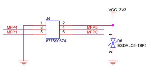

The output synchronization signal is available on pin #6 of the GPIO connector J4 as soon as the Jetson™ device boots and the ZED Link GMSL2 driver is installed.
  • Connect the ground signal (Yellow - GND) to pin #1.
  • Connect the trigger out signal (Green - MFP0) to pin #6.

  3. Connect PIN #1 (GND) to the ground signal of the trigger source.
  4. Connect PIN #5 (TRIG_IN - MFP1) to the trigger input signal, i.e., a 3.3V square wave signal.

  3. Connect together the PIN #1 (GND) of both ZED Link Mono cards.
  4. Connect the PIN #6 (TRIG_OUT - MFP0) of the first card to the trigger input signal PIN #5 (TRIG_IN - MFP1) of the second card.
