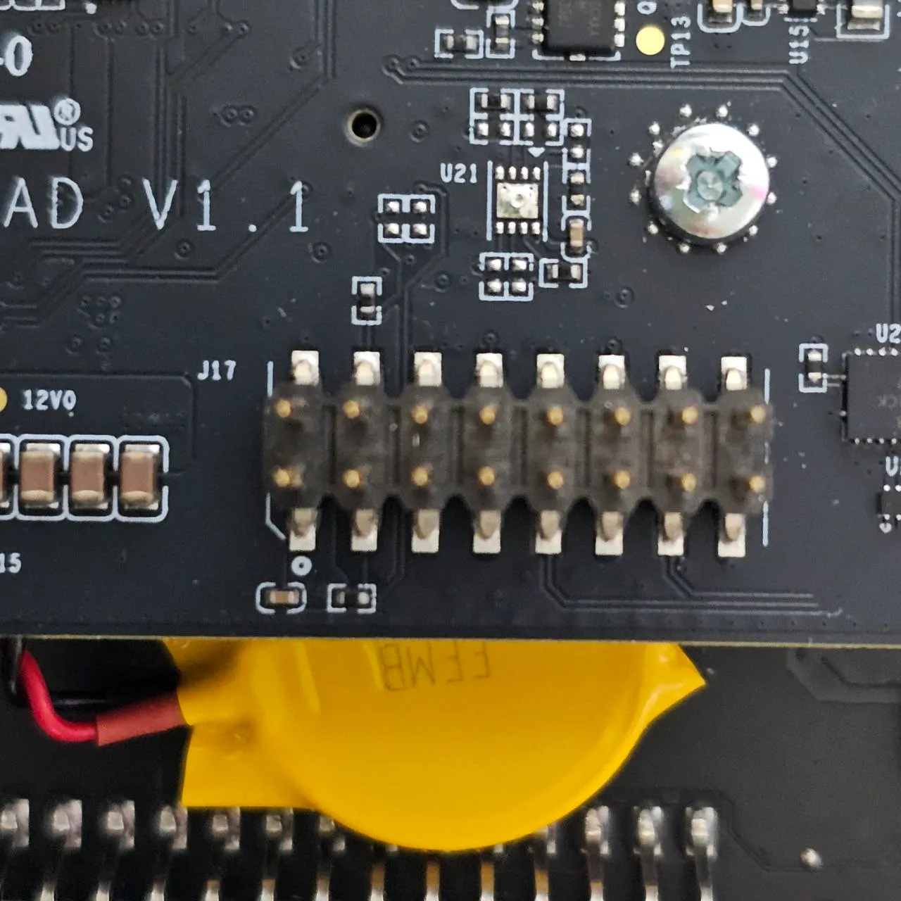

The ZED Link Quad GMSL2 capture card allows you to synchronize external sensors by using triggering signals on the 16-pin 2.54mm pitch GPIO connector J17.

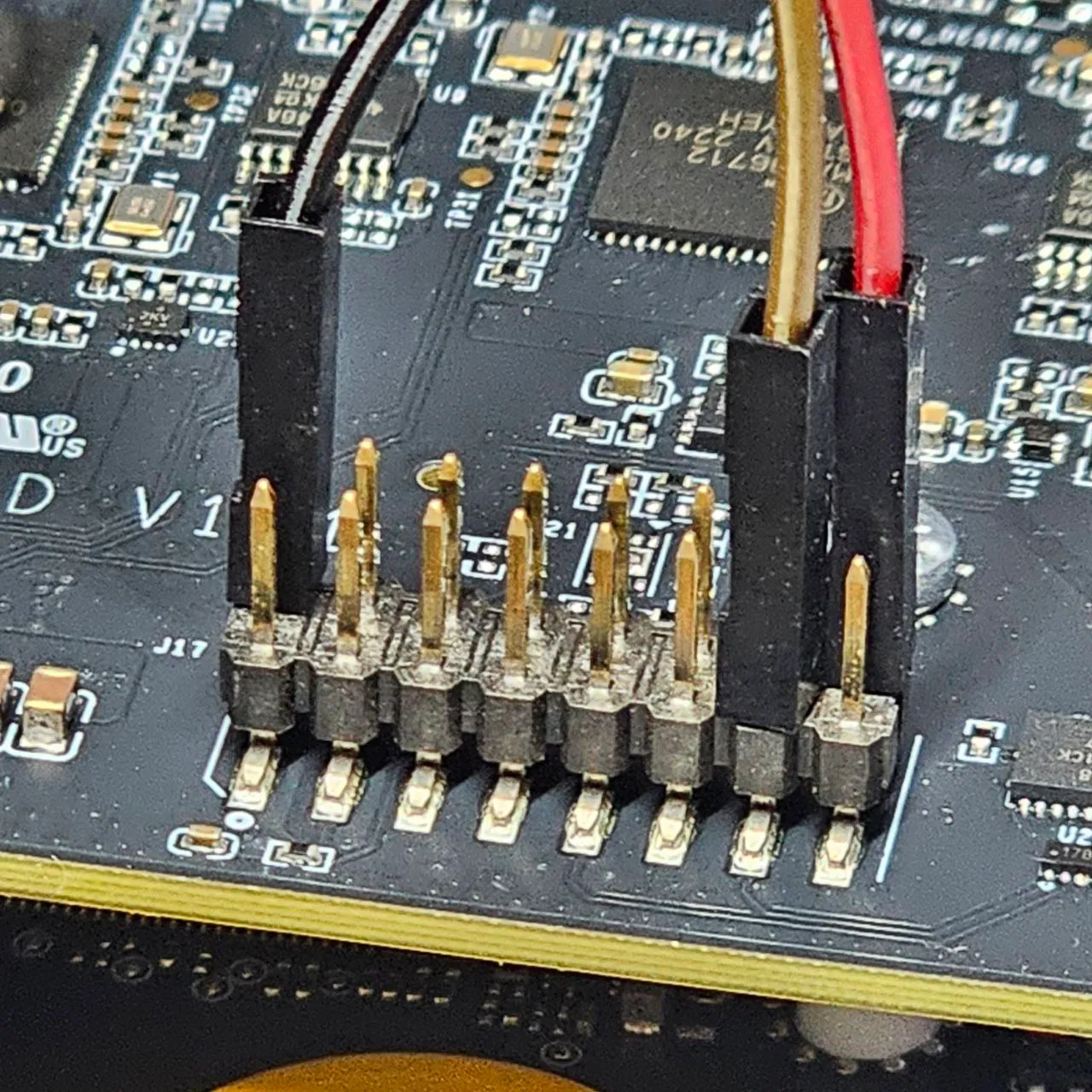

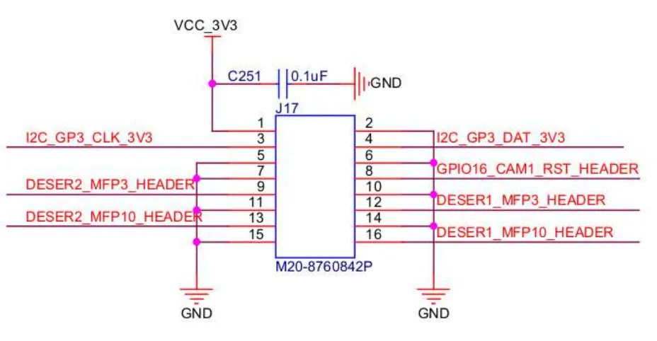

The output synchronization signals are available on pin #16 and pin #13 of the GPIO connector J17 as soon as the Jetson™ device boots and the ZED Link GMSL2 driver is installed.
  • Connect the ground signal (Black - GND) to pin #2
  • Connect the trigger out signal of the GMSL2 port J1 (Red - DESER1_MFP10) to pin #16
  • Connect the trigger out signal of the GMSL2 port J2 (Brown - DESER2_MFP10) to pin #13

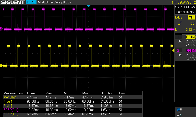

Frame rate: 60 FPS - ZED X / ZED X Mini / ZED X Nano / ZED X One GS / ZED X One S / ZED X One 4K
  • Amplitude: 3.3V ± 1%
  • Width: 4.17 msec
  • Frequency: 60 Hz
  • Period: 16.67 msec

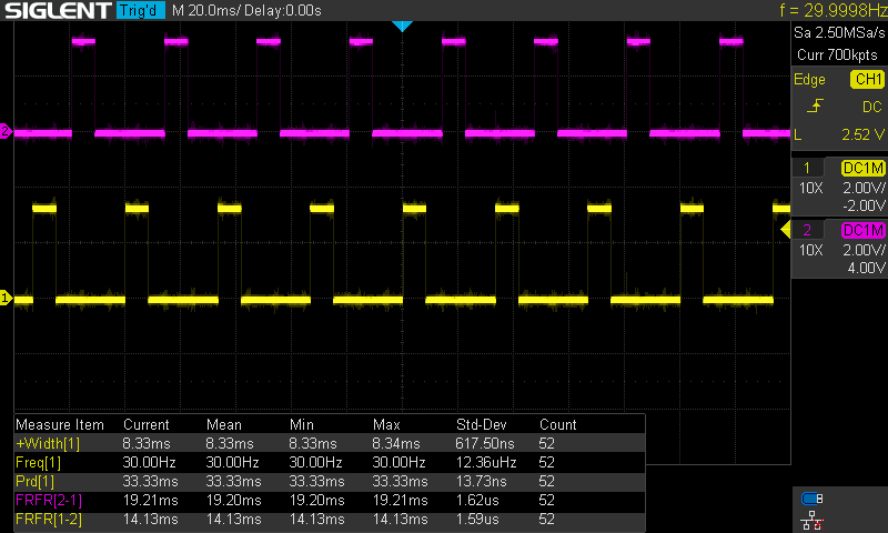

Frame rate: 30 FPS - ZED X / ZED X Mini / ZED X Nano / ZED X One GS / ZED X One S / ZED X One 4K
  • Width: 8.33 msec
  • Frequency: 30 Hz
  • Period: 33.33 msec

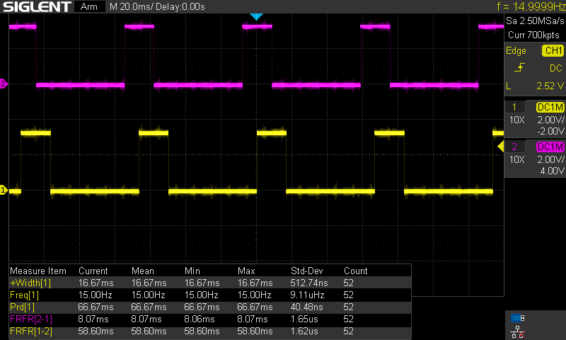

  • Frequency: 15 Hz
  • Period: 66.67 msec

  3. Connect PIN #2 (GND) to the ground signal of the trigger source.
  4. Connect PIN #13 (DESER2_MFP10_HEADER) and PIN #16 (DESER1_MFP10_HEADER) to the trigger input signal, i.e., a 3.3V square wave signal.
