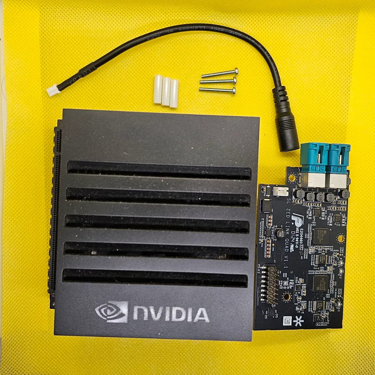

- 1x NVIDIA® Jetson™ AGX Xavier Developer Kit.
- 1x ZED Link Quad GMSL2 capture card
- 2x 1-to-4 GMSL2 Fakra Male to Female cables (included in the box)
- 1x NVIDIA® power supply to power the Development Kit (included with the devkit)

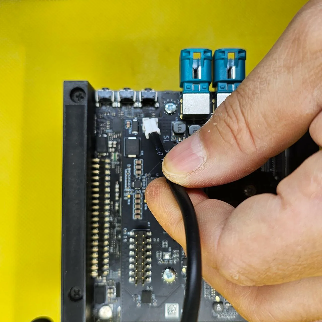

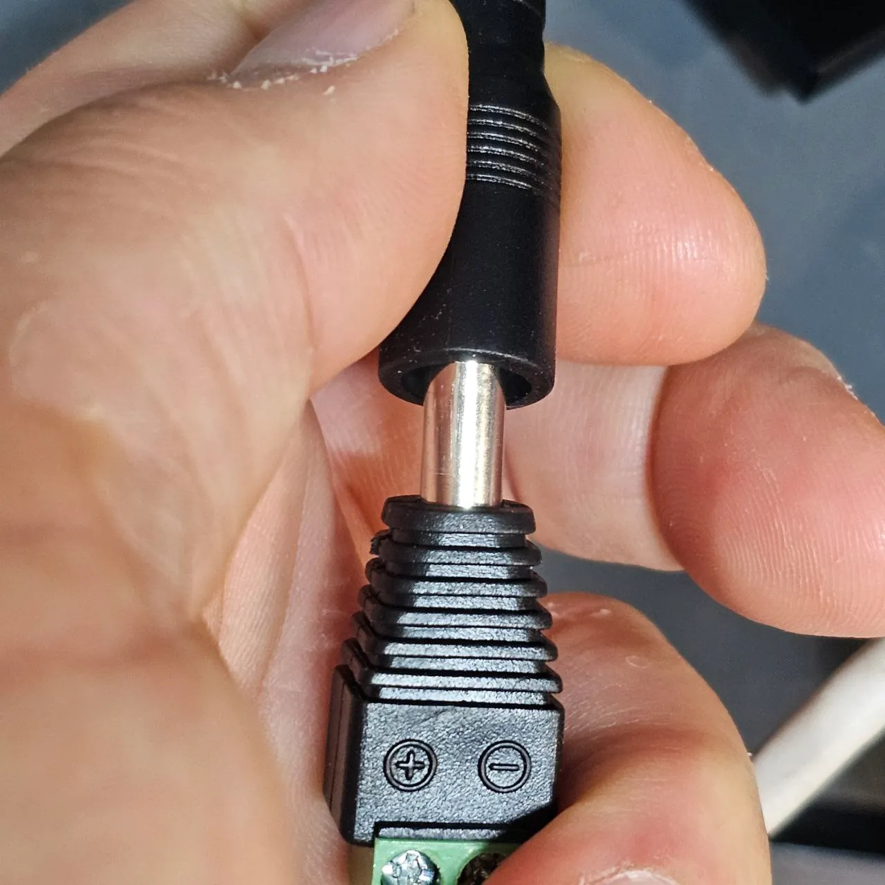

- 9V-19V (min 6W) power input (Barrel Jack 5.5 mm outer diameter, 2.5 mm inner diameter) to power the GMSL2 capture card (not included)

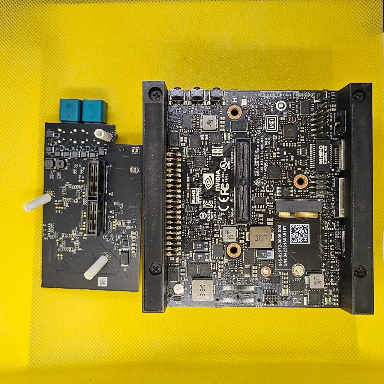

Plug the capture card into the ‘Camera connector’ slot and secure it using the three provided screws:

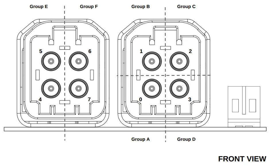

Multi-camera configurations
- Group A: port #0
- Group B: port #1
- Group C: port #2
- Group D: port #3
- Group E: ports #4 and #5
- Group F: ports #6 and #7

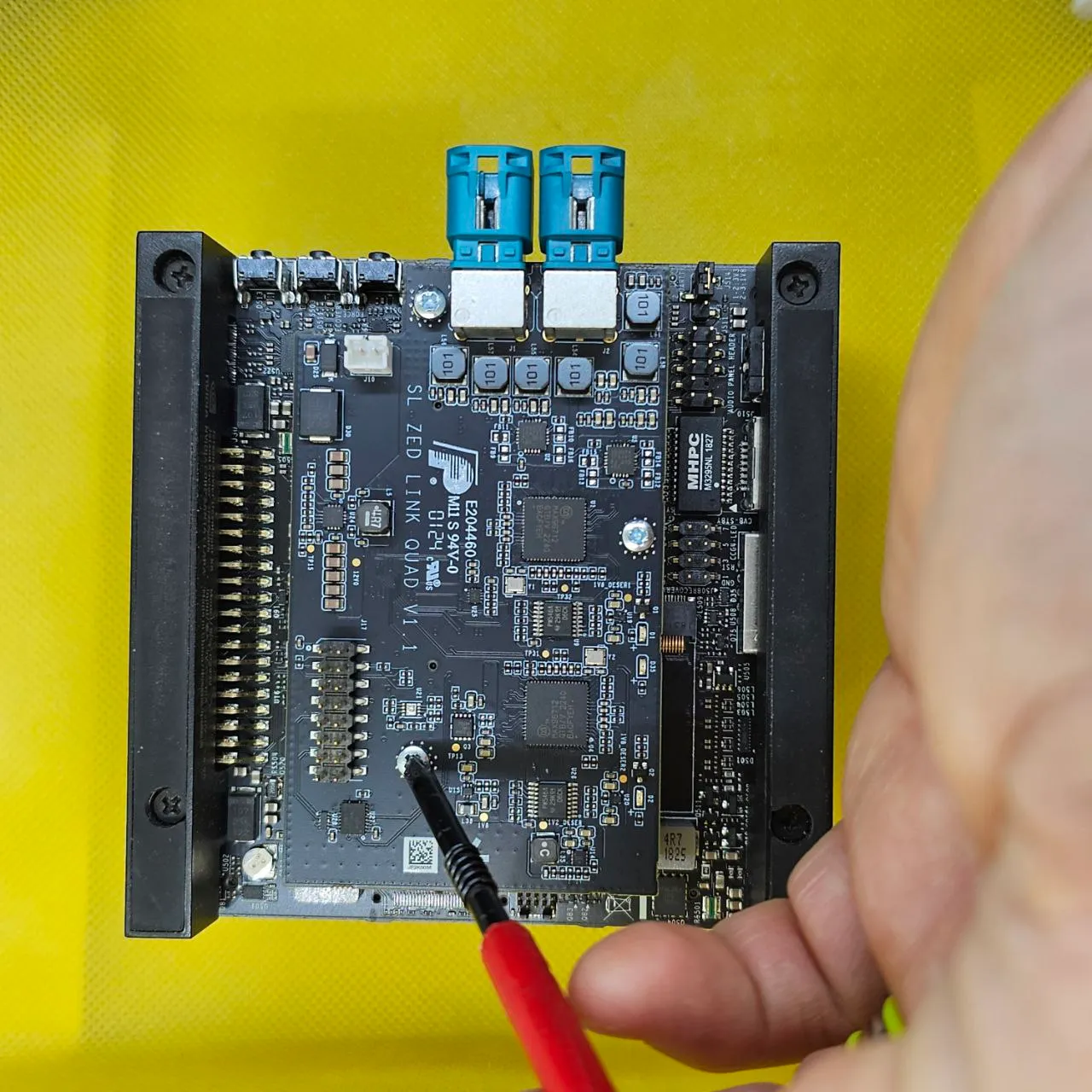

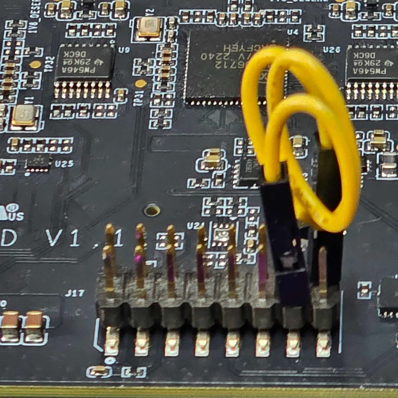

Connect the pin #13 to the pin #16 of the synchronization connector.
It’s not required to connect the GND pins together as they are already connected internally on the board.
