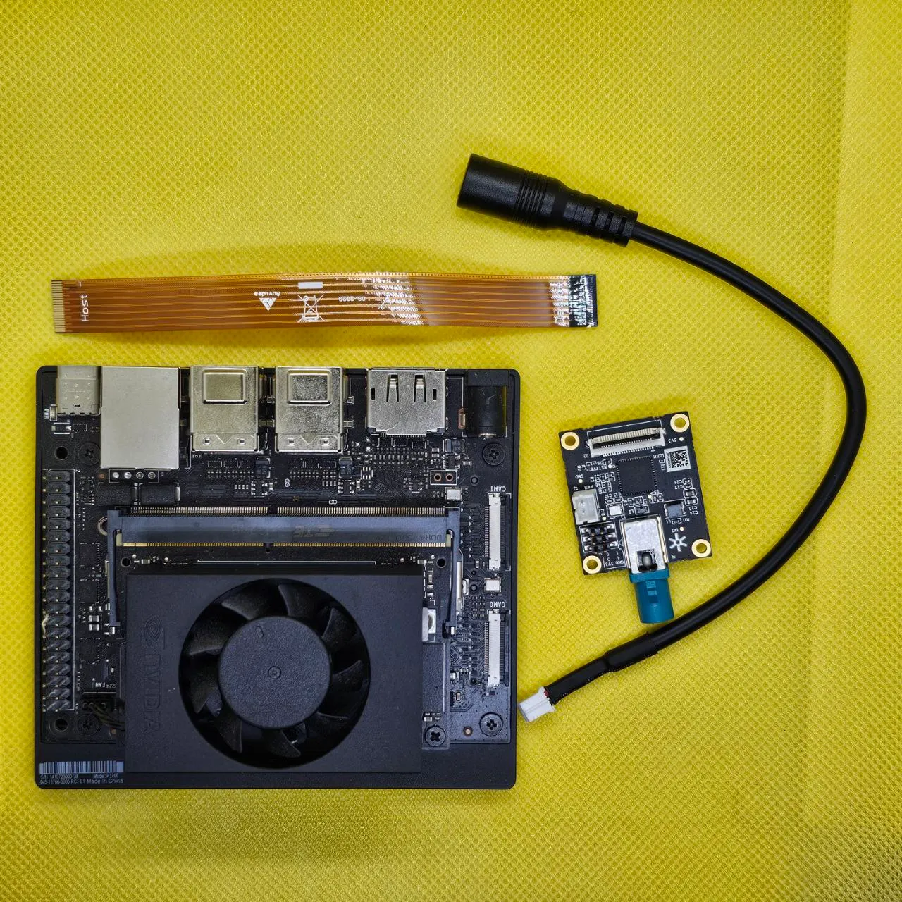

  • 1x NVIDIA® Jetson™ Orin Nano Developer Kit or NVIDIA® Jetson™ Orin Nano Developer Kit mounting an Orin NX module.
  • 1x ZED Link Mono GMSL2 capture card
  • 1x FPC Camera Cable 22-pin 0.5mm Pitch (included in the box)

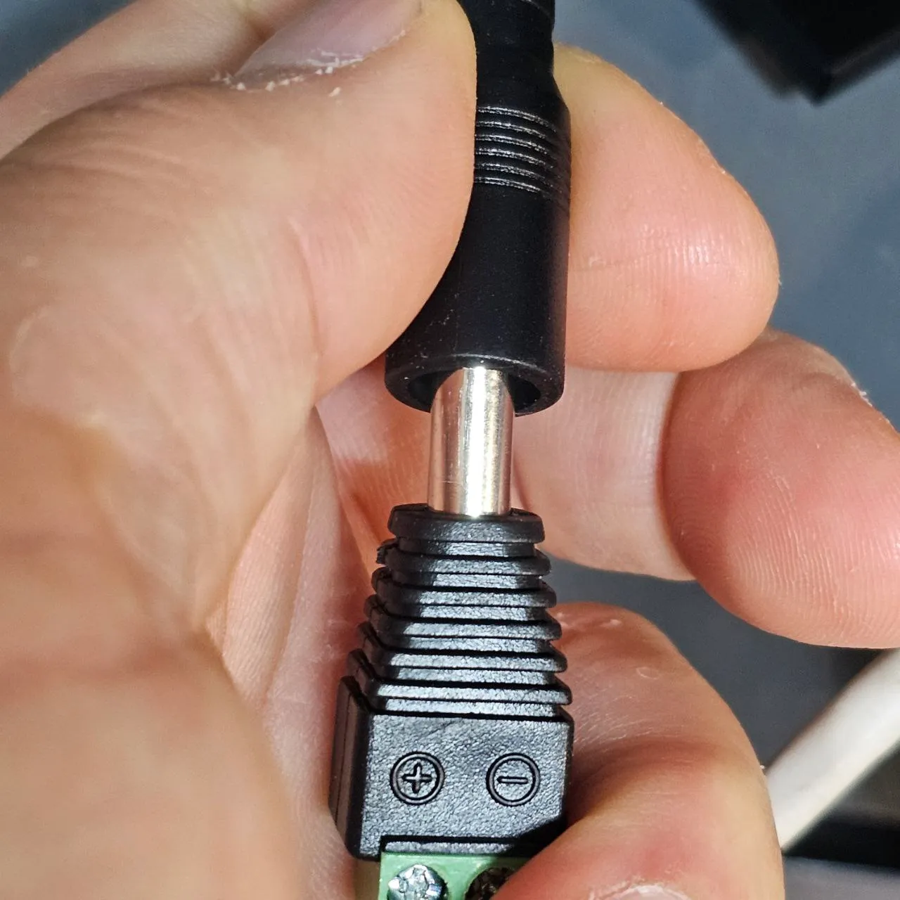

  • 9V-14V (min 2W) power input (Barrel Jack 5.5 mm outer diameter, 2.5 mm inner diameter) to power the GMSL2 capture card (not included)

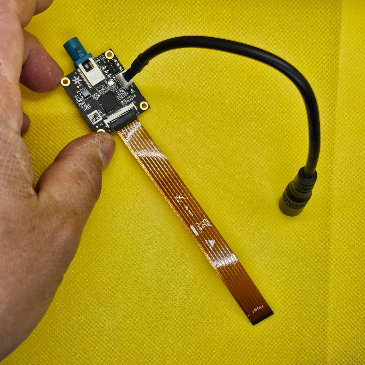

MIPI cables transmit video signals. As the cable length increases, the video signal becomes noisier. The maximum recommended length is 12 cm.
ZED Link Mono Orin Nano material
ZED Link Mono Orin Nano power

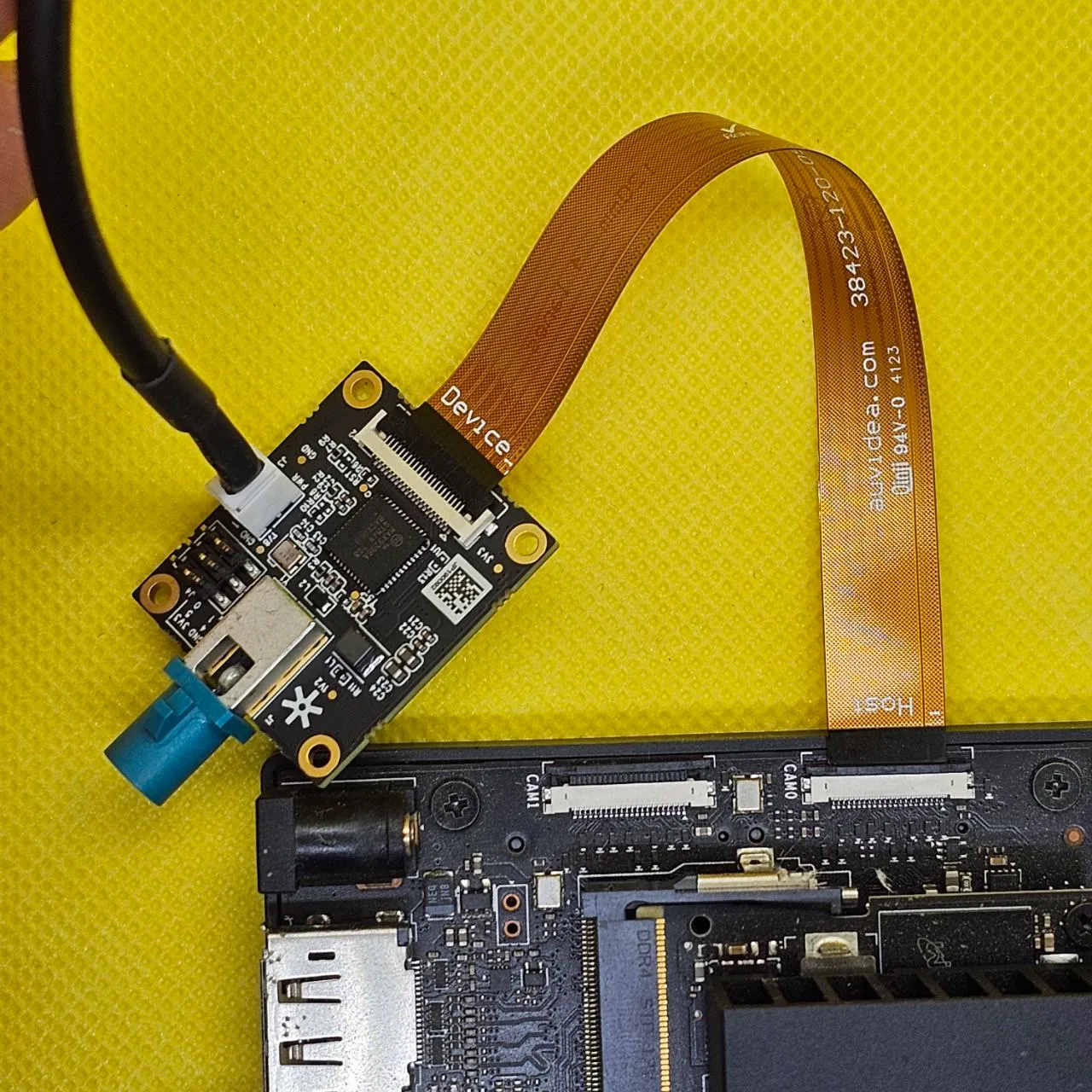

Connect the CSI cable to the MIPI 22-pin port of the capture card. Make sure the correct side is plugged in.
ZED Link Mono Orin Nano MIPI
Cabling the Carrier Board
ZED Link Mono Orin Nano MIPI carrier board connection

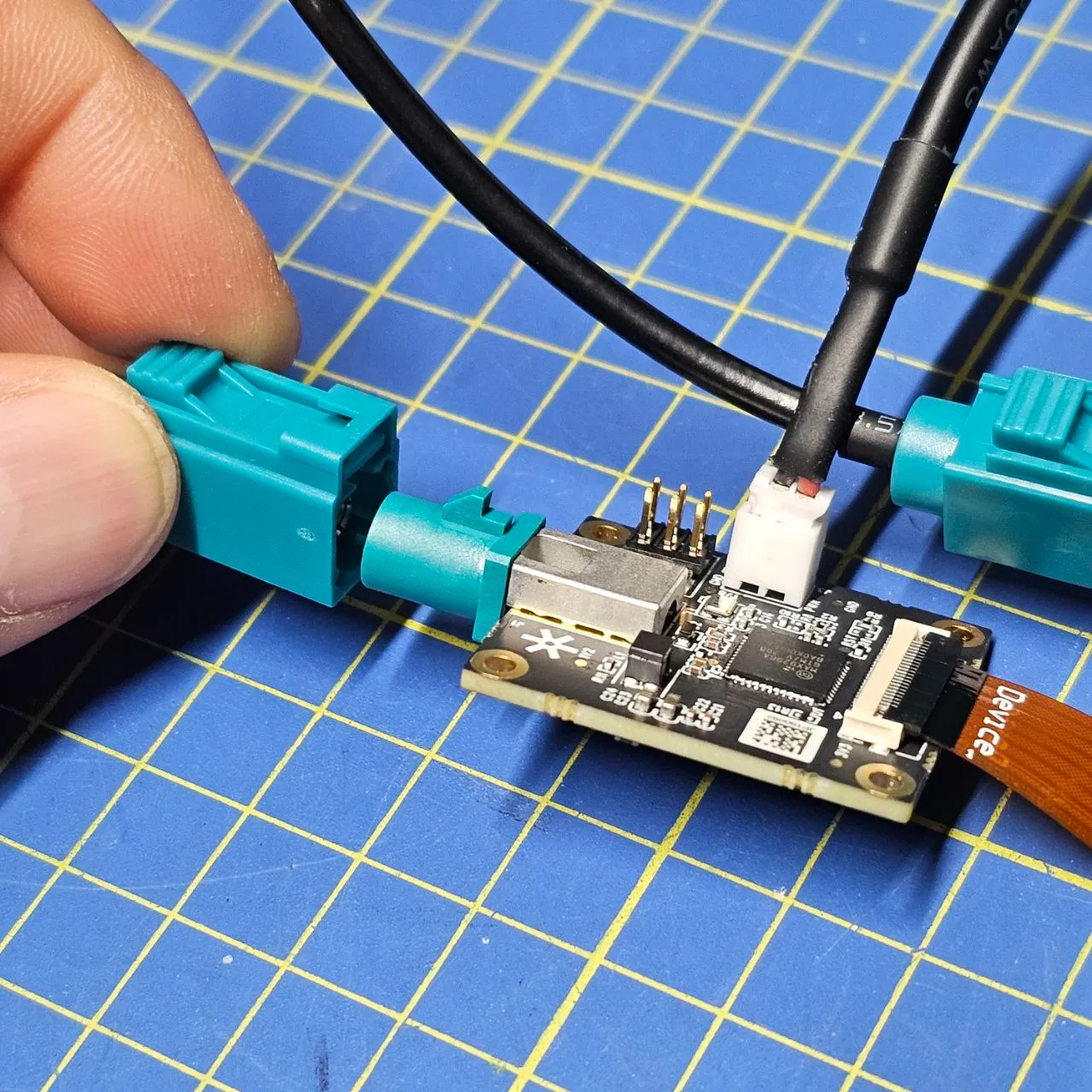

Connect the camera
ZED X camera with Fakra cable connected
ZED Link Mono Fakra cable connection

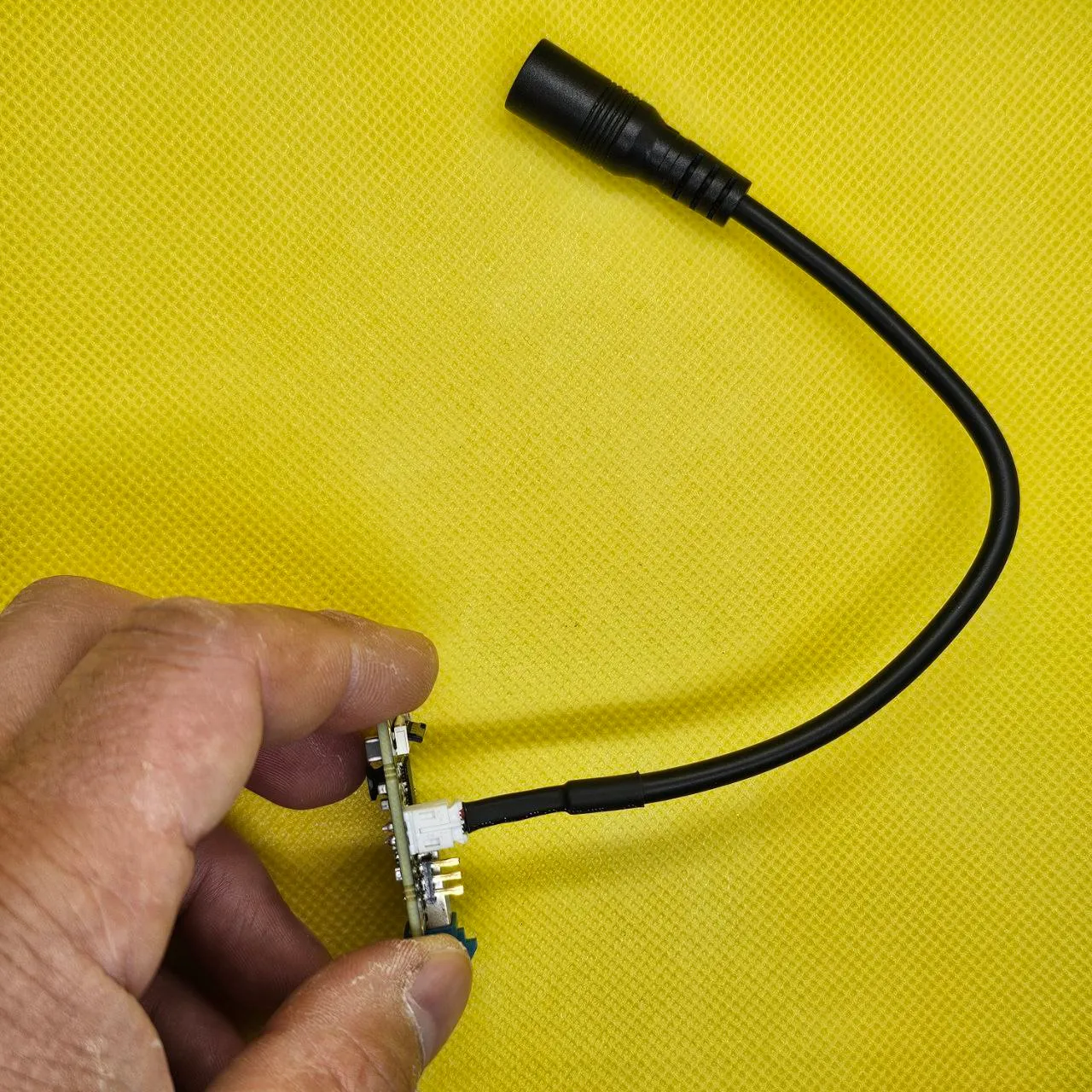

Once the cables are connected, plug the power for the GMSL2 capture card (9V-14V) so that cameras will be powered through the FAKRA cable (PoC).
Power adapter connection to ZED Link Mono
