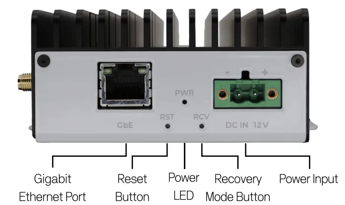

Front side
ZED Box Mini FrontMini Carrier Front

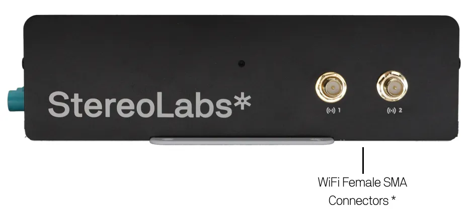

Left side
ZED Box Mini Left
  • [optional] Wi-Fi antenna connectors

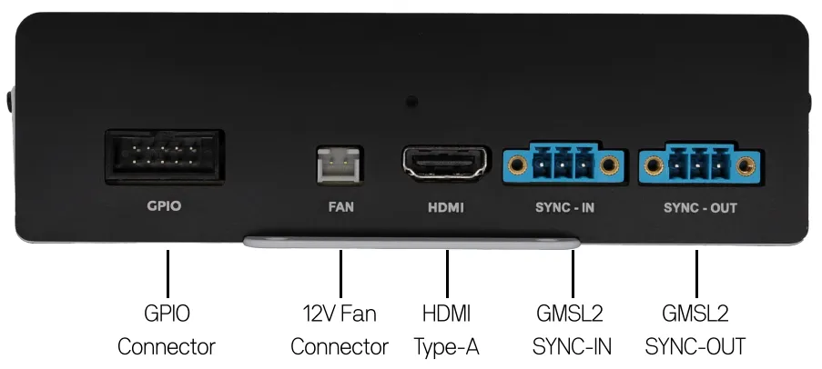

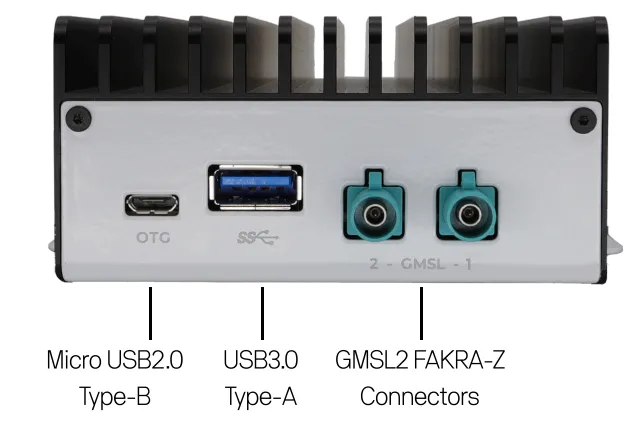

Rear side
ZED Box Mini RearMini Carrier Rear

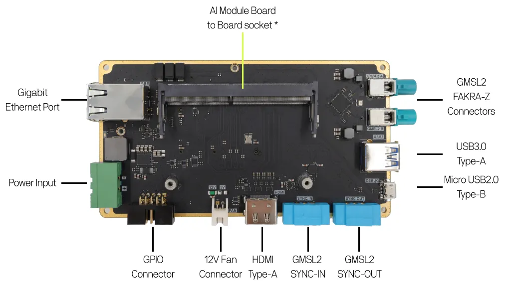

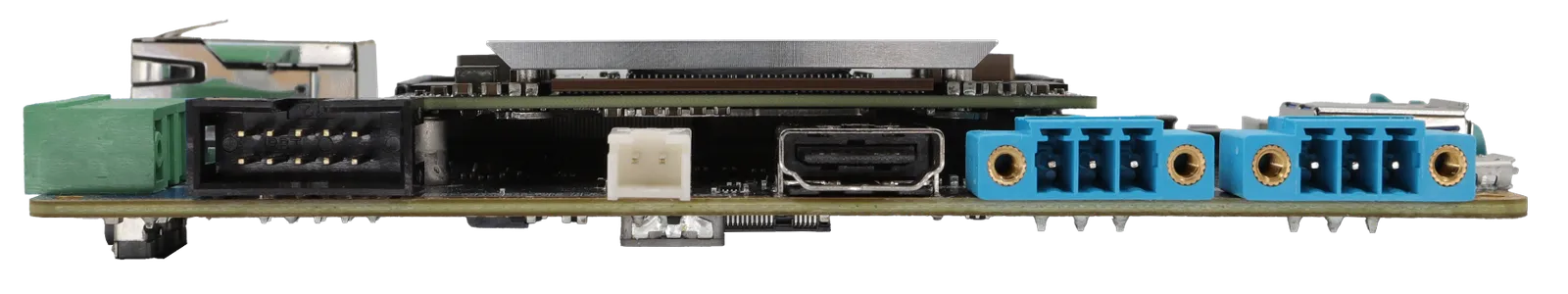

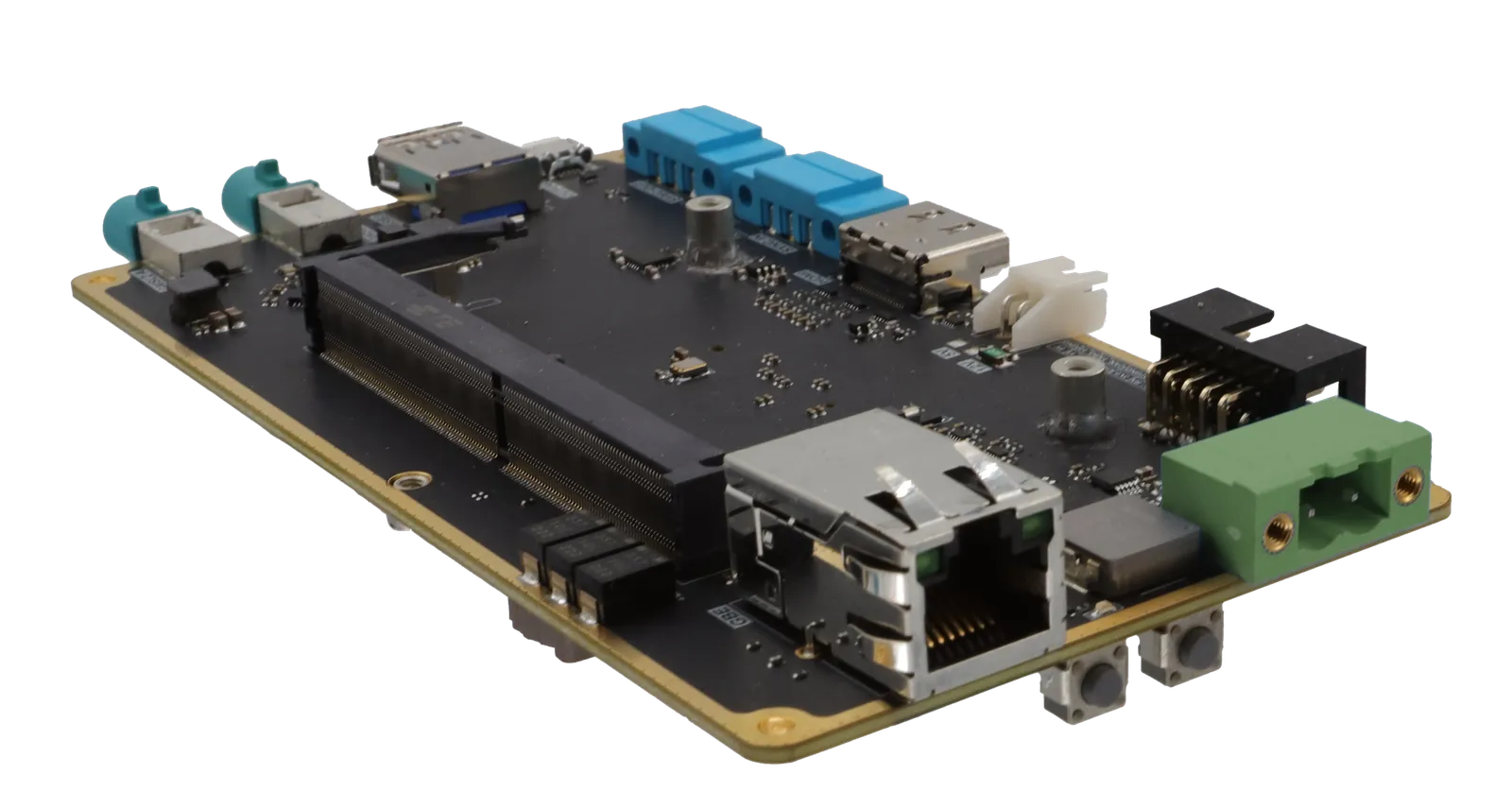

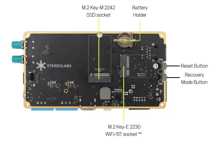

Carrier Board
Carrier TopCarrier Bottom
* [Optional] Orin NX and Orin Nano compute modules.
** [Optional] Intel AX210 Module or compatible.
Use a CR1220 coin cell battery to enable the system RTC.
If the device does not keep the date and time while powered off, the CR1220 RTC coin cell battery is discharged. Follow the battery replacement guide to replace it.

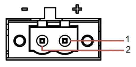

Power input
DC 10.5V to 13.5V - 60W max
Pinout Power
  • #1 - DC IN 12V
  • #2 - GND
Use the provided 12V 60W power supply or a regulated 12V input. A spare power adapter is available in the StereoLabs store.
Please ensure that the voltage of DC IN 12V is correct before connecting it to the system.
Supplying a voltage over 16V could damage the system.
Connector type: TBP01P1W-508-02GR
For battery power, we recommend using a 4S Lithium or Lithium Polymer battery with a 60W 12V DC-DC converter to guarantee a stable power voltage.

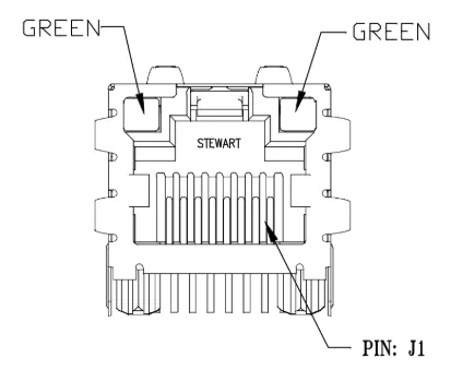

The ZED Box Mini series comes with one Gigabit Ethernet LAN port supporting 10/100/1000 BASE-T with an RJ45 connector. This connector is equipped with two green LEDs indicating LAN link and activity on this port.
Pinout LAN
  • #1 - MDI0_P [TX+]
  • #2 - MDI0_N [TX-]
  • #3 - MDI1_P [RX+]
  • #4 - MDI2_P
  • #5 - MDI2_N
  • #6 - MDI1_N [RX-]
  • #7 - MDI3_P
  • #8 - MDI3_N

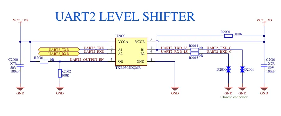

GPIO

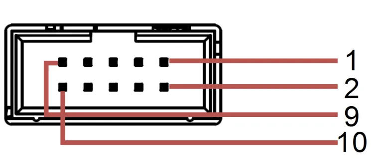

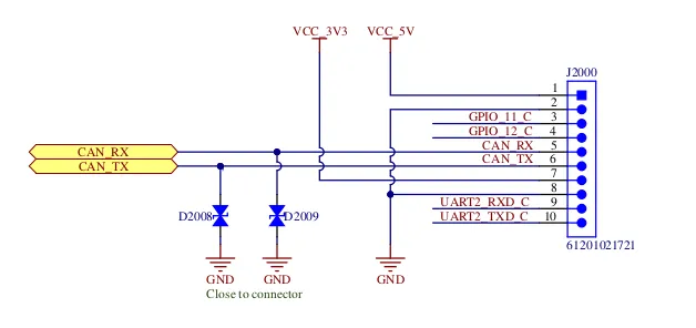

Pinout GPIO
  • #01 - VCC_5V
  • #02 - GND
  • #03 - GPIO_11 [CMOS-3.3V]
  • #04 - GPIO_12 [CMOS-3.3V]
  • #05 - CAN_RX [CMOS-3.3V]
  • #06 - CAN_TX [CMOS-3.3V]
  • #07 - VCC_3V3
  • #08 - GND
  • #09 - UART_RXD [CMOS-3.3V]
  • #10 - UART_TXD [CMOS-3.3V]

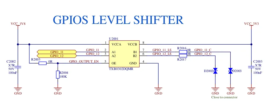

  1. The UART pins on this connector are 3.3V compliant.
  2. The GPIO pins on this connector are 3.3V compliant.
  3. The CAN pins on this connector are directly connected to the Jetson™ module and are CMOS-3.3V compliant. Please ensure to use a dedicated CAN transceiver on this end of the system before using this connection as a CAN BUS. NVIDIA® recommends using the Waveshare SN65HVD230, featuring the TI SN65HVD230 CAN transceiver.
Using electrical signals that do not conform to the specifications may cause significant damage to the device, which is not covered by the warranty.
UART2 level shifterGPIO level shifterCAN pins
UART2 Level ShifterGPIO Level ShifterCAN Pins
Using GPIO_11 and GPIO_12
Please refer to the dedicated documentation page: Using the GPIOs on your ZED Box Mini.

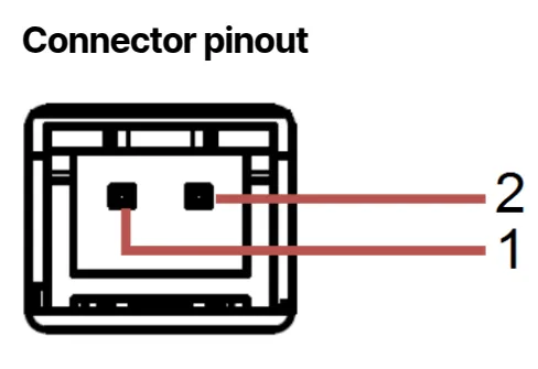

FAN
The ZED Box Mini includes a dedicated 12V-compatible fan connector to support active cooling solutions.
The fan with a mounting plate is also available for purchase on our website, recommended for high-power workloads on the selected NVIDIA® Jetson™ module. See Power Modes to tune the power consumption of the module.
The fan is mandatory in the MAXN SUPER power mode, available on the Rev. 2 boards.
Pinout FAN
  • #01 - FAN_12V
  • #02 - GND
If using a third-party fan, ensure it operates at 12V and does not exceed 500mA of current draw. Exceeding this limit will trigger the PTC (Positive Temperature Coefficient) fuse on the carrier board, interrupting power delivery and preventing fan operation.
The connector is a JST 2-pin connector (2.50 mm pitch) that mates with XHP-2.

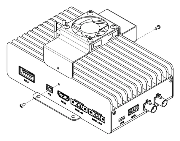

Mount the fan so that it blows air down onto the heatsink fins, with the intake facing up, away from the case.

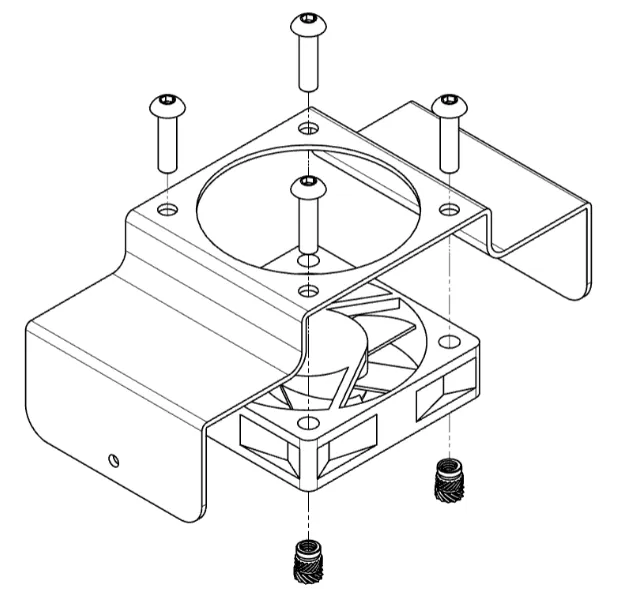

  1. Place the fan under the fan support and fix it with the four M3 screws and the four nuts. Orient the fan so that it blows air down onto the heatsink fins: the intake side faces up, toward the support grille, and the label side faces the heatsink.
  2. Place the support on the ZED Box Mini and fix it on the sides using the two screws.
  3. Connect the fan connector to the fan port.
HDMI
The ZED Box Mini features an HDMI type-A connector, HDMI 1.4 compliant with Orin Nano modules and HDMI 2.1 compliant with Orin NX modules. With HDMI 2.1, it can display video with a maximum resolution of 3840×2160 @60Hz.

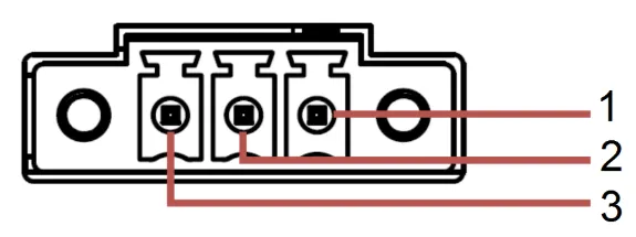

SYNC-IN
The synchronization-input connector is used as a frame-sync trigger input to synchronize image acquisition on multiple GMSL2 cameras connected to different ZED Box Minis.
The connector is a Same Sky (formerly CUI Devices) 3-pin Terminal Block connector that mates with TBP02P1W-381-03BE.
Pinout SYNC-IN
  • #01 - TRIG_INFO
  • #02 - GND
  • #03 - TRIG_IN

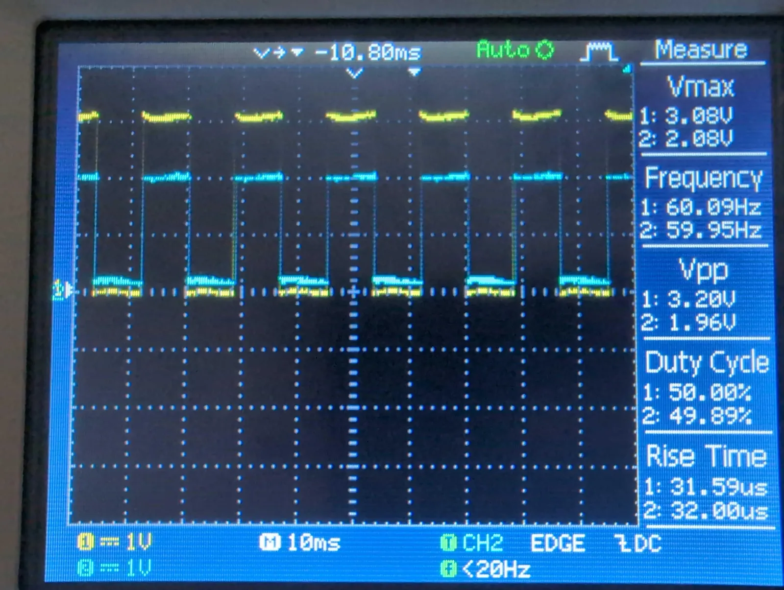

You must use an external trigger signal with the following characteristics:
  • Square wave
  • Amplitude: 3.3V +/- 10%
  • Frequency: Match the camera grab frame rate setting used with the ZED SDK - 15Hz, 30Hz, 60Hz, or 120Hz
GMSL2 sync input signal

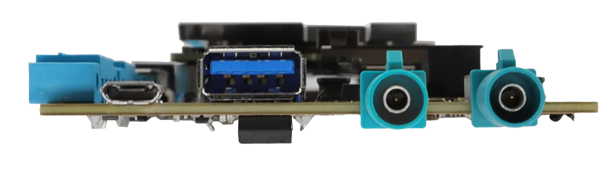

GMSL2
The ZED Box Mini and the Mini Carrier Board offer two separate FAKRA connectors for GMSL2. Each GMSL2 camera is connected to the box through a single coaxial cable, available in different lengths on our store. Using GMSL2 (Gigabit Multimedia Serial Link) connections, the cameras connect to a two-port deserializer, the MAX9296A, which converts the video stream to MIPI CSI-2 and transmits it to the chosen Jetson™.
Supported GMSL2 camera combinations
It is possible to connect only one camera to each single GMSL2 port.

USB 3.0
A USB 3.0 Type-A connector supports up to 5Gbps data rate. It is compliant with the requirements of Super Speed (SS), High Speed (HS), Full Speed (FS), and Low Speed (LS).
For additional information regarding the pinout, please refer to the USB Type-A standard.
Micro-USB 2.0 - OTG
The ZED Box Mini features a Micro USB 2.0 Type-B that can be used for OTG functions or paired with the Recovery button to flash a new image on the device. In non-recovery mode, this OTG port provides a serial output that can be used to monitor and access the device through a serial console.
For additional information regarding the pinout, please refer to the Micro USB 2.0 Type-B standard.

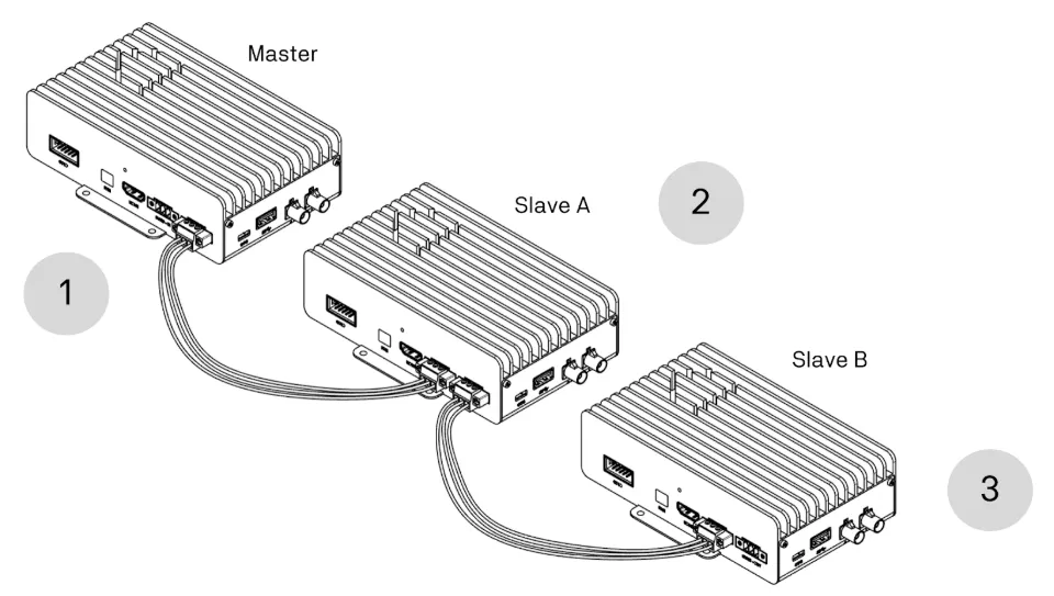

Multi-device synchronization
The ZED Box Mini enables precise camera synchronization across multiple units via GMSL interfaces, ensuring accurate data alignment for large-scale deployments. This capability is essential for intelligent systems requiring synchronized multi-camera vision, such as smart infrastructure, entertainment venues, and logistics applications.
Three-Device Synchronization Example
  1. The Master device generates and transmits a clock signal to trigger frame acquisition for its connected GMSL2 cameras.
  2. Slave A receives the Master clock signal and triggers frame acquisition for its connected GMSL2 cameras, then forwards the signal to Slave B.
  3. Slave B receives the Master clock signal through Slave A and triggers frame acquisition for its connected GMSL2 cameras.
Additional ZED Box Mini units can be daisy-chained in the same manner, propagating the Master clock signal across multiple devices in real time.
Multi-device synchronization is only available for GMSL2 cameras. USB 3 cameras do not support this feature.
