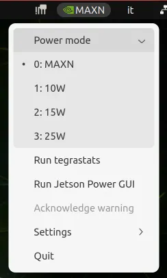

From the Ubuntu desktop
  1. Click the NVIDIA icon in the top bar. The current power mode is displayed next to it.
  2. Open the Power mode submenu and click the mode you want to set. The modes listed depend on your Jetson module.
    Power mode menu of the nvpmodel GUI

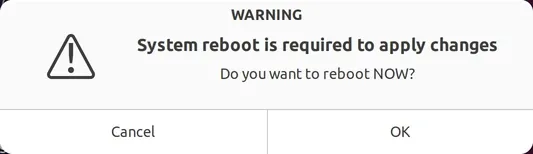

  3. If the new mode requires a reboot, a dialog asks for confirmation. Click OK to reboot and apply the new mode.
    Reboot confirmation dialog

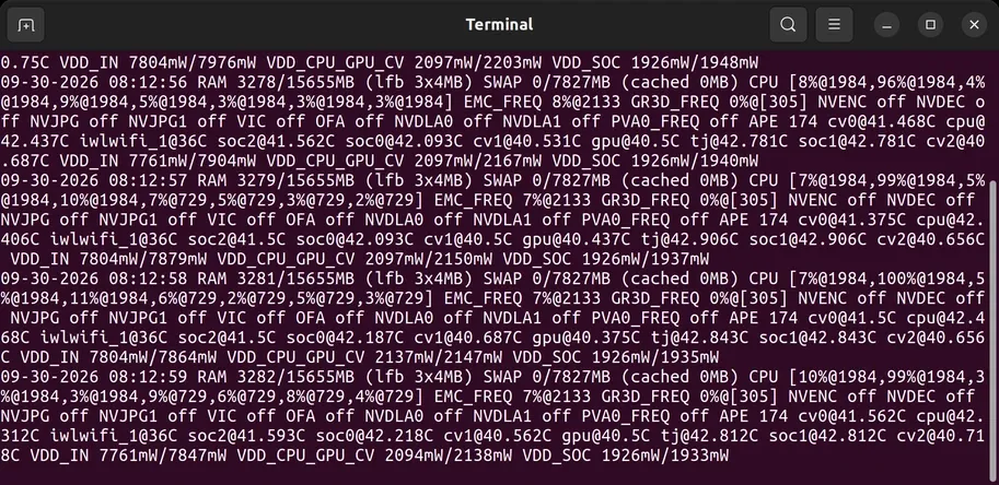

tegrastats
tegrastats is installed with JetPack. It reports the CPU and GPU load and frequencies, the memory usage, the temperatures, and the power consumption of the module rails:
sudo tegrastats --interval 1000
tegrastats output
To log the statistics in the background, for example during a long test:
sudo tegrastats --interval 1000 --logfile ~/tegrastats.log &
Stop the background logging with sudo tegrastats --stop.

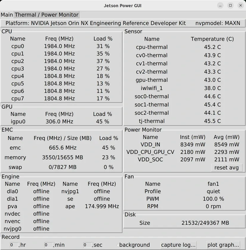

The Jetson Power GUI is installed with JetPack. It displays the CPU, GPU, and memory frequencies and loads, the readings of the temperature sensors, and the instantaneous and average power of each monitored rail.
To start it, click the NVIDIA icon in the top bar, then Run Jetson Power GUI.
Jetson Power GUI main tab

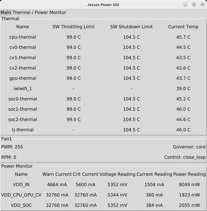

The Thermal / Power Monitor tab shows the throttling and shutdown limits of each temperature sensor, and the voltage, current, and power of each monitored rail:
Jetson Power GUI Thermal / Power Monitor tab
The Record section at the bottom of the Main tab captures a log over a given duration, and plot graph… plots the recorded or real-time data. This helps you compare the power consumption of your application in different power modes.

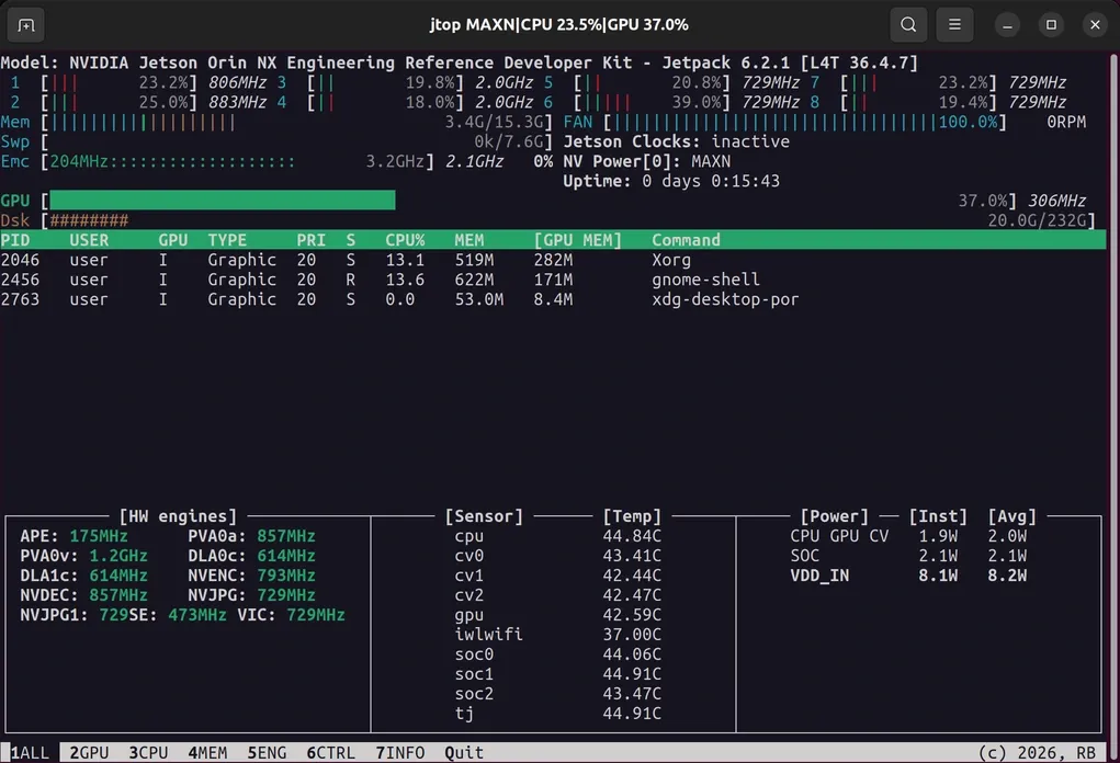

jtop
jtop, from the community jetson-stats package, is an interactive terminal monitor that also lets you change the power mode and toggle jetson_clocks:
sudo apt update
sudo apt install python3-pip
sudo pip3 install -U jetson-stats
sudo jtop --install-service
The last command installs and starts the jtop service, and adds your user to the jtop group. Log out and log in again, or reboot, then run:
jtop
jtop main screen
