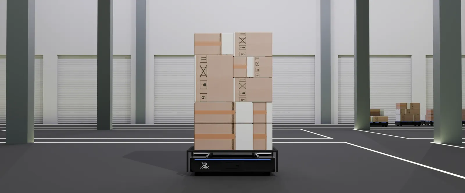

Indoor ground robots and AMRs
Autonomous mobile robot carrying a stack of boxes in a warehouse
Autonomous mobile robots in warehouses, factories, hospitals and retail stores.
  • Camera: ZED X with wide lens, without polarizer. The wide field of view covers obstacles close to the robot and gives many visual features to positional tracking. Choose the ZED X Mini for a small robot, or when the obstacles that matter are closer than 0.3 m.
  • 360° perception: four ZED X, one on each side, on a ZED Box 2 with the Fusion API.
  • One or two cameras: a ZED Box Mini is enough, and runs each camera at full frame rate.
Do not use a polarizer indoors: it blocks half to two thirds of the incoming light, which increases noise and motion blur. With more than two stereo cameras on the same connector of a ZED Box 2, the frame rate is limited to 30 fps in HD1200 (see Frame rate with several cameras).

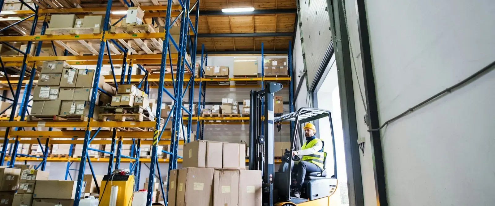

Forklifts
Forklift carrying a pallet in a warehouse
  • Front and rear perception: two ZED X with wide lens.
  • Pallet detection at the forks: a ZED X Mini, whose 0.1 m minimum depth suits the pallet approach, or a ZED X One 4K for high-resolution pallet and label detection.
  • Host: a ZED Box 2, which connects up to eight GMSL2 cameras, with CAN ports to communicate with the truck.
The ZED X One 4K uses a rolling shutter and runs at 15 fps in 4K, so use it for detection when the forklift moves slowly. Check that your camera combination is supported in Using GMSL with ZED Box 2.

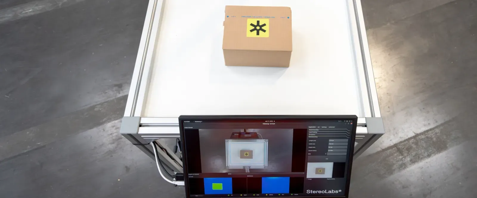

Warehouse vision
Parcel dimensioning station with a ZED camera above a parcel
Parcel counting and dimensioning, occupancy and load monitoring, tracking and code reading in warehouses and distribution centers. As a rule of thumb:
  • Stereo camera (ZED X, ZED X Mini) when the application needs depth: volume, height or position.
  • Monocular camera (ZED X One) when a 2D image is enough: video, barcodes, AprilTags or text.
  • Wide lens for wide coverage at close range, narrow lens for a longer range or a higher ceiling.
  • ZED X One 4K for its HDR, which handles the high contrast at dock doors, and its resolution for codes and text.
ApplicationCameraHost
Parcel countingOne ZED X wide per pallet positionZED Box Mini, Orin NX 8 GB or 16 GB
Occupancy monitoringZED X wide up to 7 m, ZED X narrow from 7 m to 15 mZED Box Mini, Orin NX 8 GB, for two cameras
Load monitoringZED X + ZED X One 4KZED Box Mini, Orin NX 16 GB
Parcel dimensioningZED X Mini narrow + ZED X One 4KZED Box Mini, Orin NX 8 GB
Pallet dimensioningTwo ZED X narrow, optionally + ZED X One 4KZED Box 2, Orin NX 16 GB
Video trackingOne or two ZED X One GS wide, or ZED X One 4KZED Box Mini, Orin NX 8 GB
Barcode, AprilTag and OCRZED X One GS narrow, or ZED X One 4KZED Box Mini, Orin NX 8 GB
Drop-off validationOne or two ZED X wideZED Box Mini, Orin NX 8 GB
Dark, shiny and wrapped parcels, as well as stretch film, reduce the depth quality. Add diffuse lighting, and check the depth accuracy of the ZED X at your mounting distance.
