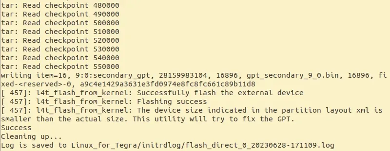

  6. Wait for the operation to complete. You will see the following output if the flash is successful:
If you encounter any problems during this procedure, please consult the troubleshooting guide.

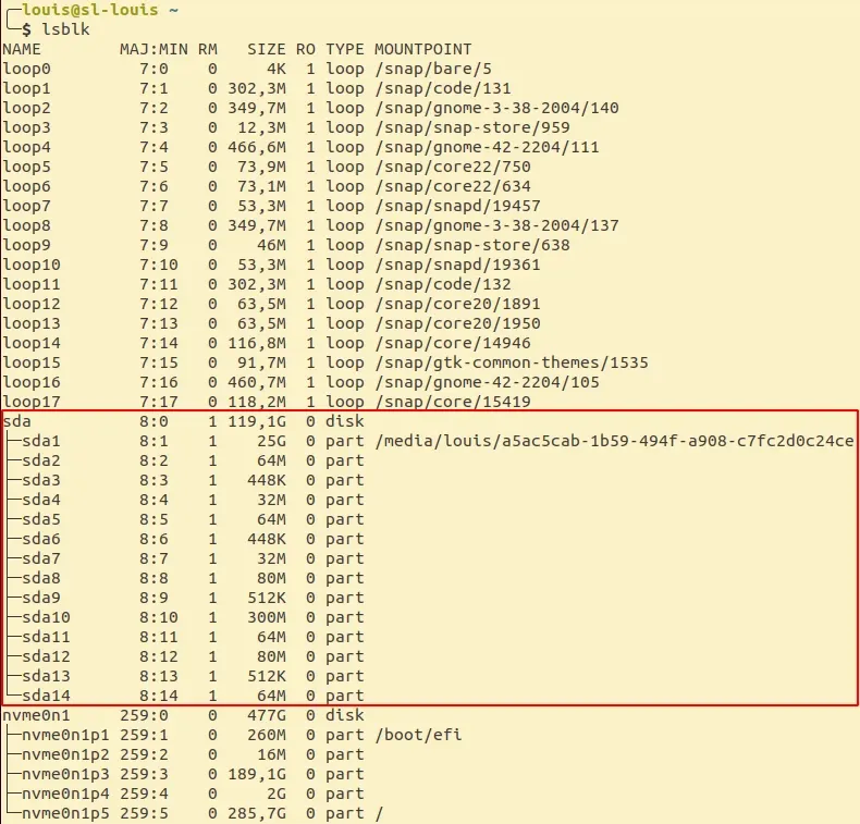

  • Use lsblk to identify the USB disk you want to flash. In the caption below, we can identify that the USB disk ID is sda:
    Please be careful and use the name of the drive and not the name of a partition. For instance, use sda instead of sda1.

  • Upon success, you will read the following message:
  • The USB drive is now flashed. You will have to run almost the same command to flash the ZED Box later.
You can use the same BSP_ROOT directory to flash your ZED Box once it is in recovery mode. This allows you to skip the download and unpack sections of the script.
