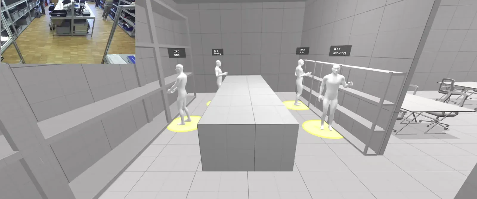

Digital twins
Digital twin of an office, with people tracked in 3D and the live camera view inset
3D models of rooms, buildings and sites, kept up to date with live data: occupancy, motion tracking, safety zones and traffic flows.
  • Permanent multi-camera installations: ZED X on a ZED Box 2, or on a ZED Box 2 Max to process more cameras on a single host. GMSL2 carries video and power on a single coaxial cable over long distances, without the USB extenders that often make permanent USB installations unstable, and synchronizes the cameras at the hardware level.
  • Small or temporary setups: ZED 2i on a PC or a ZED Box Mini.
  • Lens: wide to cover the room; narrow for the cameras that must see the far end of a large hall.
  • 3D model: use Spatial Mapping to scan the environment, and the Fusion API to combine the live data of several cameras.
The GPU is usually the bottleneck of multi-camera systems. When one Jetson cannot process all the cameras at the required frame rate, distribute them across several hosts.
