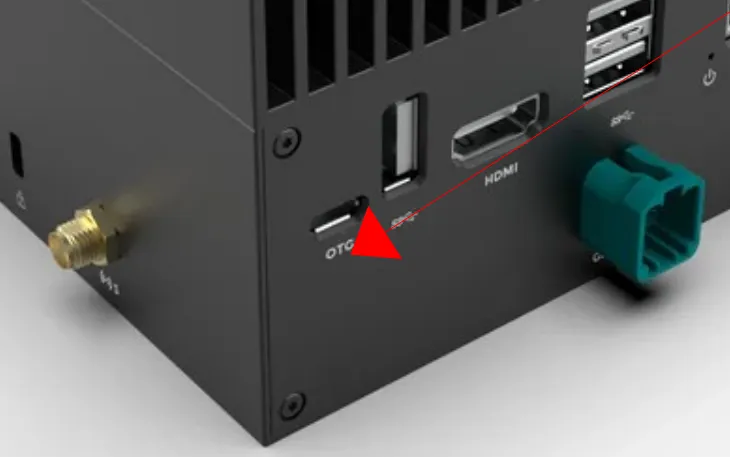

The ZED Box provides a Serial Console interface for low-level access to the system, via the Micro USB2.0 Type-B port. This is useful when no display is connected to the HDMI port.

  • Connect a Micro USB cable from your host computer to the Micro USB2.0 - OTG port.
    Do not connect the cable before the device is powered on, otherwise the ZED Box will boot in Recovery Mode.
