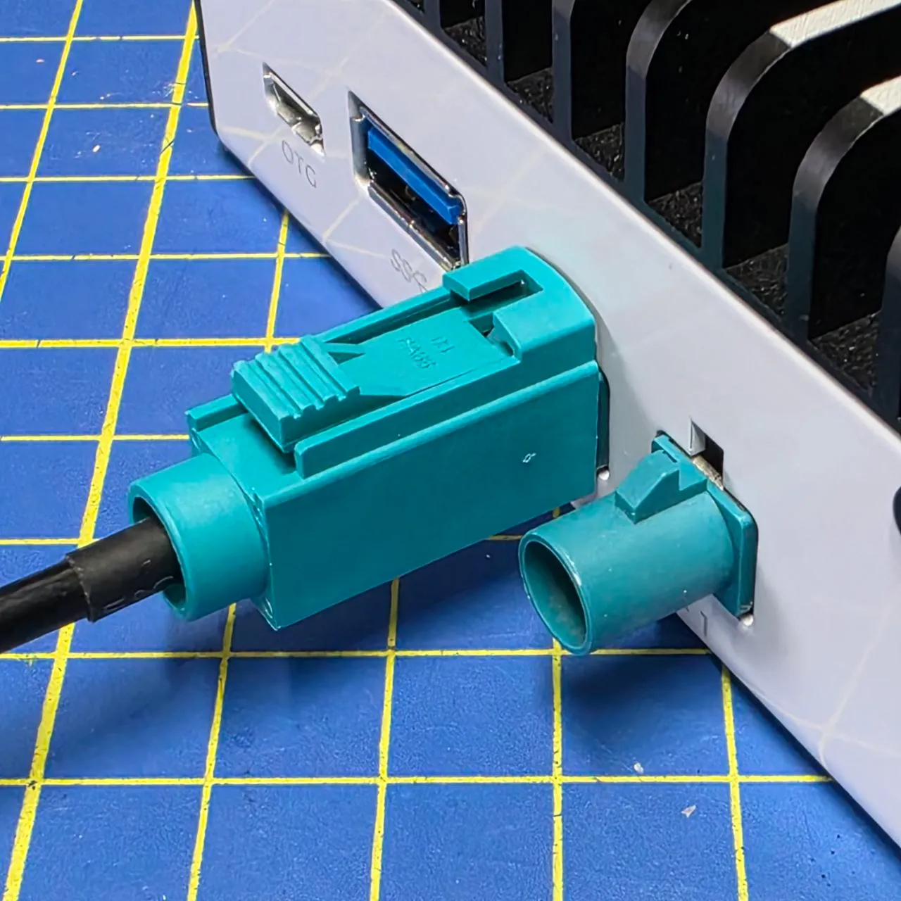

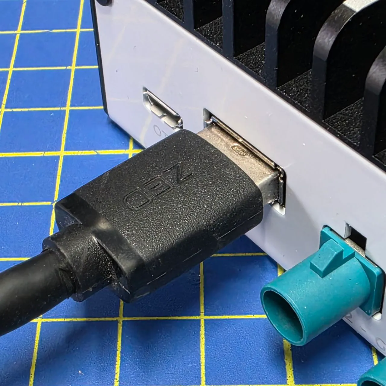

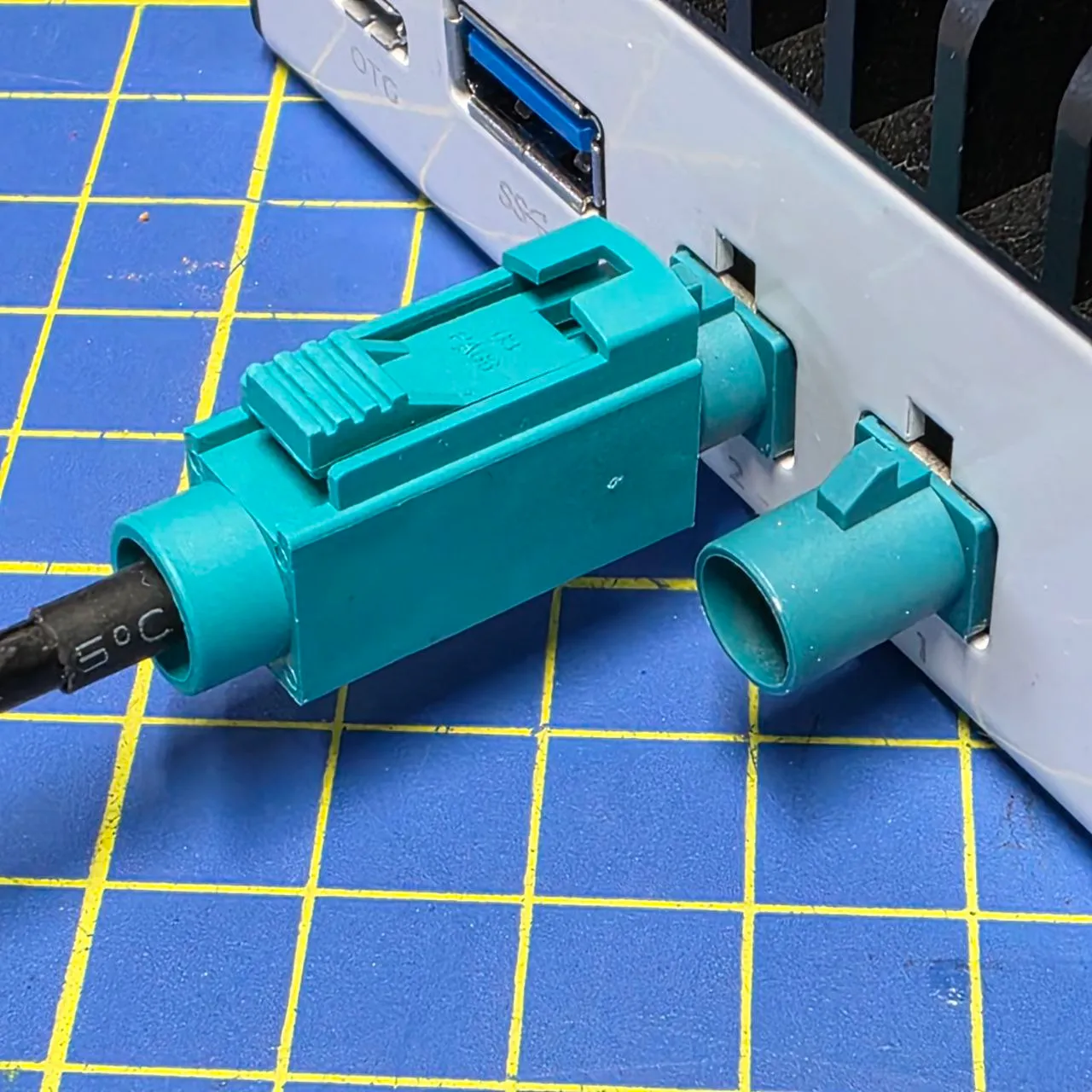

Connect a ZED GMSL2 camera
Firmly push the Fakra connector in until you hear a “click,” ensuring a secure and reliable connection.
Fakra connector outside view Fakra connector inside view
GMSL2 cameras are not plug-and-play. Connect them before powering on the ZED Box Mini to ensure the operating system detects and initializes them properly.

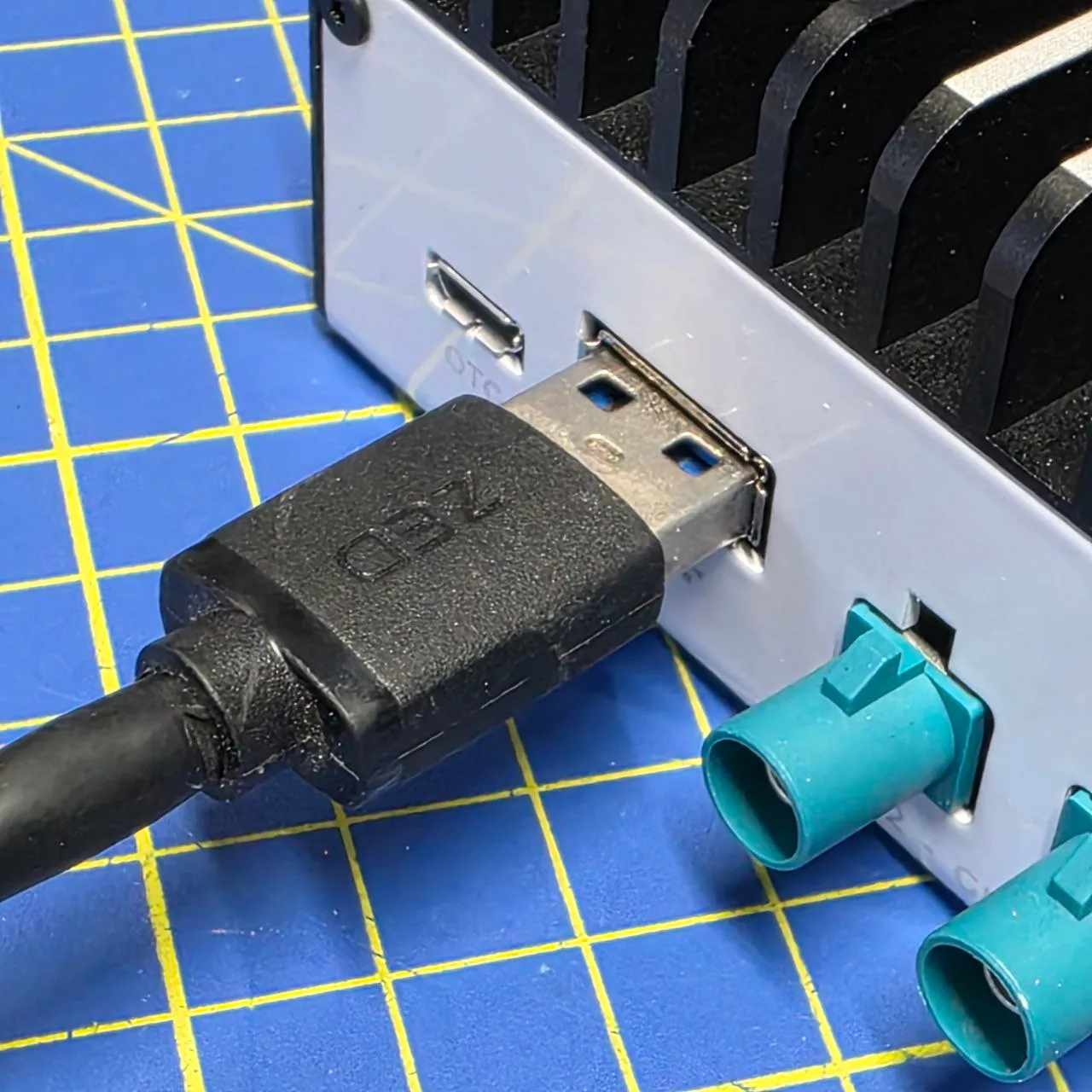

Connect a ZED USB 3 camera
USB camera outside view USB camera inside view
USB 3 cameras are plug-and-play. You can connect them at any time, even after the ZED Box Mini has booted.

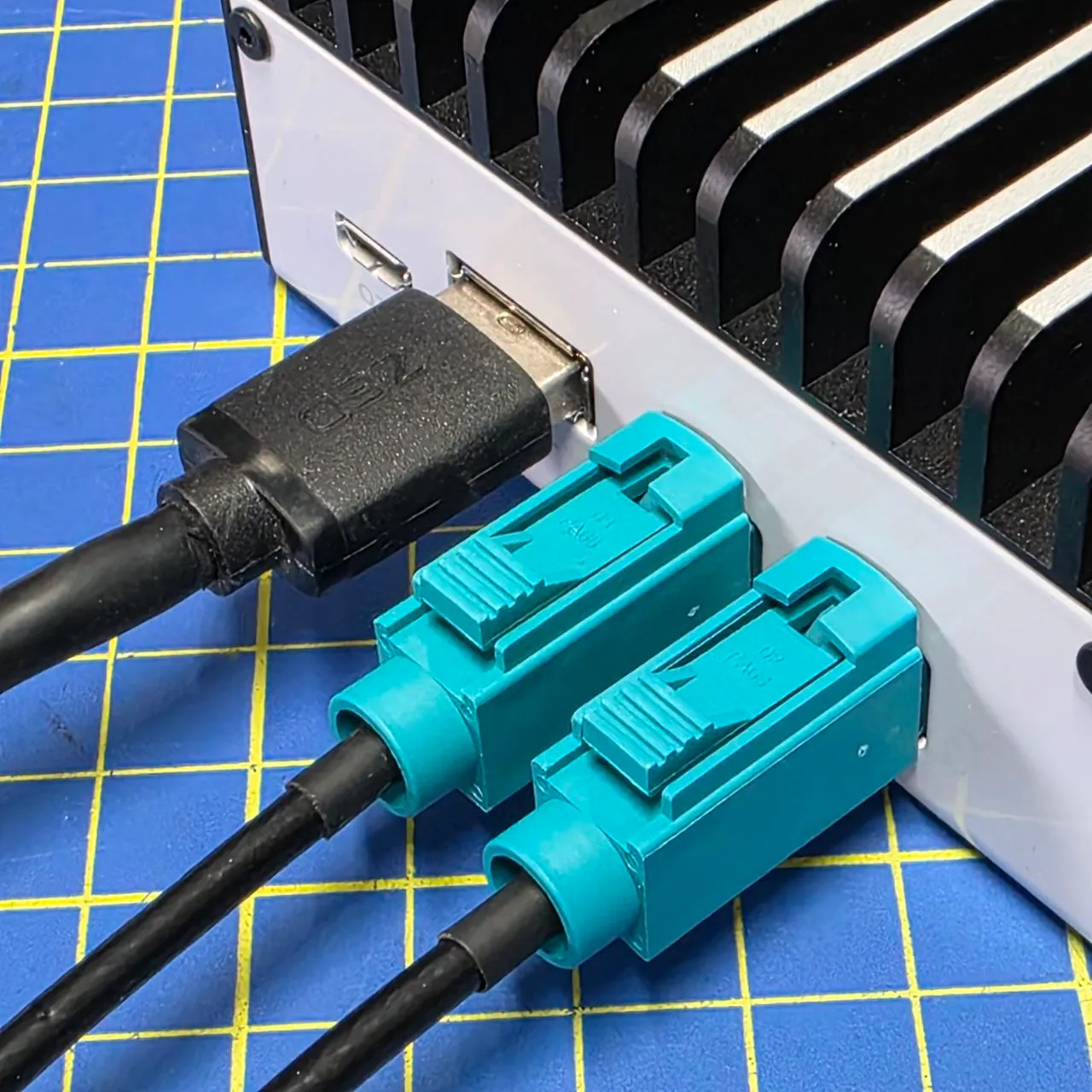

Hybrid camera setup
You can connect up to three different ZED cameras to the ZED Box Mini:
  • 1x USB 3 ZED Stereo Camera
  • 2x GMSL2 Cameras (only one ZED X One 4K, see the warning above)
Three cameras setup

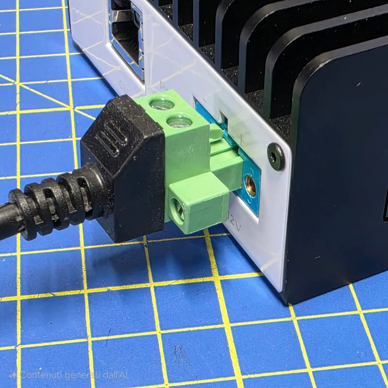

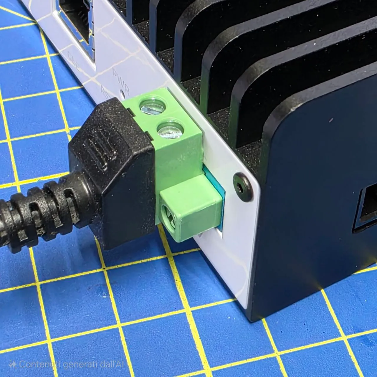

02. Power the ZED Box Mini
Power connector outside view Power connector inside view
Connect the provided power supply to the power connector. The device will automatically turn on.

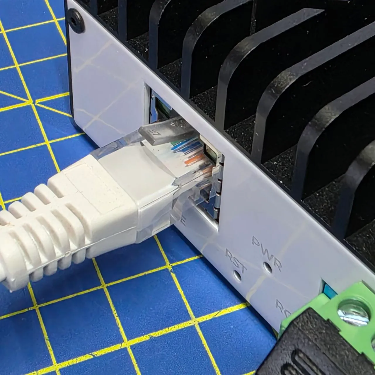

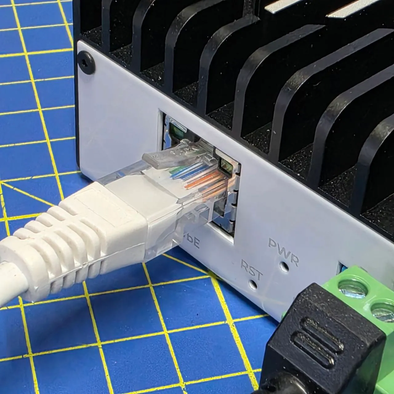

03. Connect to the network
LAN connector outside view LAN connector inside view
Connect to your network using the Ethernet port.

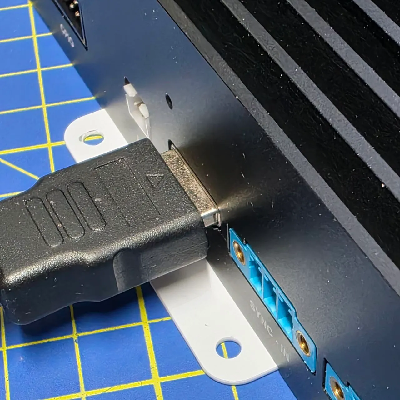

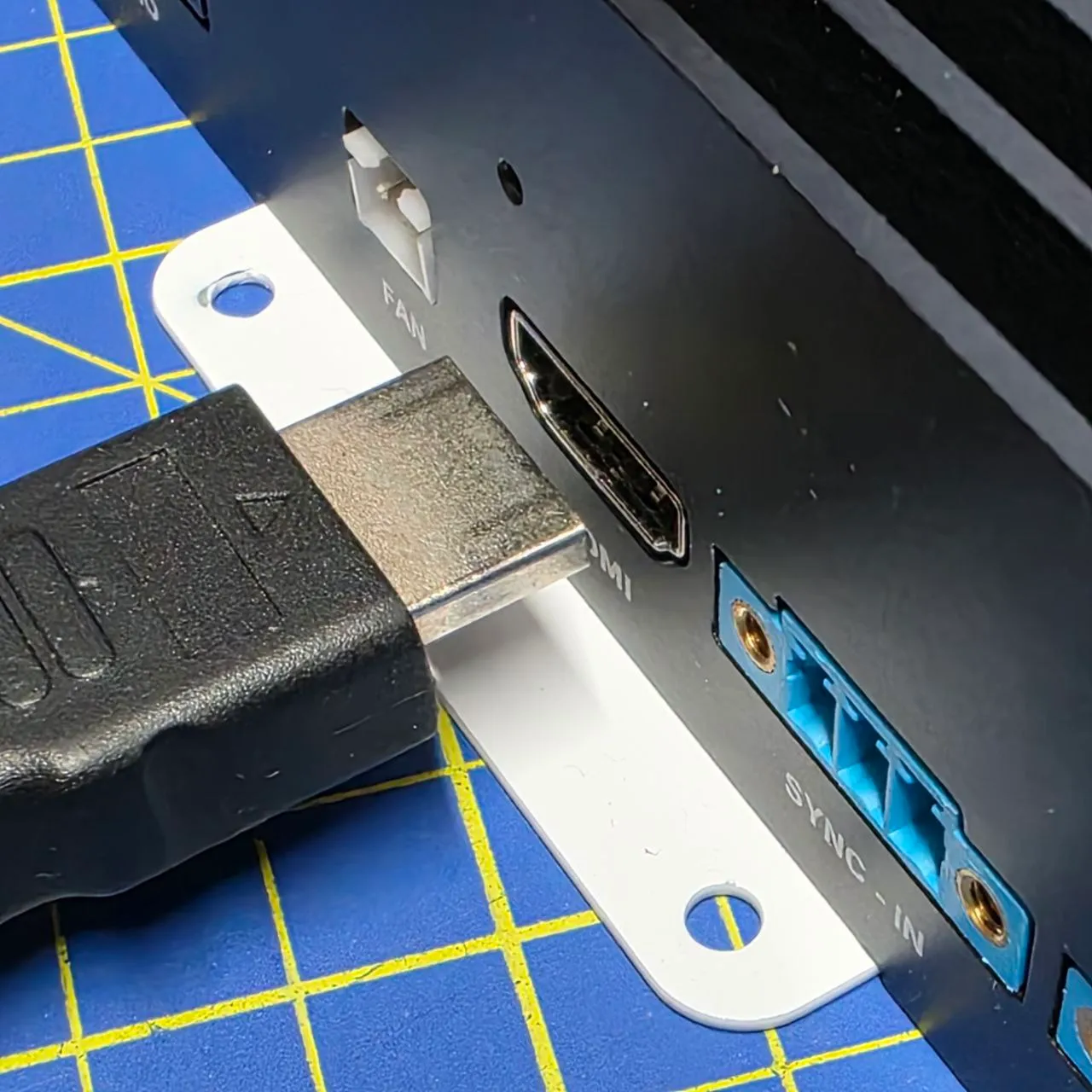

04. Connect a display or a Dummy HDMI plug
Display
HDMI connector outside view HDMI connector inside view
The ZED Box Mini features an HDMI type-A connector, HDMI 1.4 compliant with Orin Nano modules and HDMI 2.1 compliant with Orin NX modules. With HDMI 2.1, it can display video with a maximum resolution of 3840×2160 @60Hz.

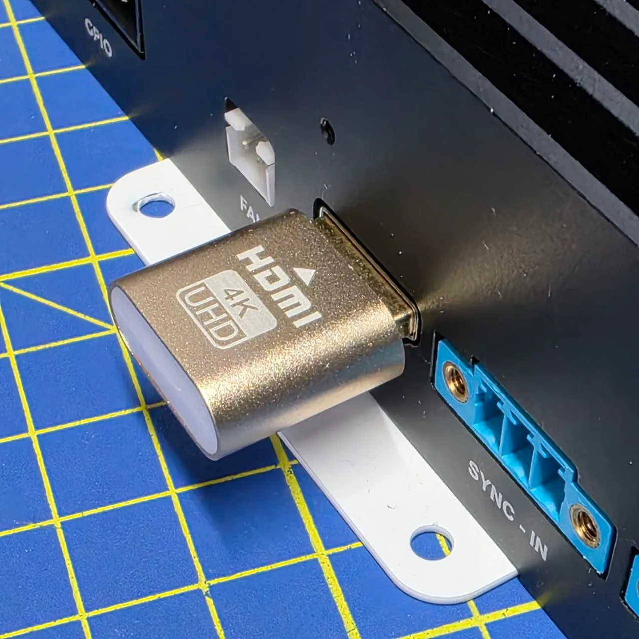

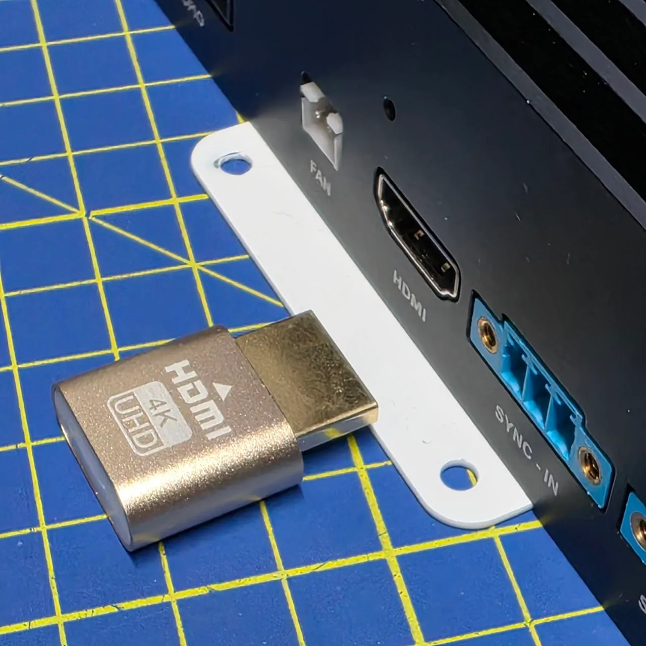

Dummy HDMI plug
You can use the ZED Box Mini without a display in headless mode, controlling it remotely by using ssh or virtual desktop applications. To enable X11 forwarding and run applications requiring OpenGL in headless mode, it is required to use a Dummy HDMI plug to simulate a connected display. Learn more here.
HDMI dummy plug outside view HDMI dummy plug inside view
