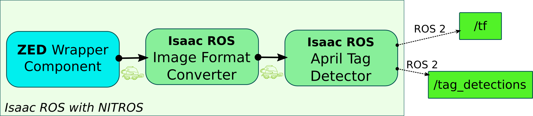

The application will subscribe to the ZED camera’s image stream, convert the ZED images to a supported format, and finally process the images to detect AprilTags, and publish the detected tags’ information.
The example leverages the NITROS communication framework for efficient data exchange between the ZED camera and the AprilTag detection module through the GPU memory without unnecessary data copies on CPU.
It is not required to rectify the images for AprilTag detection, because the ZED Wrapper component handles any necessary image preprocessing in the GPU memory through the ZED SDK.

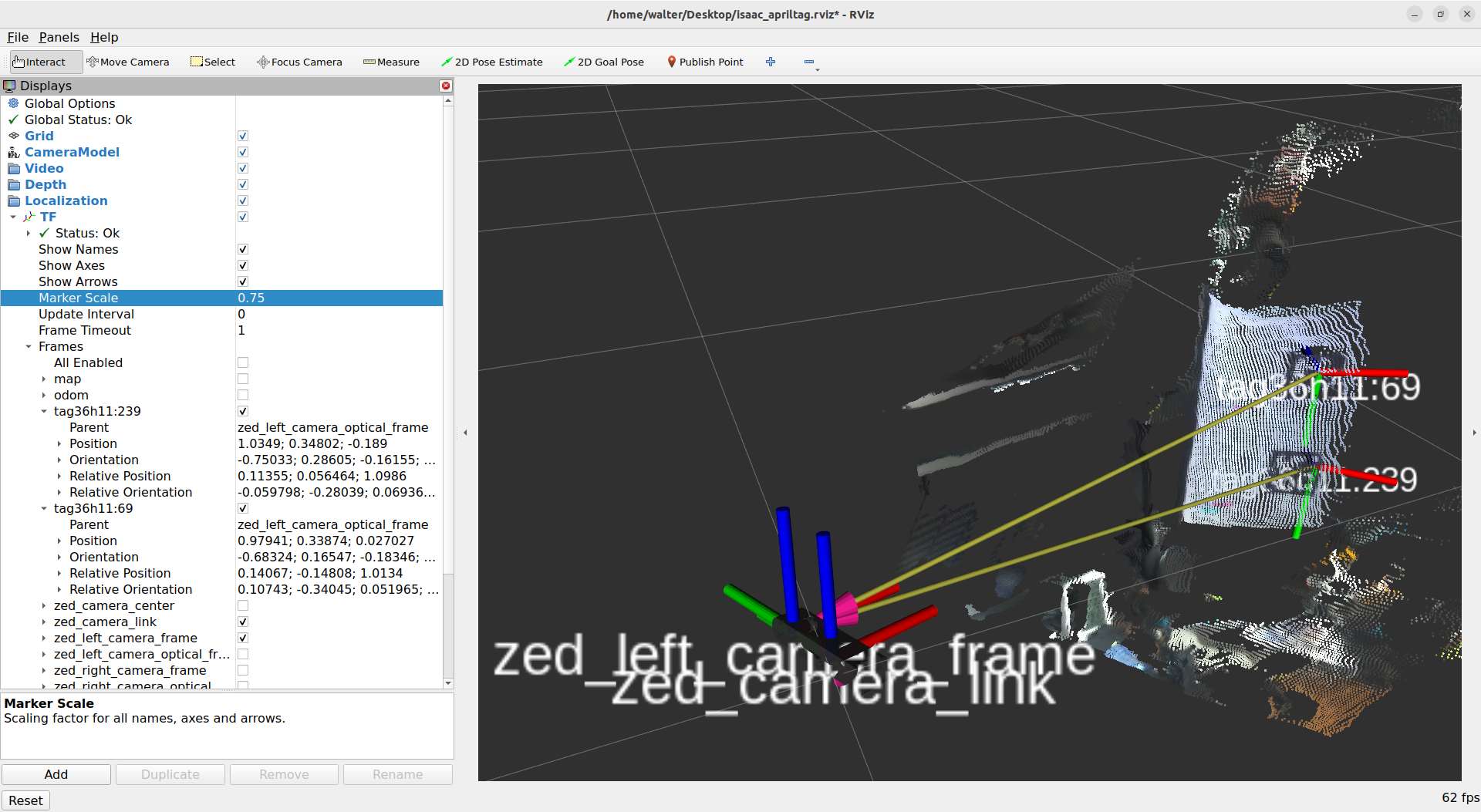

Point the camera to an AprilTag target and observe the AprilTag detection output /tag_detections on a separate terminal with the command:
ros2 topic echo /tag_detections

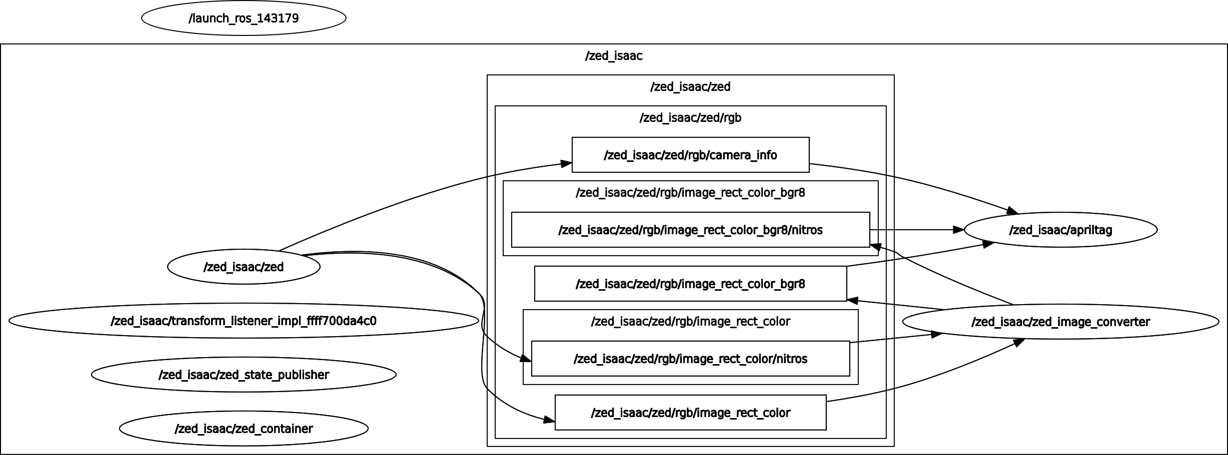

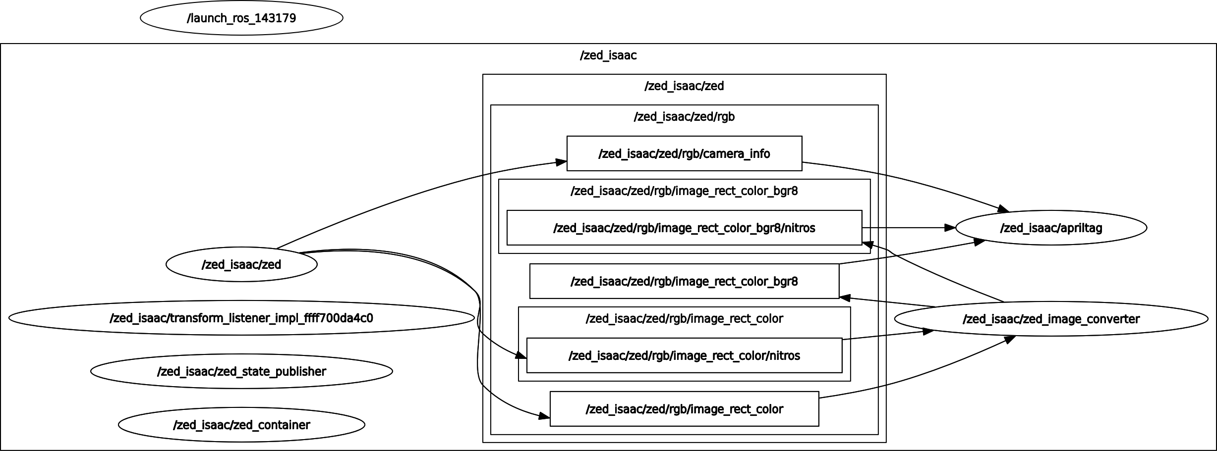

You can visualize the full ROS 2 topic graph with:
ros2 run rqt_graph rqt_graph
